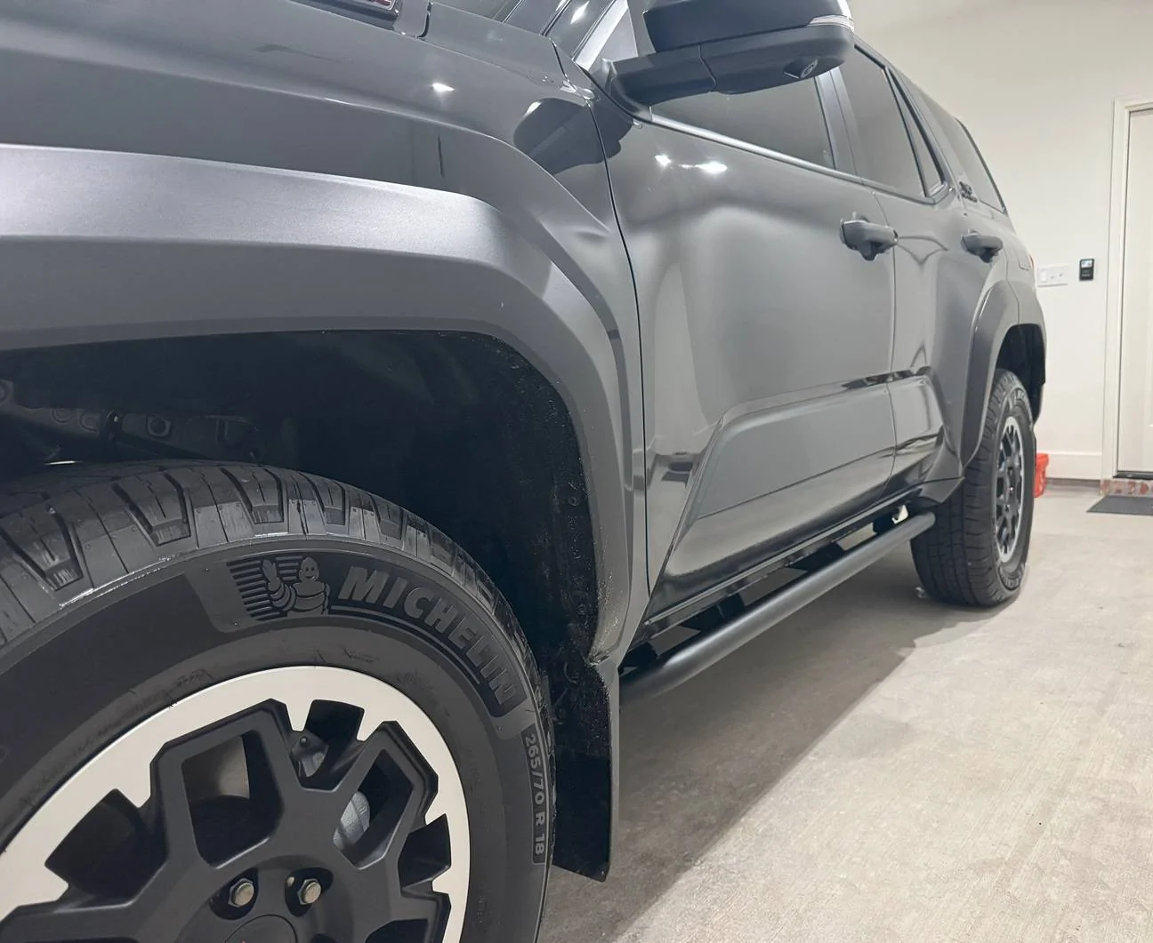

Anyone successfully install the OEM Trailhunter Rocksliders on another trim? Specifically a TRD ORP Hybrid.
I ordered the two parts from my dealer PT228-89251 and PT228-89252. It came with the installation hardware in the box. There are 8 10MM bolts per side.
I went to line them up on the frame, and I can clearly see what hole the bolt is supposed to go in, but on my frame there are no threads for said holes.
The dealership is just as perplexed. The internal toyota documentation shows that they should be there. The only thing you need to do is bolt them to the frame, but I can't.
I'm really wondering if Toyota only welds the threads on the Trailhunter and leaves the holes blank on the rest of the other trims.
Again, anyone have success with this mod? Thanks in advance!
___________________________________________________________________
Update:
I was finally able to get the OEM Rock Sliders installed on a TRD ORP Hybrid.
Here's what I did...
There's 16 total mount points needed to install these.
The very front two mounts (LH/RH) nearest to the front of the vehicle, did have the correct threads. I was able to bolt the supplied 10mm hardware in these two holes. These mount underneath the frame next to the front tires. (4 done)
The remaining 12 holes were all unfilled with any usable threads whatsoever. These are on the sides of the frame. As others have noted in the thread, there are some scattered threaded holes in the frame, but none of these lined up with what I needed to mount in my case.
I bought a rivet nut tool ($40-60) off amazon. I'd recommend getting one that is right angle as there are some really tight spaces way up underneath the frame and body that you'll have to install the rivet nut. The long handle ones just can't reach up under there. You won't have the clearance.
I went with 8MM Rivet nuts as I already had some 8MM bolts and washers from taking off the factory OEM running boards. I tried to use as many toyota parts as possible. But you'll need 12 8MM bolts and washers if you don't already have them.
I originally wanted 10MM as the factory rock slider comes with that size bolt, but the holes I needed to plug would not accept a 10MM rivet nut. I guess you could always drill it out some if that was your preference.
8MM just worked much easier for me.
Install the rivet nut in the holes that you need to plug and bolt them on. It seems to be holding very well. I stood on each rock slider and jumped up and down and didn't feel any movement of the sliders. Time will tell how well it holds up I guess.
