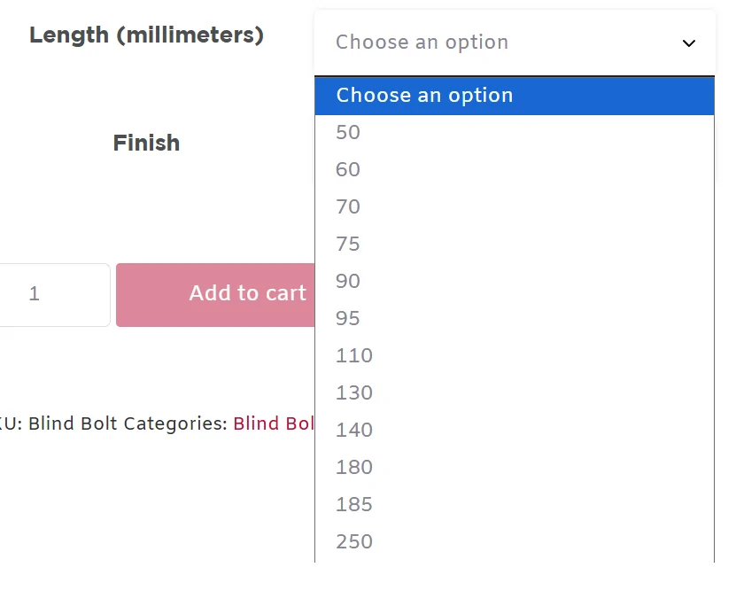

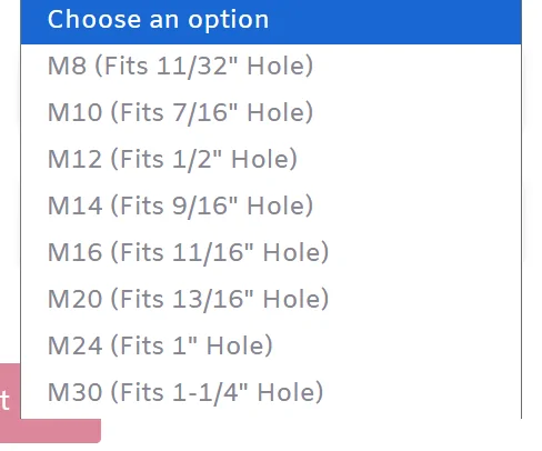

Regarding the CBI rails and the TRD OR. Getting the bolts through the warranty is the way to go. However, they were slow to respond and I got impatient, so I contacted ATC Specialty Products regarding there box bolts. The unthreaded holes measure 1/2”. They recommended 5/16” box bolt and said the holes needs to be drilled to 9/16”.
I have not received them yet. I’ll post how it works out.
https://atcspecialty.com/product/5-16-boxbolt-2/
Did u end up drilling the hole bigger or did just fit right in.

What diameter and length blind bolts did you go with? Quantity of 12? I am bolting the OEM sliders onto my TRD OR as well.
my best guess would be m8. I used m8 rivet nuts to plug the holes in the frame. The bolts i used were about 1 1/2 in long.
another poster used the 5/16 blind bolt and thats close to 8mm
