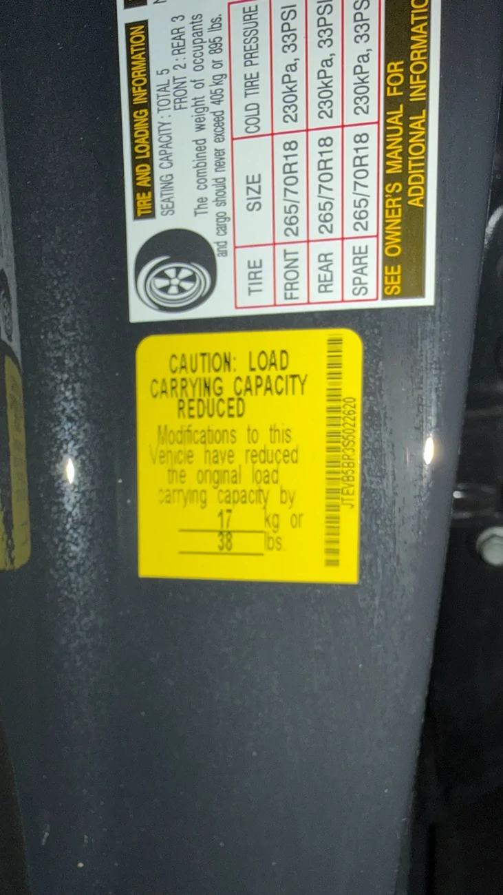

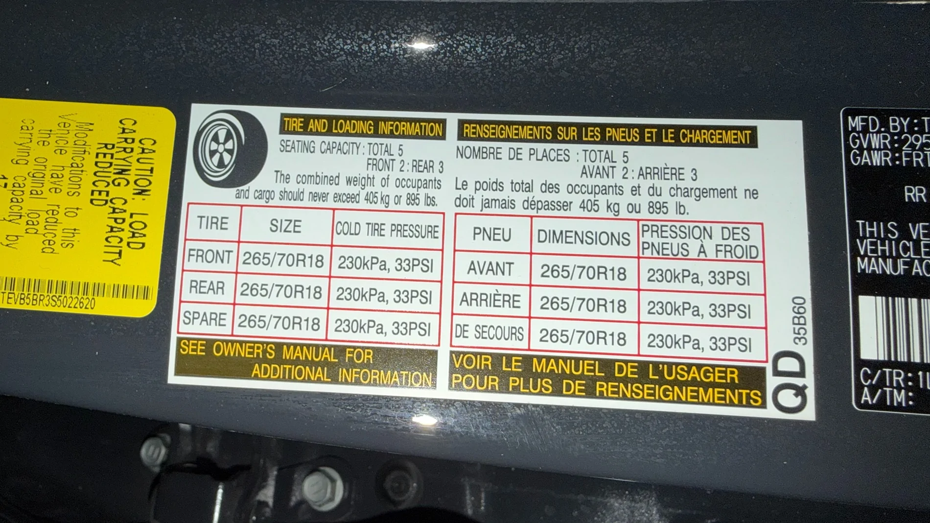

Your confusion is warranted. My Pro says 895lb payload capacity on the door sticker. The GVWR is listed as 6505 lbs. The curb weight is apparently 5455lbs based on searching but is not listed on the door sticker (which would give your 1050 payload). I'd go by the listed payload of 895lb but note that lots of overlanders go beyond payload seemingly without problems. Interestingly I saw in a video that in Australia, they officially increase payload by changing to a stronger suspension (mainly springs) which the Pro has but Toyota pretty much uses the same GVWR across models, probably based on the frame strength and brake size but I don't really know how they do it. My guess is that the payload capacity is a bit conservative by Toyota so +/- 100 lbs is in the noise.

I found a video confirming the payload at 895 lbs for the 2026 TRD Pro. Honestly, that’s pretty depressing. I was really set on getting one, but that number makes it a hard pass for me—and I have to imagine for a lot of other people too. My daily sedan actually has more payload than that. Pretty bummed about it. Have to think Toyota is going to offer the Pro without the hybrid or address this issue quickly. I’ll have to go 5th gen or wait it out.

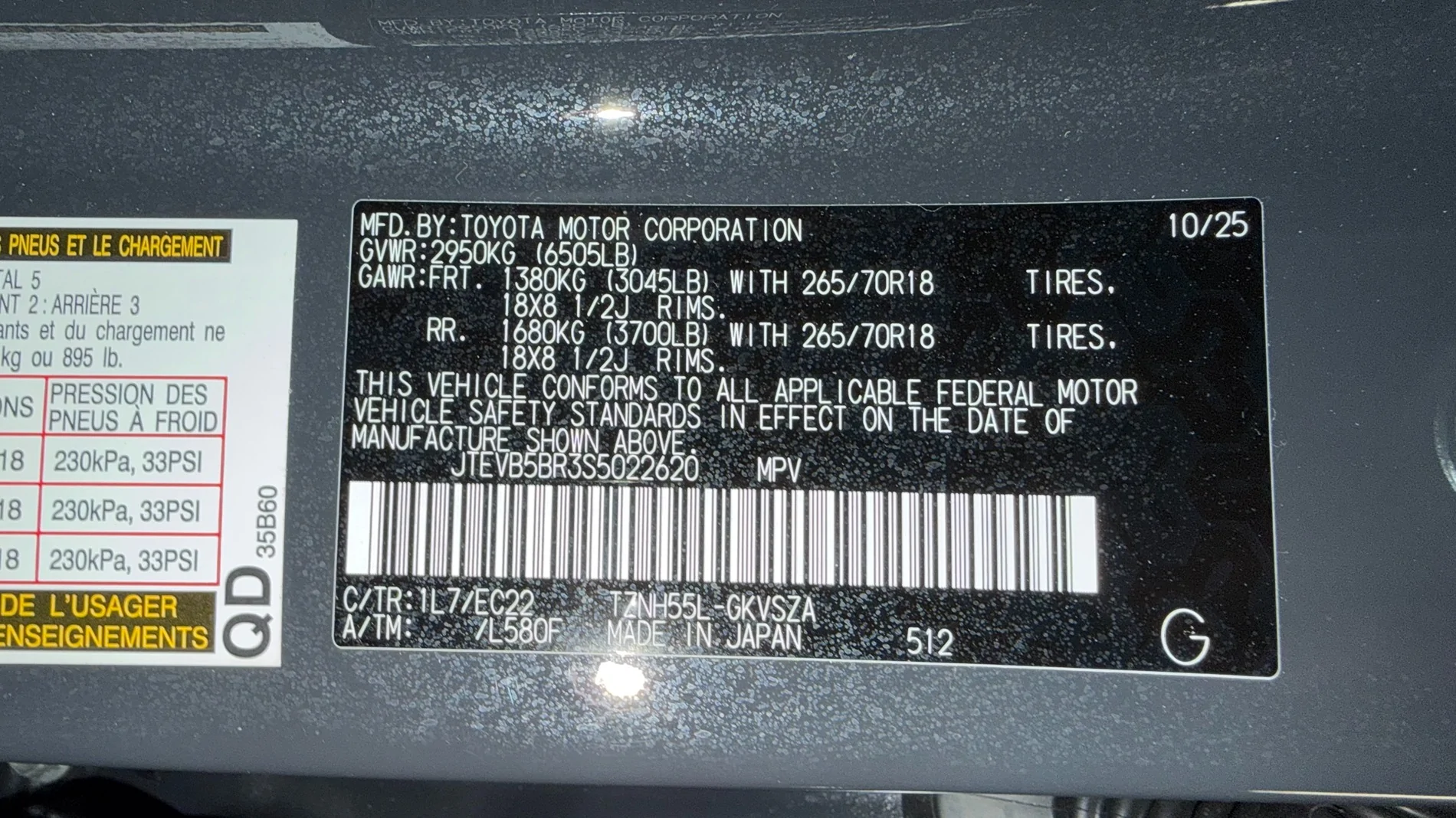

Let’s walk through the actual numbers for the 2026 Toyota 4Runner TRD Pro, because they reveal why the payload rating looks so low—and why the true mechanical capacity is likely higher than the sticker.
1. The Hard Numbers (TRD Pro)
From available specs:
  • Curb weight: ~5,455 lb
  • GVWR: ~6,505 lb
Payload is calculated as:
Payload = GVWR − curb weight
So:
6,505 − 5,455 = ~1,050 lb
Yet many listings report about ~895 lb payload .
Why the difference?
Because the official payload rating subtracts additional assumptions, like:
  • full fuel
  • optional equipment
  • safety margins
  • sometimes a standard driver weight
So the real “engineering headroom” is already ~150–200 lb higher than the published number.
