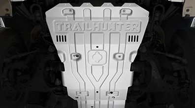

Most people I’ve seen get the TRD Pro or TrailHunter Skid.

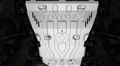

Just to add another choice for you… there is also the Land Cruiser skid plate. It’s basically the same as the Trail hunter skid, but says “TOYOTA” vs “TRAILHUNTER”. These are longer than the TRD option. The LC version is also a lot cheaper than the TH version, even through they are essentially the same.
