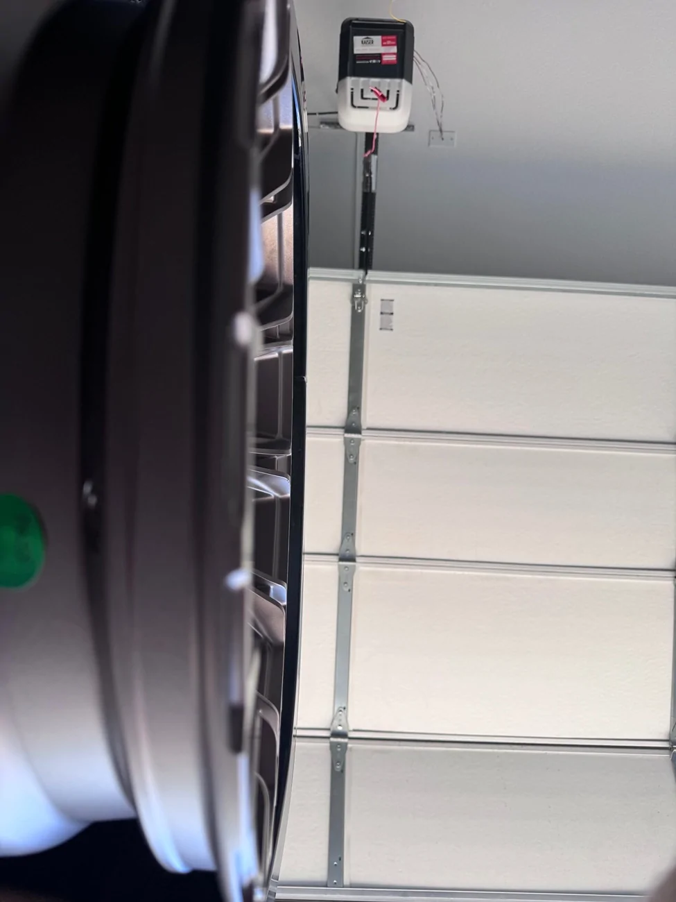

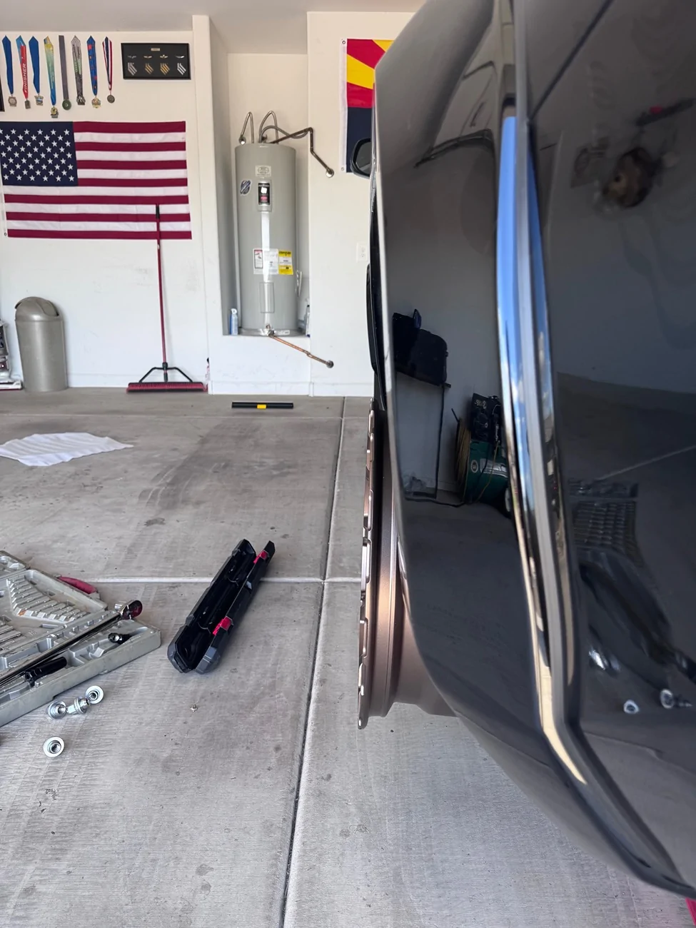

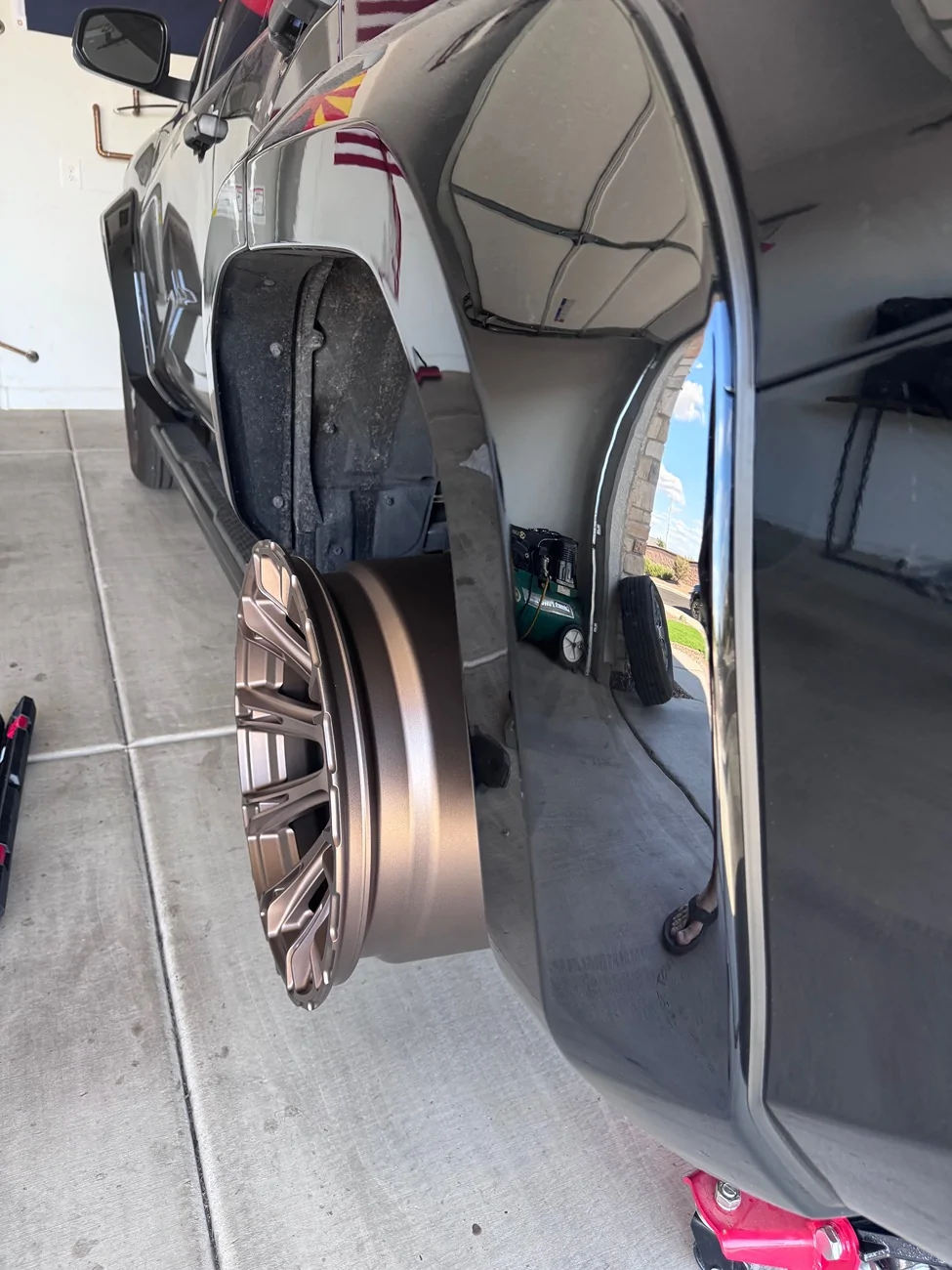

I’m going through this process right now. I ordered some -12 offset wheels because I installed the Rough Country fender flares which are about 2” wider than SR5 stock fender flares and about .75~1” wider than TRD flares. The -12 offset looks like it will be perfectly flush with the new flares so rubbing on trails will probably be an issue with stock suspension. However, it may not be an issue for everyday driving. I’m not sure yet. I’ll be installing the Falken Wildpeak 275/65/r18’s (32.5”) this Saturday with stock suspension so I’ll let you know. After the install I’m going to an off road shop to see what they recommend. Either a 2” leveling kit or a 3”lift. We will see. I’ll include some pics of just the wheels mounted without the tires and update after the tires are installed. The last picture is looking up from the floor, you can barely see the flare hanging over.
I have the same RC flares with 17x8.5 +25 wheels on 285/70/17 AT4W, the fronts are flush but seems like the rear I could get away easily with a 0 offset. Can't wait to see how the -12 fit!

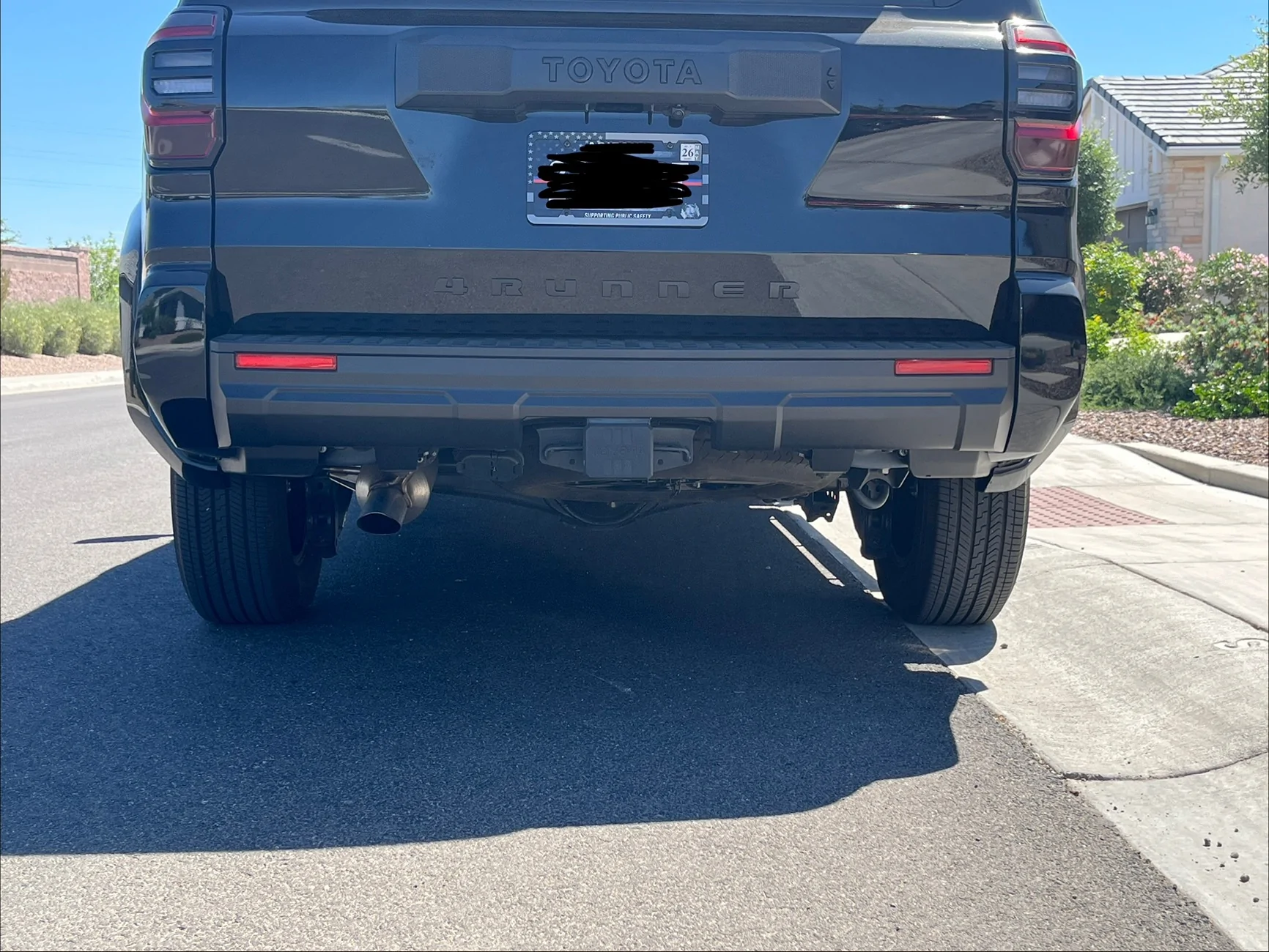

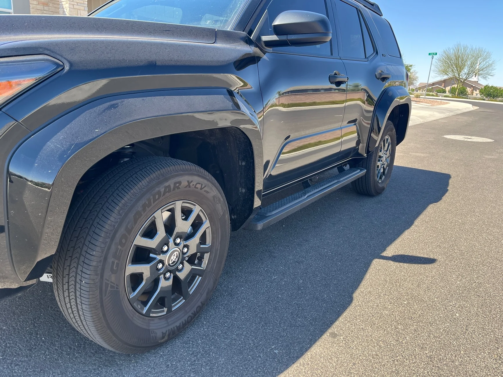

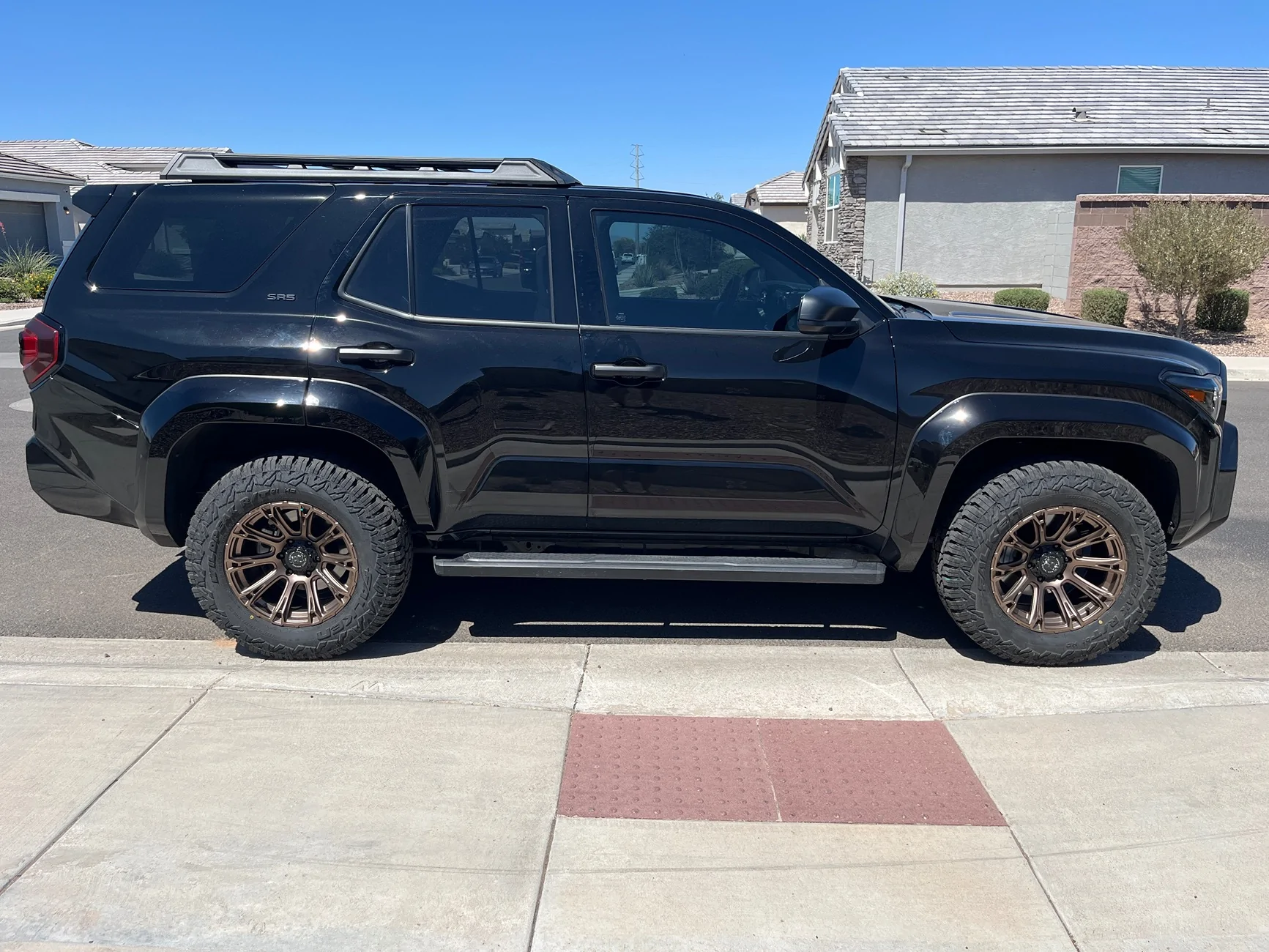

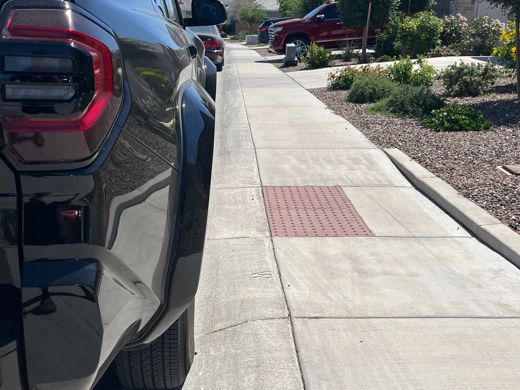

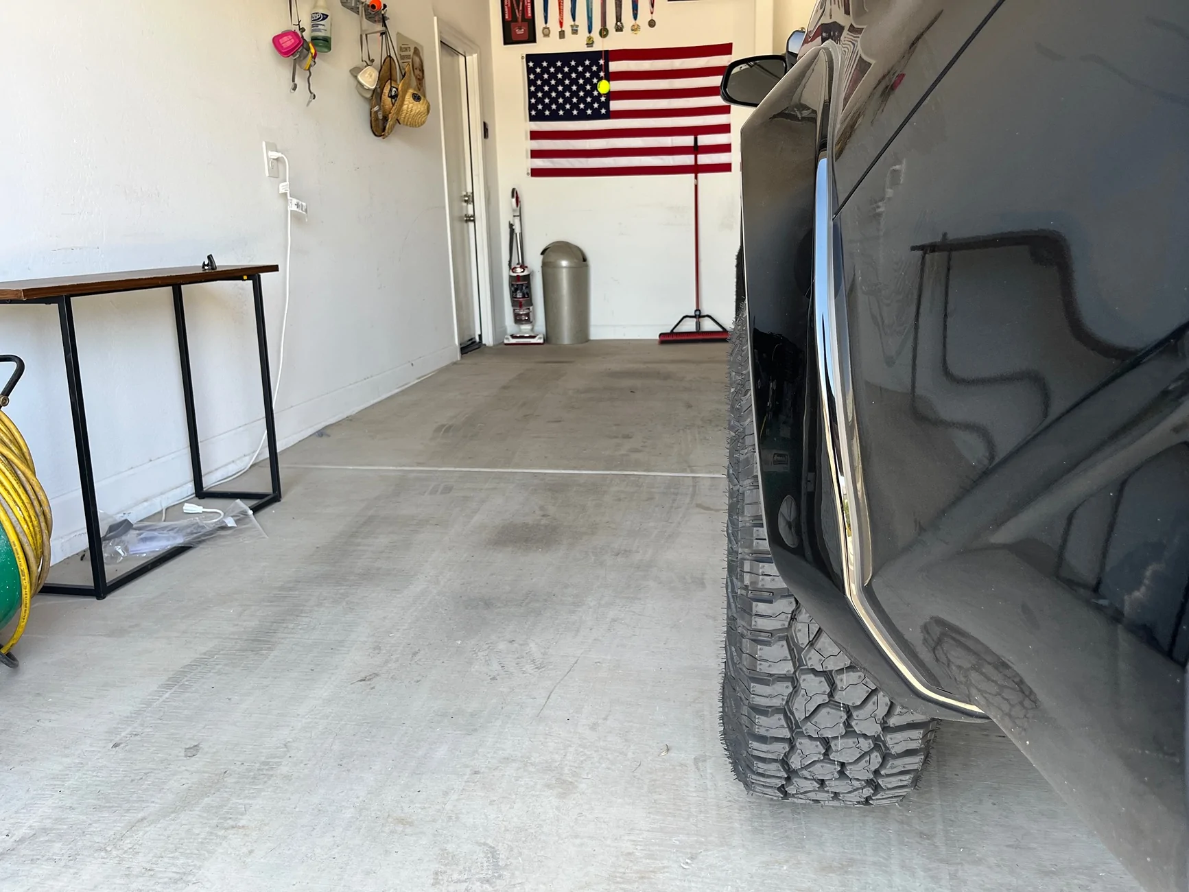

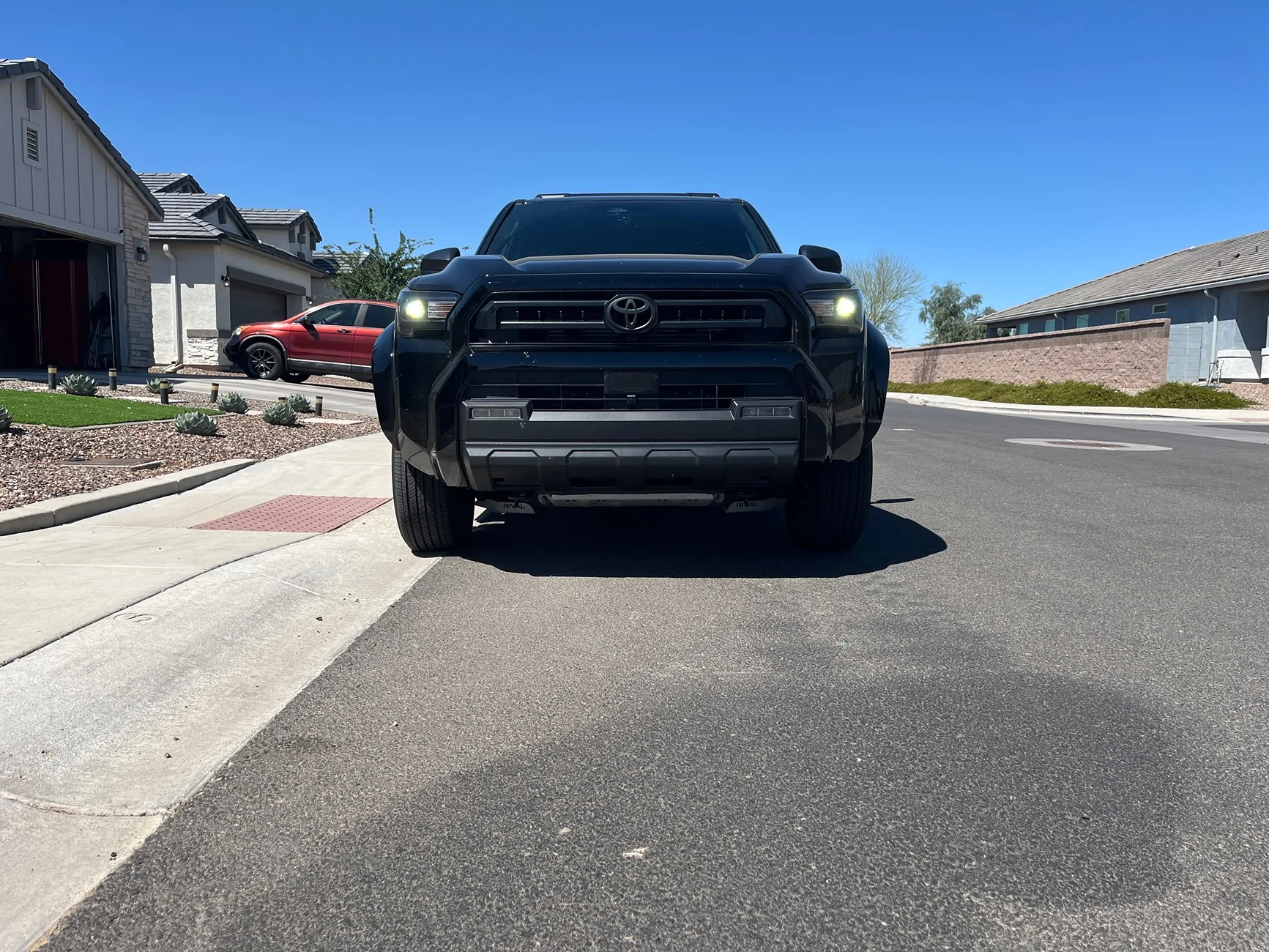

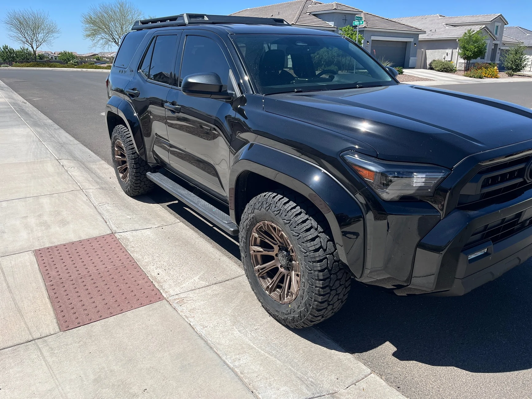

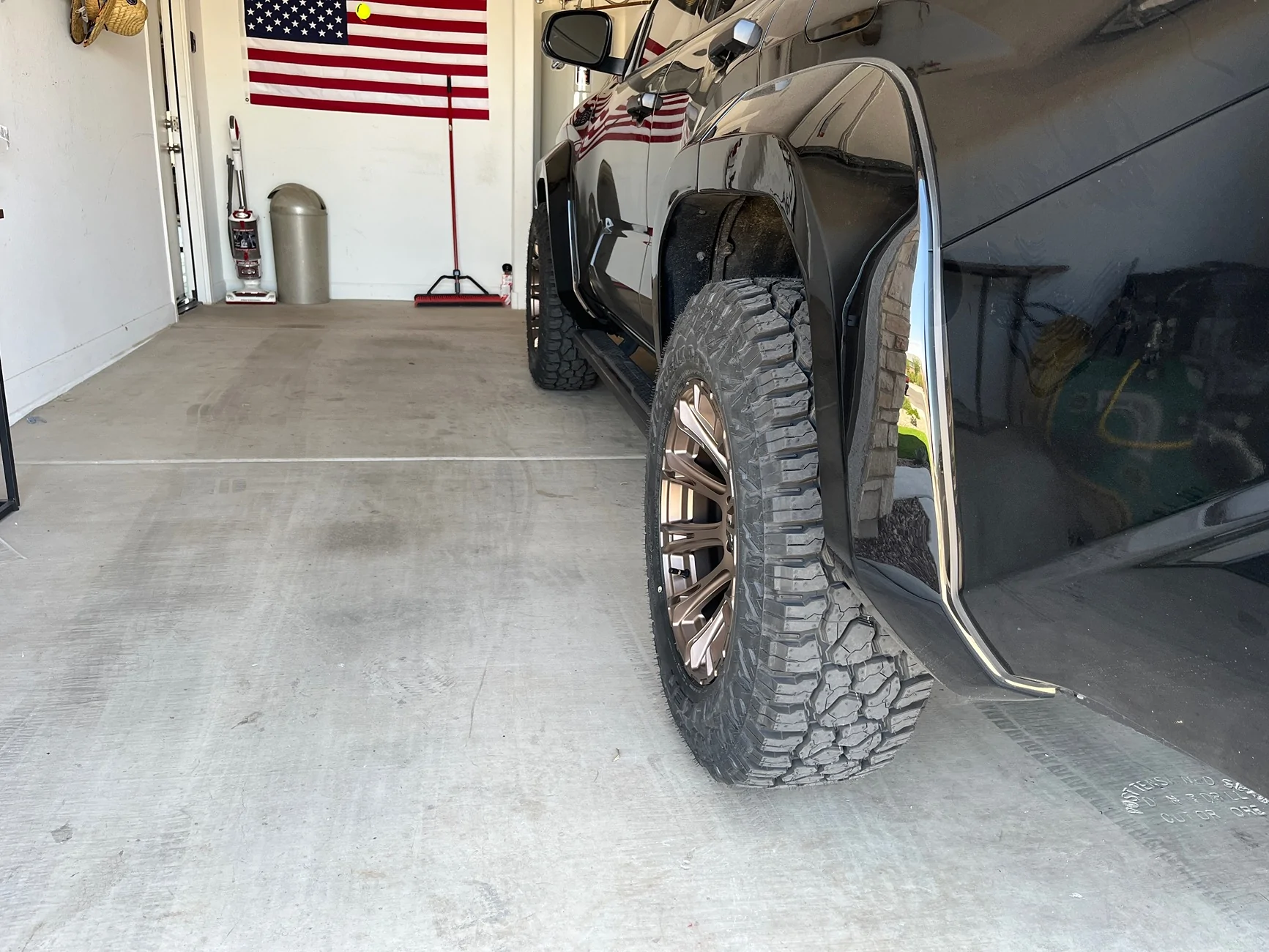

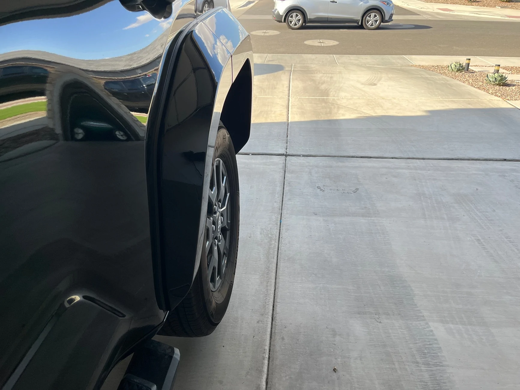

Alright, after waiting 2 months for the rims and a few day delay on the tires, finally got the new shoes. It looks amazing. I love it. There is the slightest rub against the front wheel well liner when the tire is fully turned and the car is reversing. It’s only rubbing the well liner though so no damage to the tire or wheel well. Although I could probably get away with no lift, I’ll probably install a 2” leveling kit for the front and that will resolve that rubbing plus a little more for the trails. No issues at all in the rear.
The tires and wheels look pretty flush with the fender flares. Maybe a tiny bit of poke but no more than 1/4”-1/2”.
