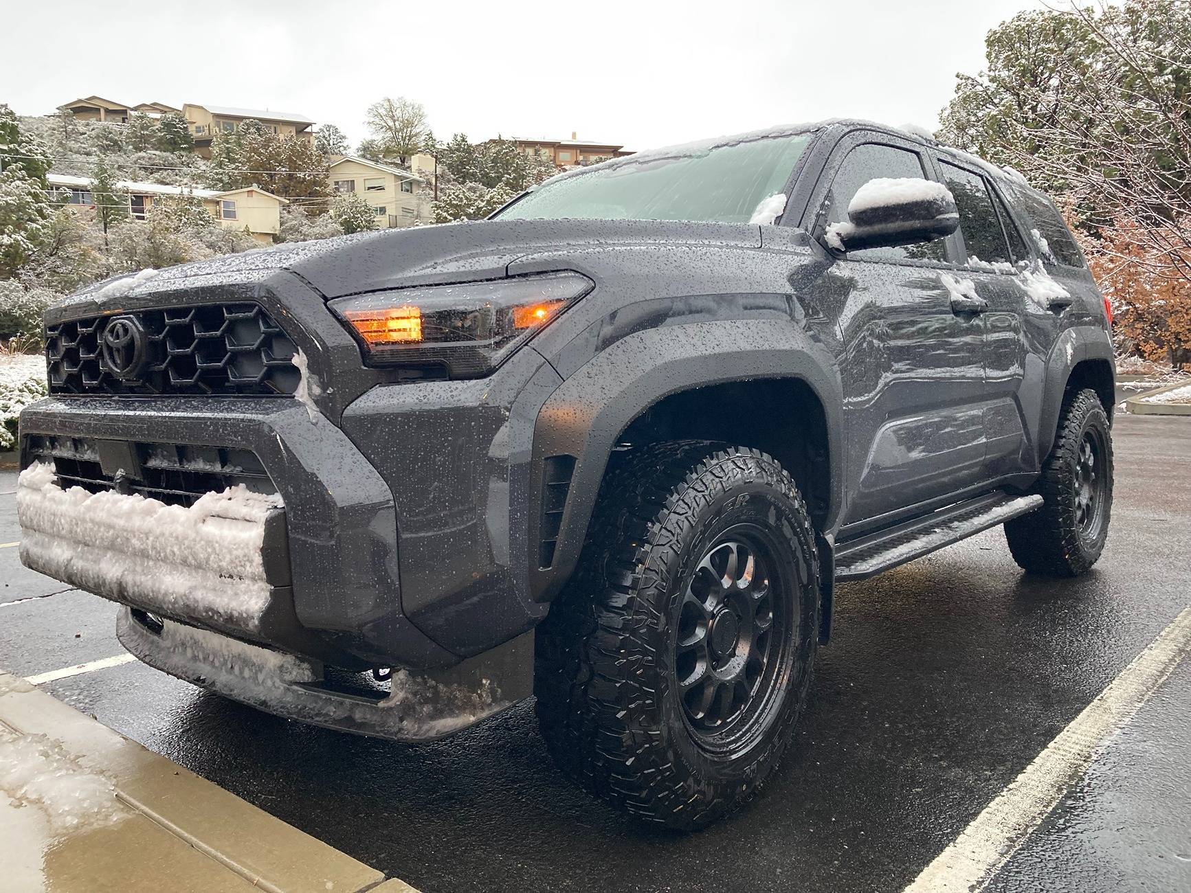

Although I am a dual citizen with Canada and the US, I live in Colorado. They are the Method 320 with 275/70R18. Stock they did rub slightly at full lock, so I put a 1.5" lift on the front only and it does not rub.

Love the Method 320s but can only find them with a 0 offset in 17s, is that what you have ? Aren’t they poking out too much ? (Compared to the +55 stock TRD Offroad Premium rims)
If that’s what you have, I might pull the trigger as they’re currently discounted ;)

Mine are 18s with +18 offset. They poke out a little less than an inch. A 0 offset would poke out quite a bit more.

Ok, that’s what I thought… thanks !
Might go with the 318 then, they have a 25 offset.

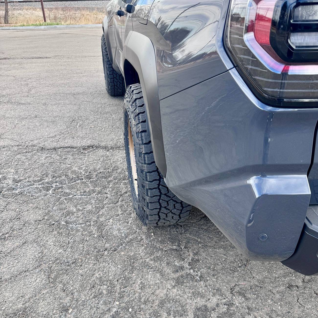

this is mine on the Westcott 2.5 front .75 rear. This kit is a preload collar kit so it allows you to maintain the proper suspension geometry and a decent alignment.
Are you putting bigger wheels and tires to go with your lift?

Would these rub on the stock ORP “silver”, obviously poke wont be as aggressive as your methods. You have a nice bulld.
Yes they rub without a lift. Thanks!
