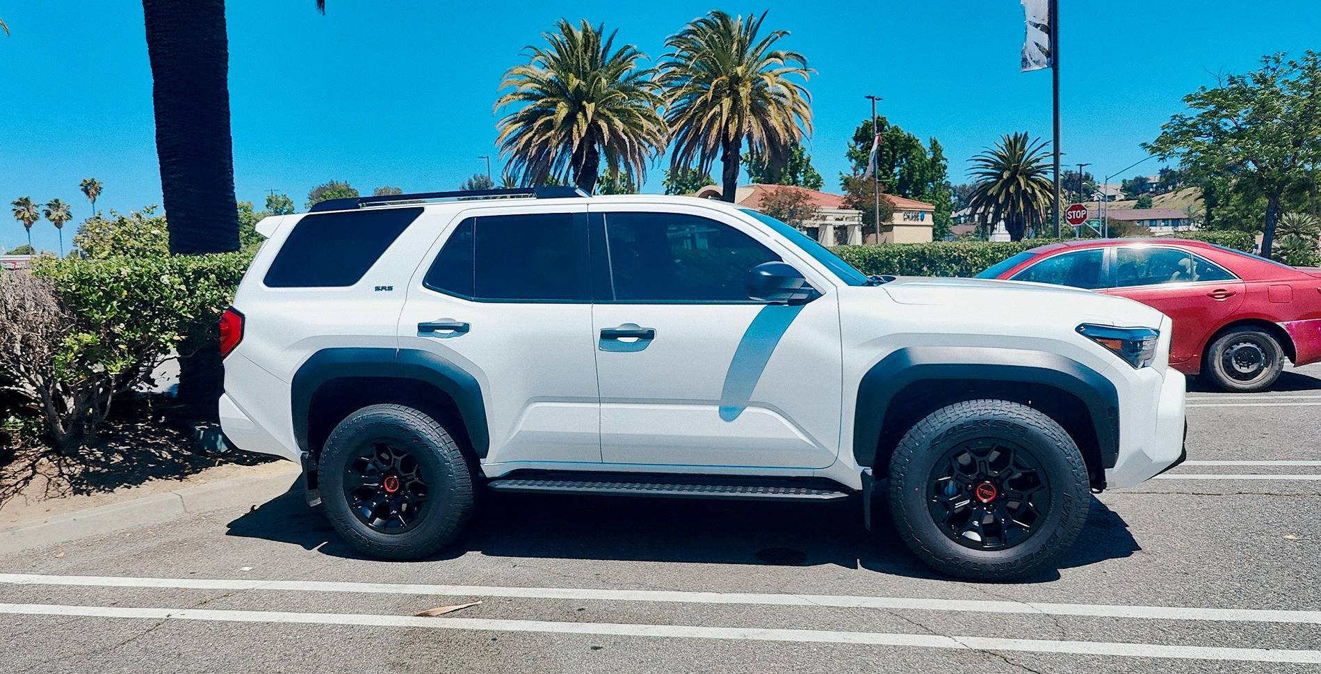

Rims and tires I've had for about a month got a matching spare as well. Just ordered the lift kit. Will get it installed within a week or two

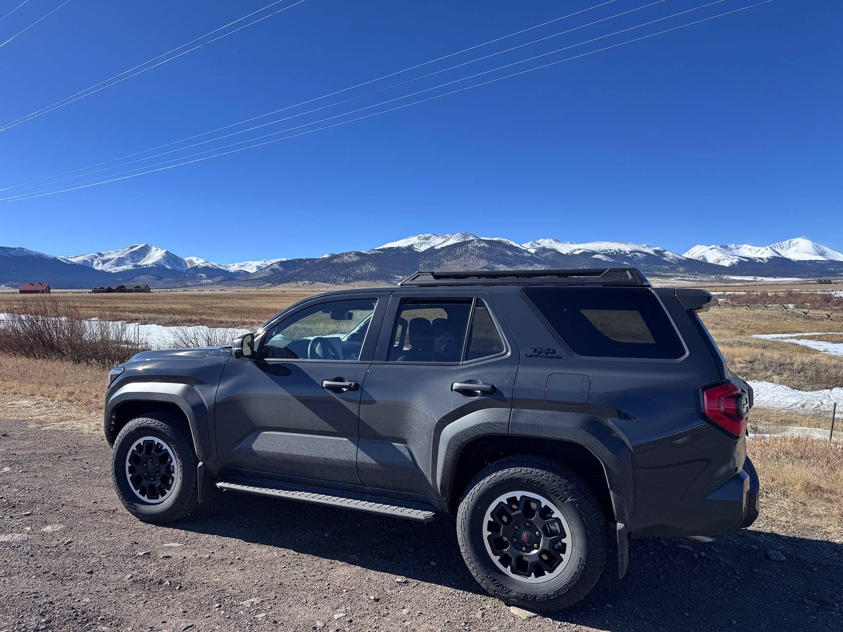

2025 4runner 6th gen Rough Country lift leveling kit - 1.5" vs 2" inch (post your pics) IMG_20250609_181524
2025 4runner 6th gen Rough Country lift leveling kit - 1.5" vs 2" inch (post your pics) IMG20250628113044

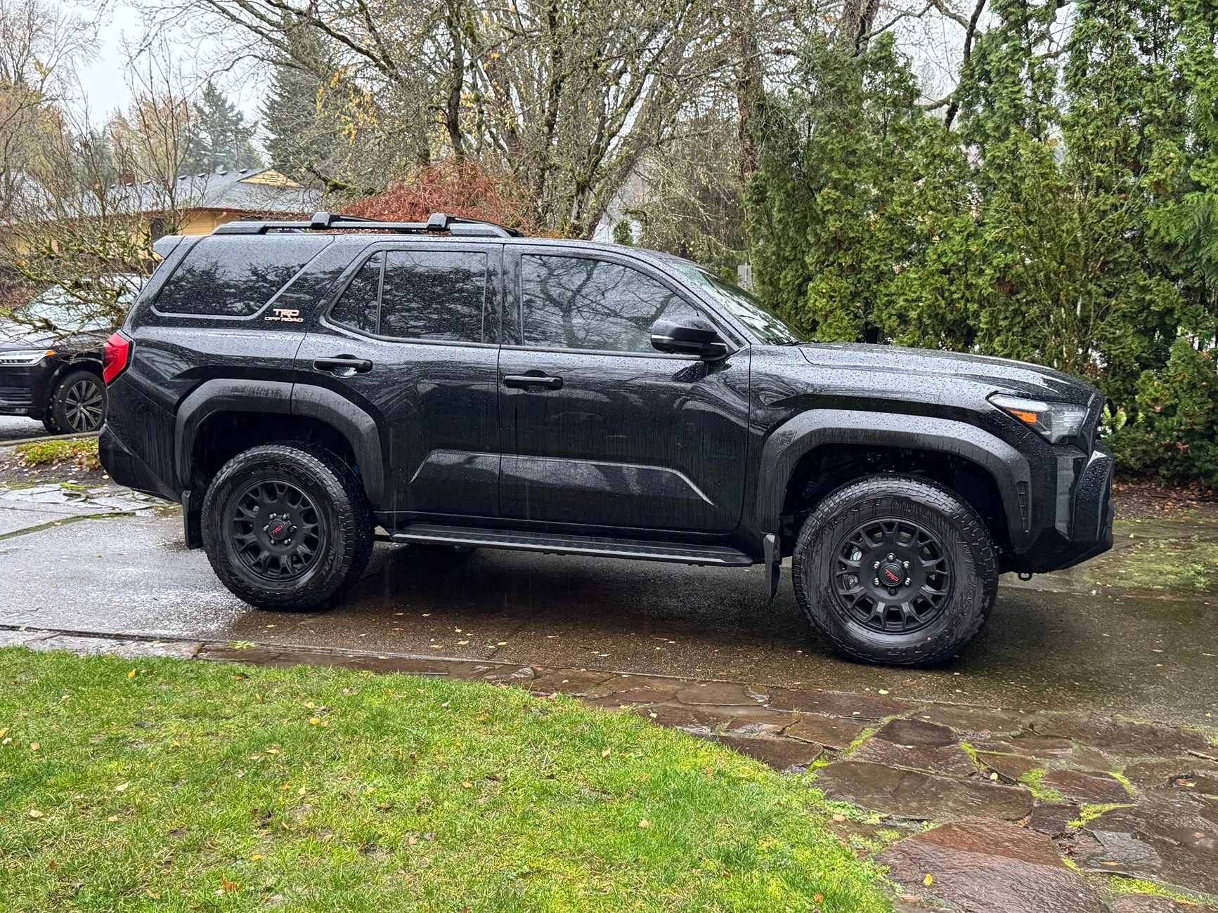

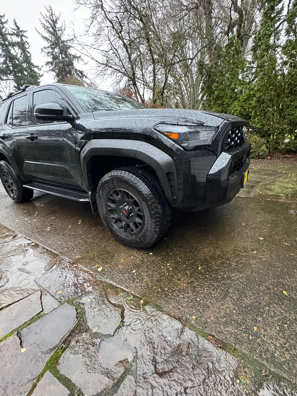

Got the 1.5” Rough Country done at Toyota dealership on my 2025 TRD Premium. Also had them throw on the TRD wheels, TRD cat back exhaust and full window tint all around. Love it so far!
2025 4runner 6th gen Rough Country lift leveling kit - 1.5" vs 2" inch (post your pics) IMG_7963
2025 4runner 6th gen Rough Country lift leveling kit - 1.5" vs 2" inch (post your pics) IMG_7962
