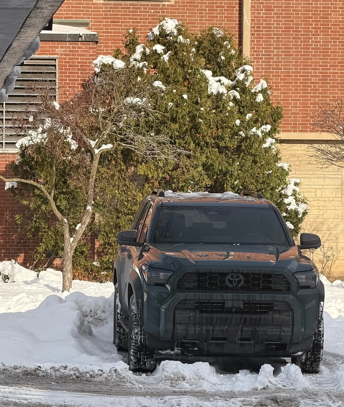

Wondering if anyone else is having problems with turn radius while in 4H - is this common or something to worry about? Under 1,000 miles the car drives like a BEAST but this issue worries me more than the loud brakes while in reverse or driver window not rolling down in sub 30 degree temp…

When a Part-time 4wd system is operated in situations where the tires can't slip sufficiently to relieve binding in the driveline, it can be harder to turn. This is just inherent to the design, and not a problem. But manufacturers do suggest not running in Part-Time 4wd on high-traction surfaces, as it can cause unnecessary wear in the driveline, and could potentially break parts.
If you're only in 4H in conditions in the pic, there will be enough slippage to prevent broken parts. But even in those conditions your steering will undoubtedly feel heavier while in 4H.

I appreciate the feedback as a newbie to the 4Runner community - I was curious since living in Chicago we get dumped on and driving in unplowed city streets even making a left turn on the grid in 4H was challenging. Will keep your advice in mind.
