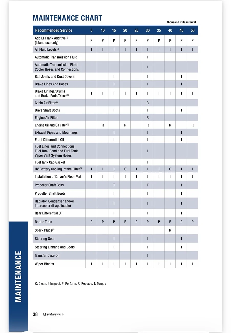

I just hit the 30k miles mark on my 2025 Off-Road hybrid.
With that milestone I was going to take it in to get services since I do all the oil changes and tire rotations myself at home. Also because I want to have someone look at the 4Runner at least once a year for inspection.
What maintenance is usually performed at 30k miles? From reading the forums I gathered:
  • Oil change and oil filter
  • Front and rear differential
  • Cabin and engine filters
  • Hybrid battery filters
Is there something I’m overlooking? Transfer case is at a later mileage?

I’m still doing research but I’m also planning the following at 30K (currently 7K miles):
- Propeller/Drive shaft lubrication every 15K miles
- Transmission fluid at 30K, then every 50K
- Engine coolant at 30K, then every 50K
- Diff & Transfer case fluids at 30K then every 50K
I’m not saying you should follow what I’m doing, simply sharing my plan.
Research is still in progress: https://gerardorodriguez.notion.sit...60ed3b2f80b59817d46830a09218?source=copy_link
Much appreciated! Thank you
