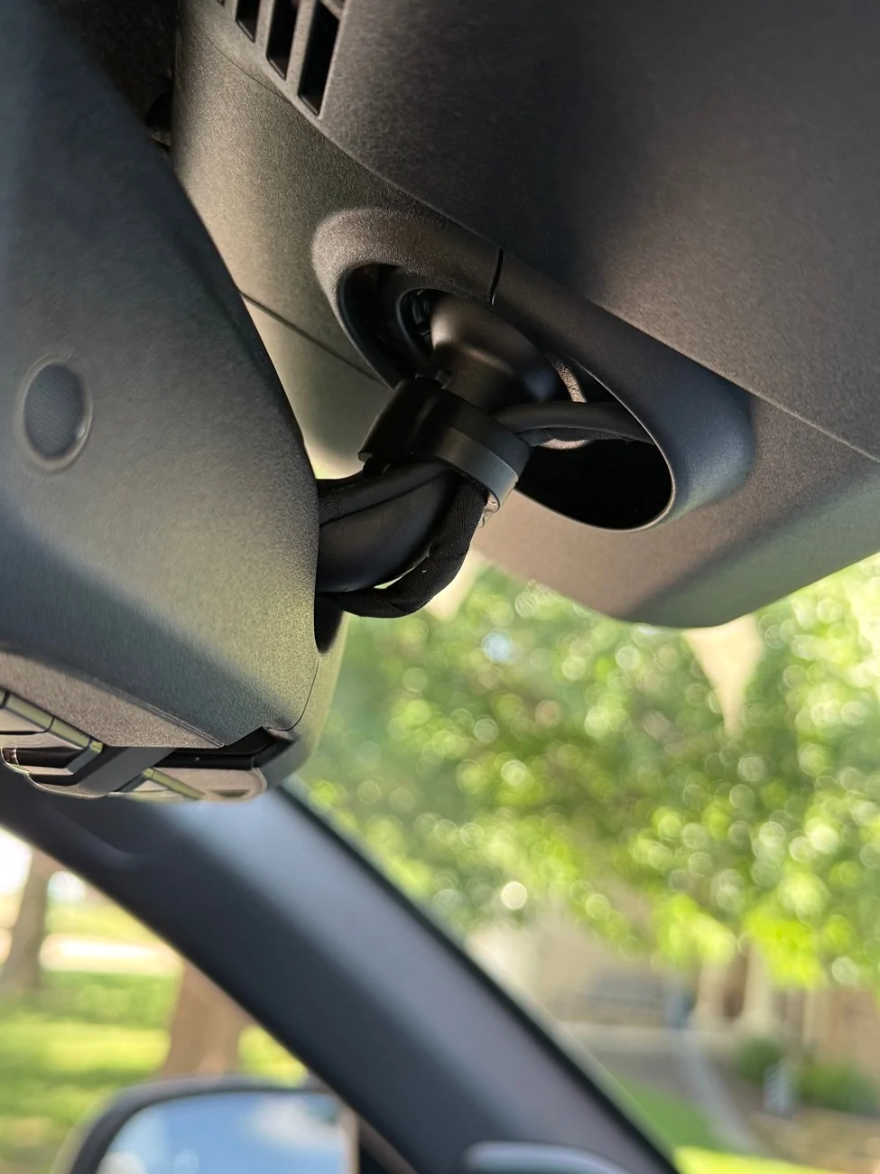

Can you take a picture of the rear view mirror from the passengers side and post it here? I inquired to BlendMount about fitting to the digital rear view and they were not certain until they received a photo. They will definitely come up with a product that fits if they have photos.

Response from BlendMount. this is specific to Uniden R7, R8, and R8W (also highly recommended)-
That's going to be our BR7-2045 mount (Brand new mount we designed)
https://blendmount.com/aluminum-radar-detector-mount-for-uniden-r7-r8-r8w-specialty-2045-series-br7-2045/?searchid=0&search_query=%22br7-2045%22
* You'll have to take off the plastic clip on your mirror stem to mount properly.
If you wanted our MirrorTap, it will be MTX-1015 (Currently Out of Stock)
https://blendmount.com/power-cord-mtx-series-patented-15-long-rj-11-2-amp-inline-fuse-with-military-grade-taps-kit/?searchid=0&search_query=%22mtx-1015%22
- Hoping to have the MTX-1015 back in stock by the end of the week.
Or if you wanted our HardTap to the fuse box, it will be HT-1096:
https://blendmount.com/hardtap-ht-1096-radar-detector-hardwire-kit-with-in-line-fuse-rj-11-8-long-vehicle-fuse-box/?searchid=0&search_query=%22ht-1096%22

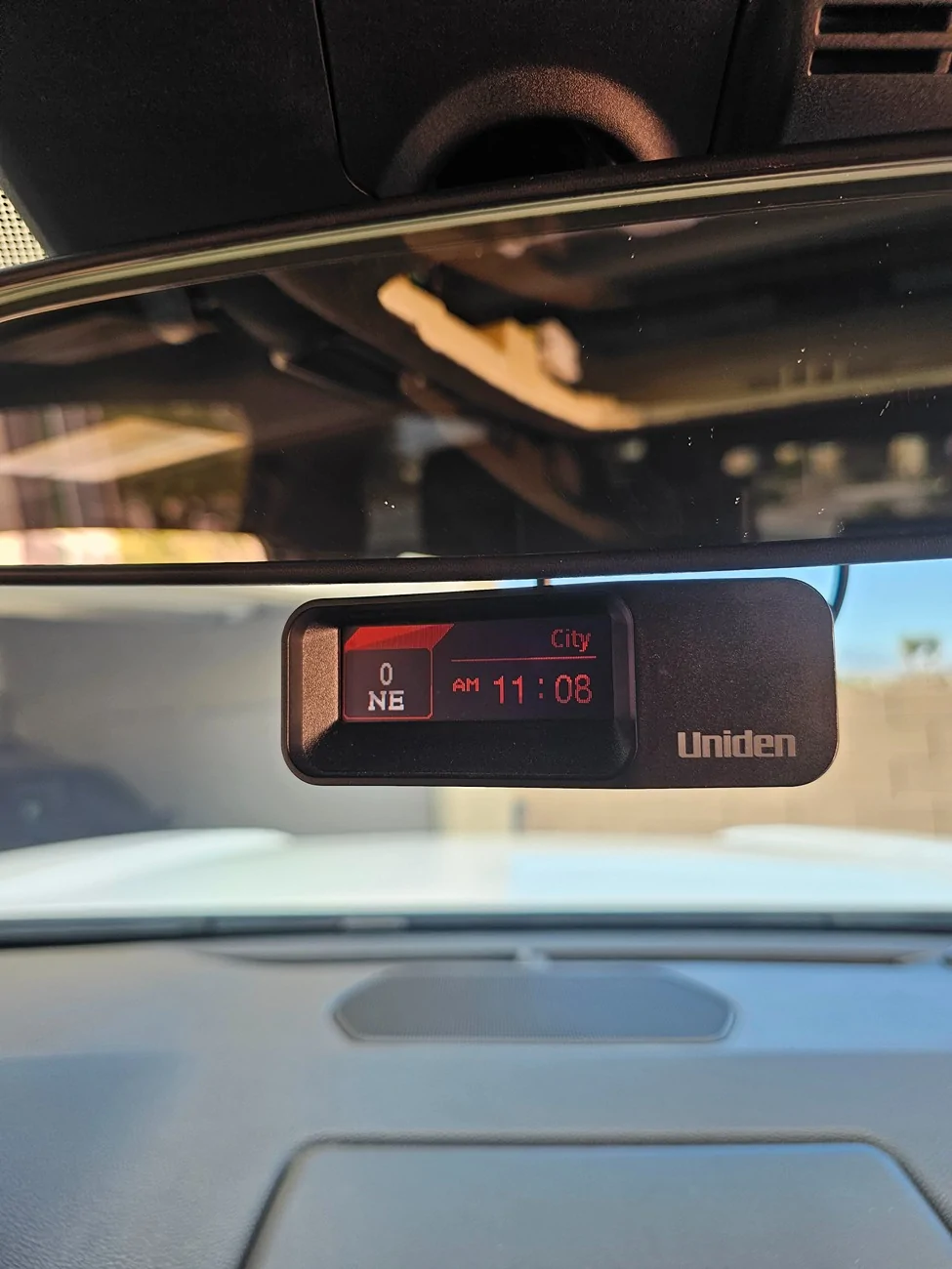

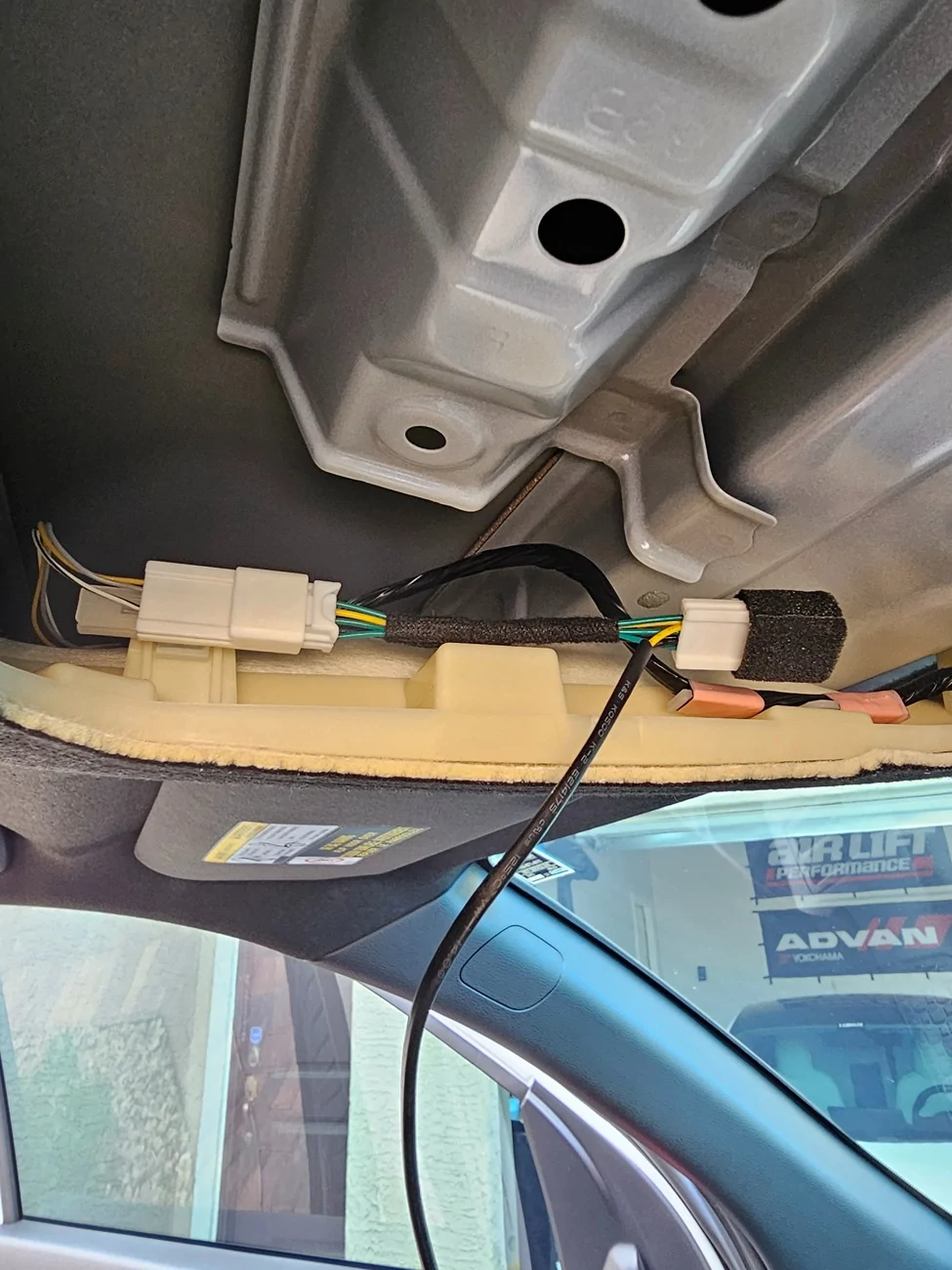

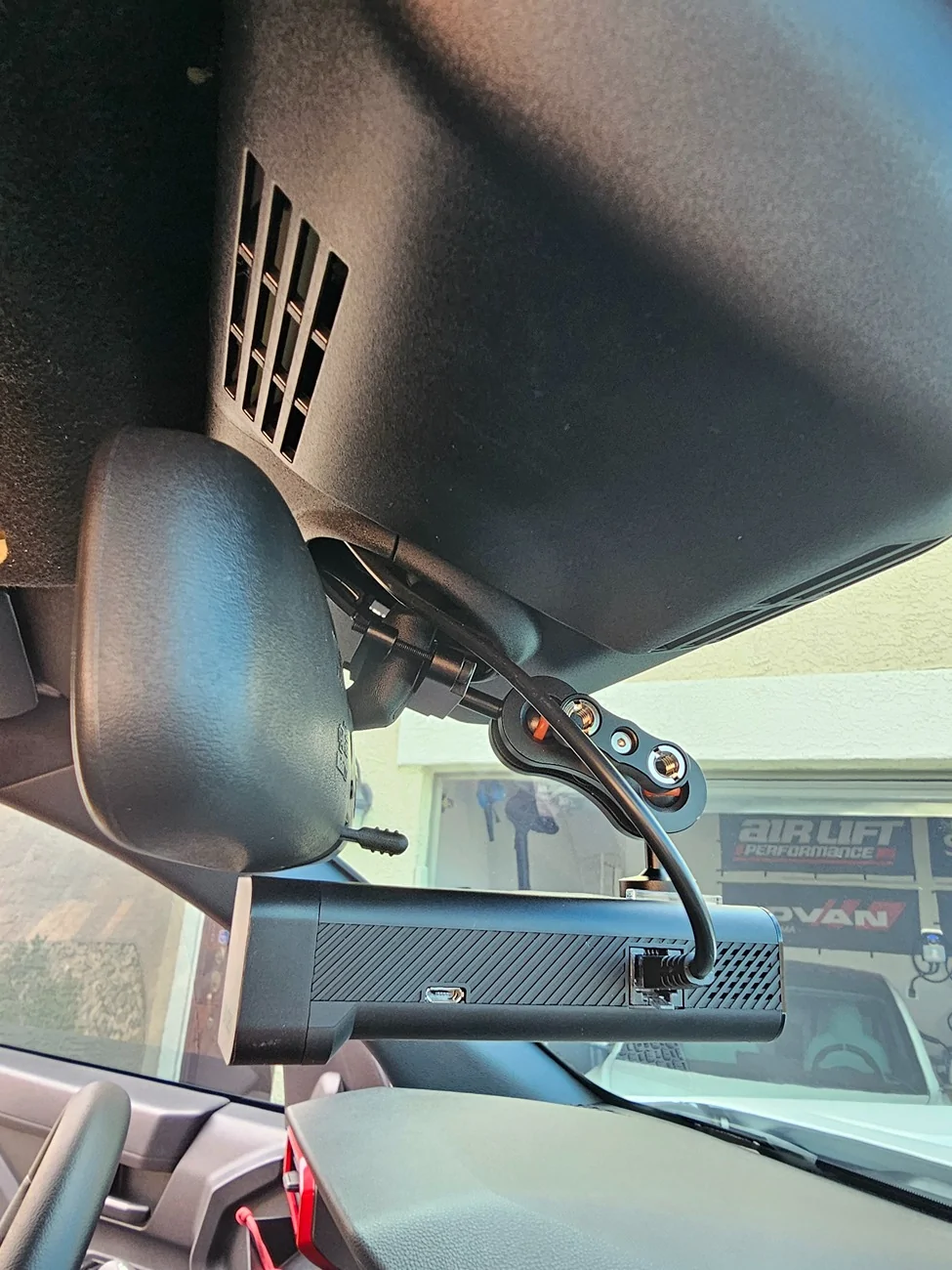

Here's the solution I used. Generic Amazon mount specific for Uniden R7. Blendmount did not have anything available at the time of install. Power tapped using a Dongar adapter.
