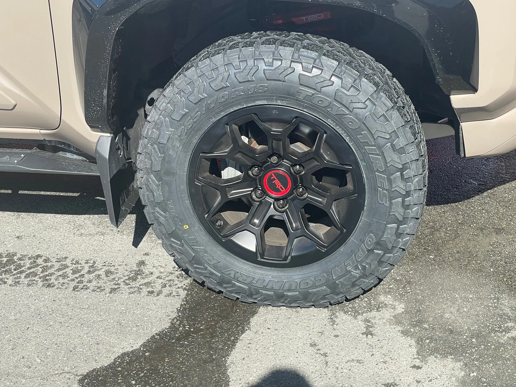

I have this ride with 13,000 miles. I seem to have more tire wear on the very outer edge of tires vs the inner we area. Tire rotation and oil change every 3,000-4000 miles. Also the wear is uniform on all tires.
not sure if this is normal with the more off road suspension and such.
alignment has been checked numerous times and always looks good.

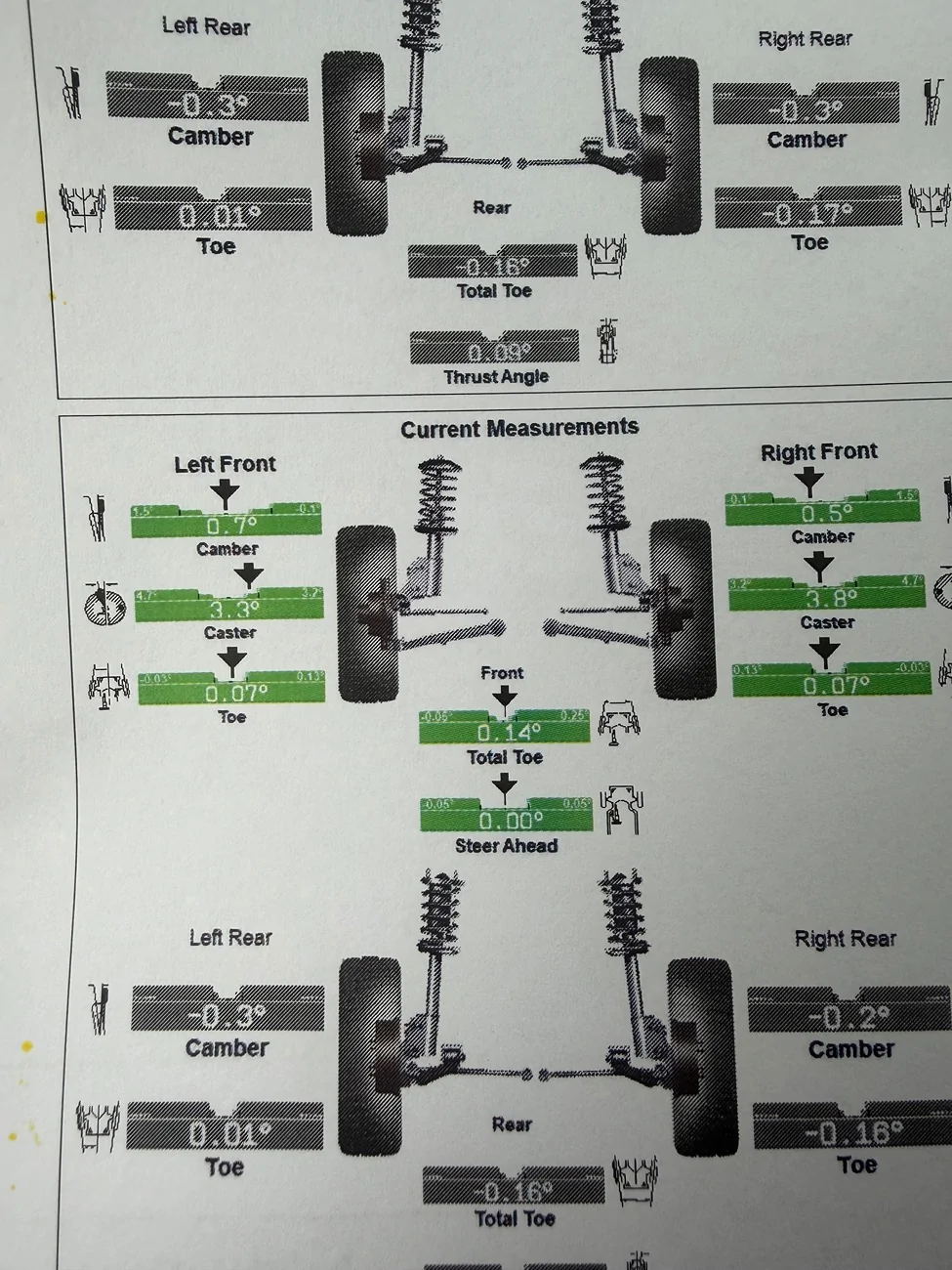

What does the "good" alignment look like?

They were about 3 psi under inflated during the winter.
I don’t think the toe is off. Alignment seemed great when it was checked.

Factory OEM Toyo ATIII are “GARBAGE” not even a year old. Tread depth went to 8/32. Swapped out to Toyo RT Trail LT size instead of the metric tire.

So here is a pick of the alignment.
It was pretty much exactly what it was before.
