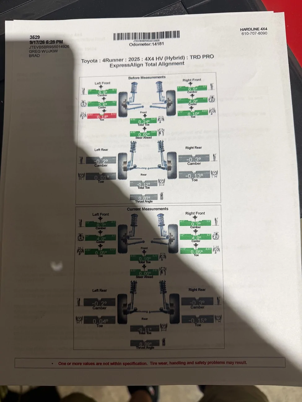

I just replaced the tires on my '20 Ram 2500. The old tires were feathering on the outside and had an alignment performed by the tire installer. 1000 miles forward they appeared to be doing the same thing, so hdd my buddy's diesel shop perform an alignment and the tow was off. Tire installer was Tire Discounter. I replaced the tires on my PRO w/Toyo OC3 EVs running 38 psi. No unusual wear. Our '25 ORP with OE Michelins are also wearing properly. Also running 38 psi. IDK? You might take it back to your dealer if they appear knowledgeable or visit a reputable print end shop

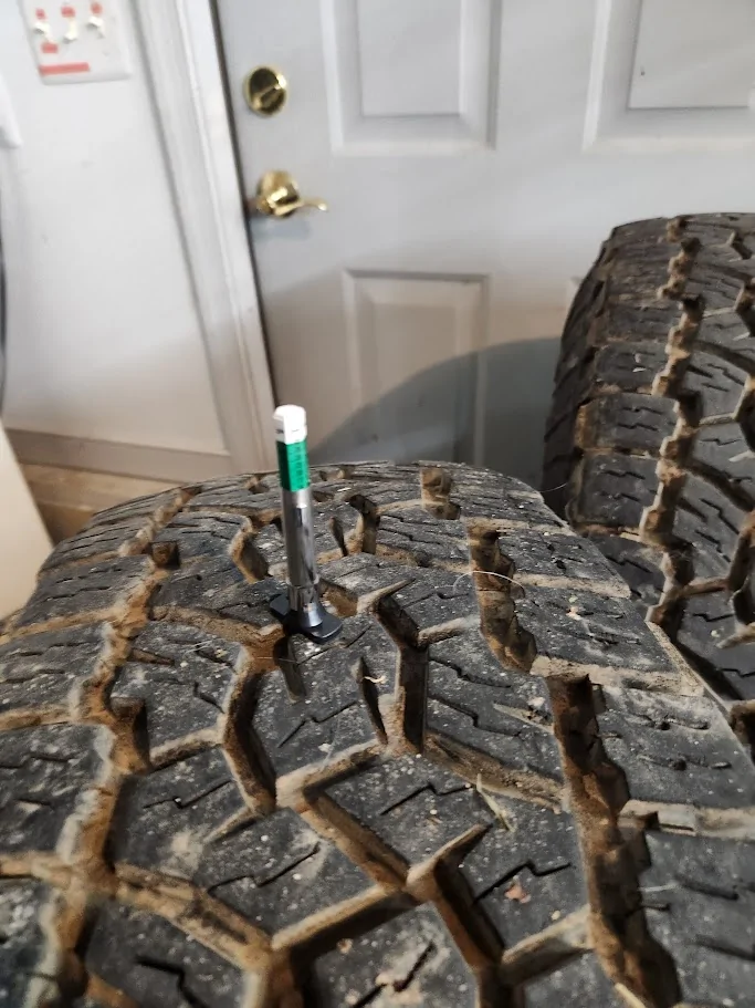

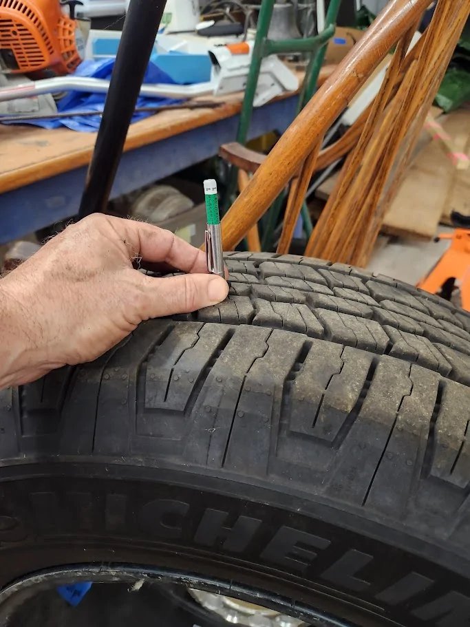

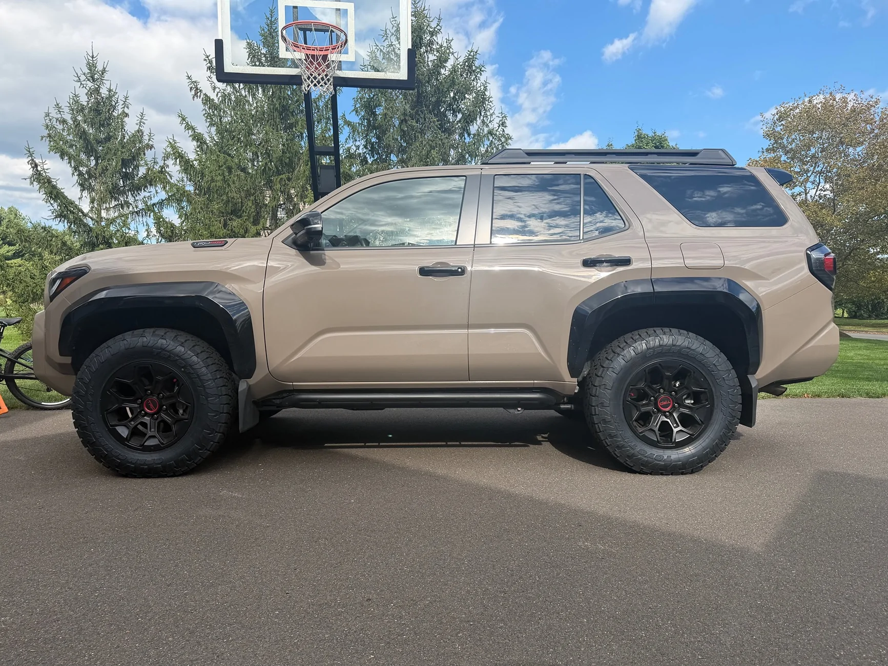

I've got TRD ORP so might be off-base for this thread, but the concerns about stock tire wear triggered me to start measuring and since I run both stock 265/70R18 Michelins (on TRD PRO wheels) and LT285/75R18 Toyo OC ATIIIs I thought I'd post my current status for whatever interest there is.
  • 265/70R18 Michelins LTX Trail (Stock): Miles: 9746; Tread (exactly) 9/32" (spec new: 10/32") projected life : >60k miles @ 3.5/32" (seems right)
  • LT285/75R18 Toyo OC ATIII: Miles: 9303; Tread 14.5/32" (spec new: 16.5/32") Projected life: 60k miles @3.5/32" (also seems right?)
Lots more tread on the Toyo but wearing down faster. Consistent with rough treatment off-roading (e.g., spinning over some obstacles) and generally rougher surfaces (?)

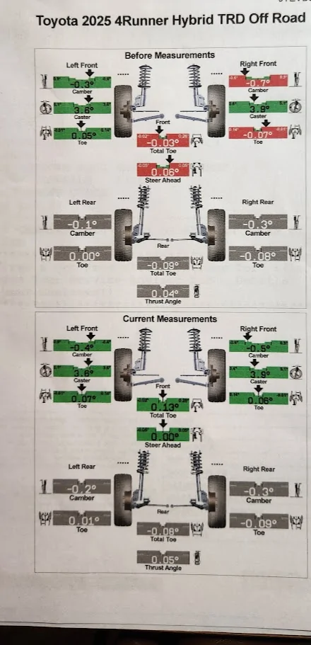

Tire wear seems even on both sets. Have had alignment done 3 times:
  • after installation of Peak 1.25" leveling spacer and first installation of big tires
  • after installation of TRD 2.5" Lift Kit
  • after 500 miles on lift kit
In all cases went from out of spec to in spec.
Dealer who installed lift kit did the last alignment and it needed it after settling in. Was slightly out of spec. Most recent alignment below. Am curious if there should be any significant difference between TRD OR and PRO. (Also wish I could find official Toyota specs on what the numbers SHOULD be. Have had no luck searching for that).
