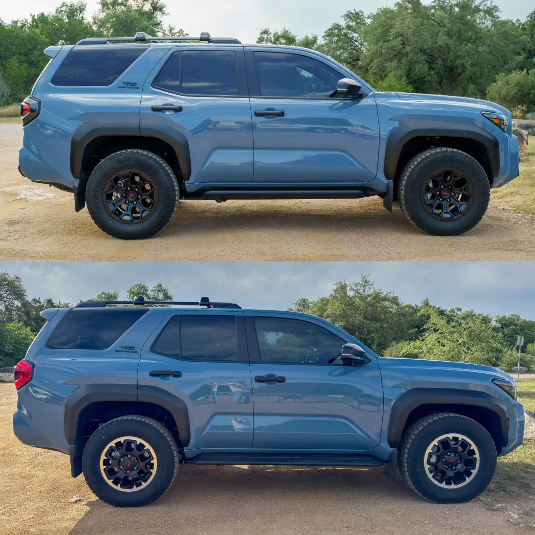

I just did the 1.25" peak level spacer and it didn't change the ride noticeably. Maybe like a hair stiffer over bumps. It's mostly just aesthetics. It doesn't change anything enough to mess anything up with the stock bilsteins though. The 2.5" spacers I think are a different story because you're decreasing your down travel quite a bit. You will need an alignment though.
I am generally not a fan of leveling kits because rake (more height in the back) is there for a reason. Pack your truck full of gear and people and all of a sudden the back is sagging lower than the front and you're blinding everyone on the road at night (luckily we have headlight height adjustment in these trucks). BUT this truck needed a slight adjustment IMO. It still has positive rake even when I have my dog and gear in it. If it does sag you can always throw some air lift air bags in there easily and on the cheap.
Here's a thread on mine with pics.
Here's a before and after pic

Freaking love that blue. I wanted that color so bad but my wife didn’t like it. Happy wife = happy life. Man I wish I had that color. I think that 1.25” spacer and 33” would really make it look at lot better. I’m going to do that. I’ll post a before and after when I’m done. Thanks so much!
