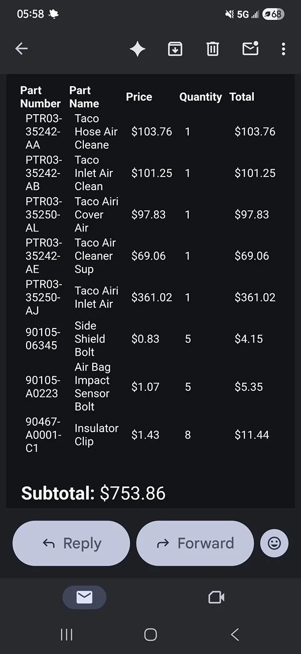

Bro right here i got you, install the snorkel and make the TH owners cringe even more. Should be same parts as Tacoma except for the fender. For all of the parts below, the actual parts you order may have different numbers because toyota keeps superseding part numbers. If youre really unsure though you probably can also go to your dealership and confirm the right parts:
2025 2026 4runner 6th gen Project Trailhunter Screenshot_20260211_055825_Gmail
Looks like the TH fender with snorkel cutout for 4Runner is 53811-35450. You'll need to get it painted.
PTR03-35242-AH air cleaner support (holds snorkel to A-pillar. Has integrated magnets, peel and stick ppf to protect the A-pillar, and peel and stick double sided tape to also stick it to the ppf), about 100 USD. Just gotta attach the bracket to the snorkel inlet tube, lift up the windshield weather stripping trim, and then lay the bracket onto the pillar carefully.
You'll need an air intake that accepts the snorkel like banks or sxth. If you want the pro/TH intake you'll need to also scale your MAF to avoid a check engine light:
PTR03-35241-AA Filter conical oiled
PTR03-35241-AB red hose (red EPDM rubber); the black hose looks like it may be PTR03-35250-AM; red hose might be superseded by PTR03-35240-AA according to my search just now
PTR03-35241-AC airfilter lid (black plastic part that holds hose to filter housing and MAF)
PTR03-35241-AD filter housing (black filter housing with red TRD on it, comes with grommets); I am having trouble finding the trailhunter filter housing with the symbol on it :/
PTR03-35241-AE coupling kit (red rubber fender plug and red rubber piece to connect to the grill air scoop; fits tight to housing)
Need upper screw hose clamp for air hose #2 (different size at MAF housing from stock): 96111-10900
Lower clamp same as stock: 96111-10830
If needed:
MAF Screw (rose gold color self tapping) need 2 each 90099-00330
MAF Sensor 22204-24010
Plastic Pop Clips for air scoop need 4 each 90467-07217
Works but is tight: TRD Hardware kit with intake housing spring clips and one rubber grommet that may not work for anything (says for 2012 FJ, TACOMA, ETC. BUT STILL WORKS). Comes with 4 spring clips to hold air filter lid to the housing and snaps onto lid nicely
PTR03-35090-AE
Rubber Grommets 17769-25030 to sit intake on metal ball studs 17765-25010 if needed for engine bay

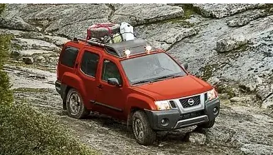

I figured it they were tightly installed in those indents it wouldn't look as goofy as a bar installed mid-roof. Technically, i don't need a ligthbar up there anyway but I am not sure of the purpose of the indented flat spots.
Like a 2015 Nissan Xterra but even that rack was forward positioned for OEM lighting.
