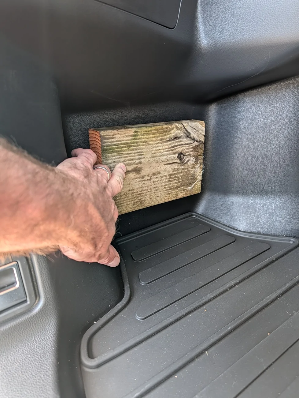

With the ORP, I'm having some trouble figuring out where to put the amp. I looked up slim line amps, possibly the Skar SK-M5001D with a matching ported 12" sub. Even with the amp dimensions at 9x5x1.75 height, I can't seem to find a good spot to put it. I cut some 2x6 lumber into 8" length and threw it under the passenger seat and the seat cables and components definitely hit it, and I'd still need about 3/8 more height over the piece of wood, so that doesn't seem feasible. I might be able to remove some of the carpet/fluff and attach it to the body, but I'd need to pull out the seats to verify that. Plus the air vent is there and I really don't want to lose that.

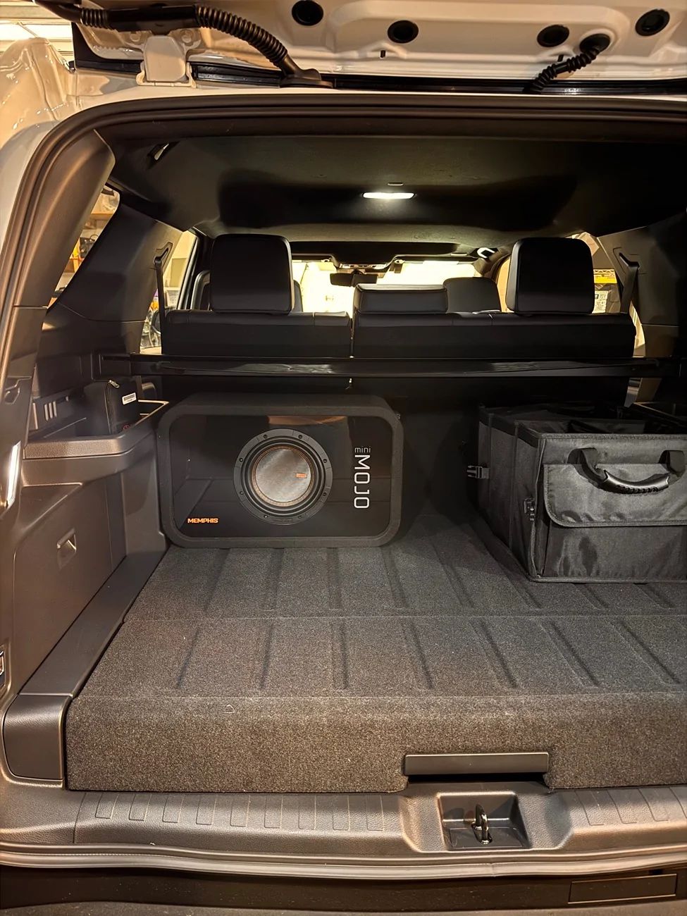

I did a down firing subwoofer from Crutchfield because the dog rides back there.

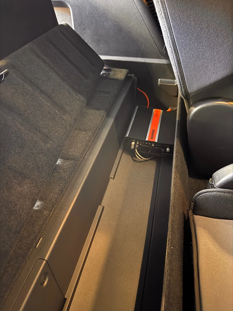

If you didn't get the hybrid, you can try sticking it under the panel floor.

This is where I put mine, it looks like you don’t have a hybrid, so I’m unsure what kind of storage space there is.

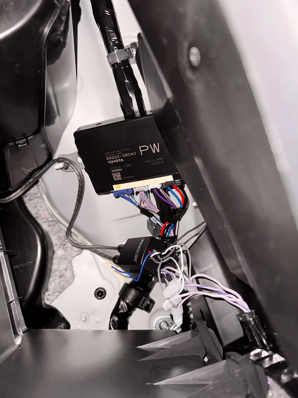

I installed the Beat-Sonic ENA-3T3 for RCA and remote, but due to my inability to fully read the description, I didn’t realize that you had to control the amp volume separate than the head unit volume, I guess it’s a JBL only thing. So I tapped into the factory subwoofer with a LOC, but I’m still using the beat-sonic for remote.
