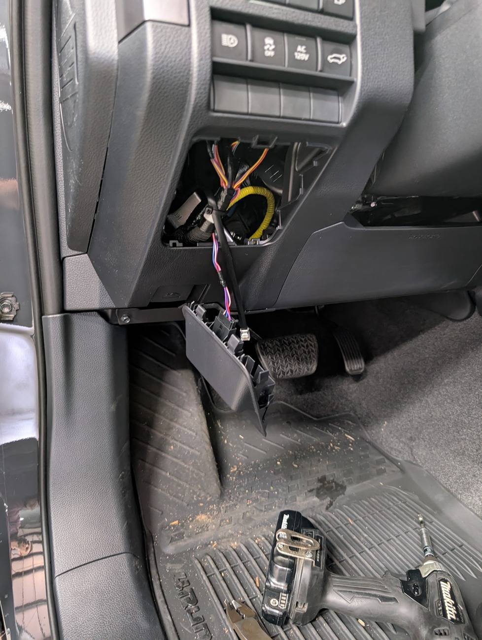

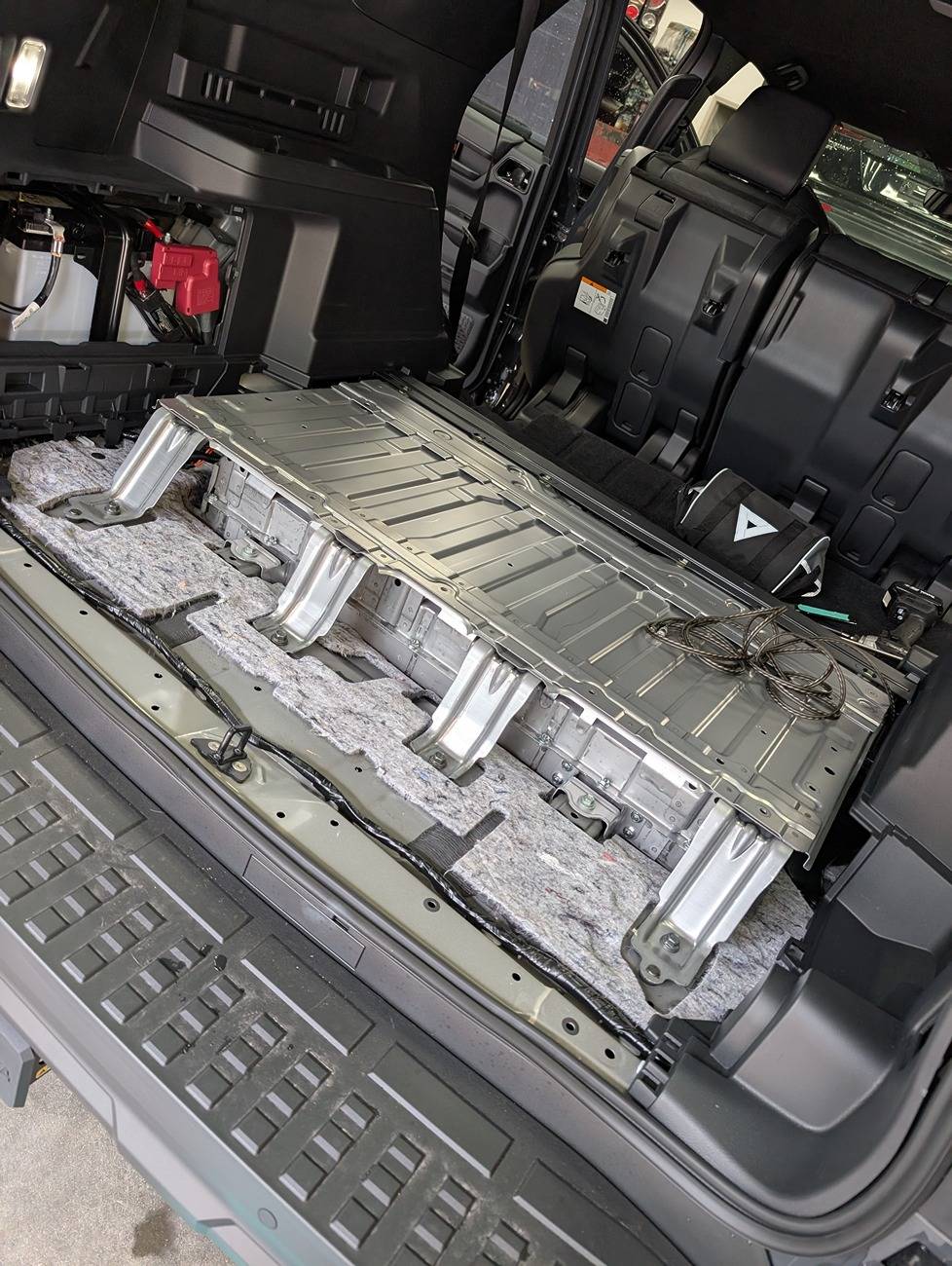

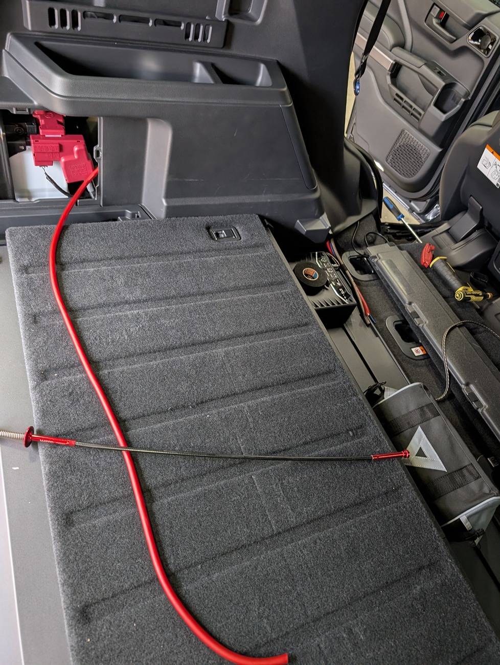

Watching the pros install my amp and subwoofer this morning made my anxiety skyrocket (three hours felt like forever!), but the final result is SO worth it – like, a thousand times worth it! $730 worth it (I already owned the subwoofer and box, but the cost covered a new amp, wiring, and labor).
The sound quality is unbelievably better.

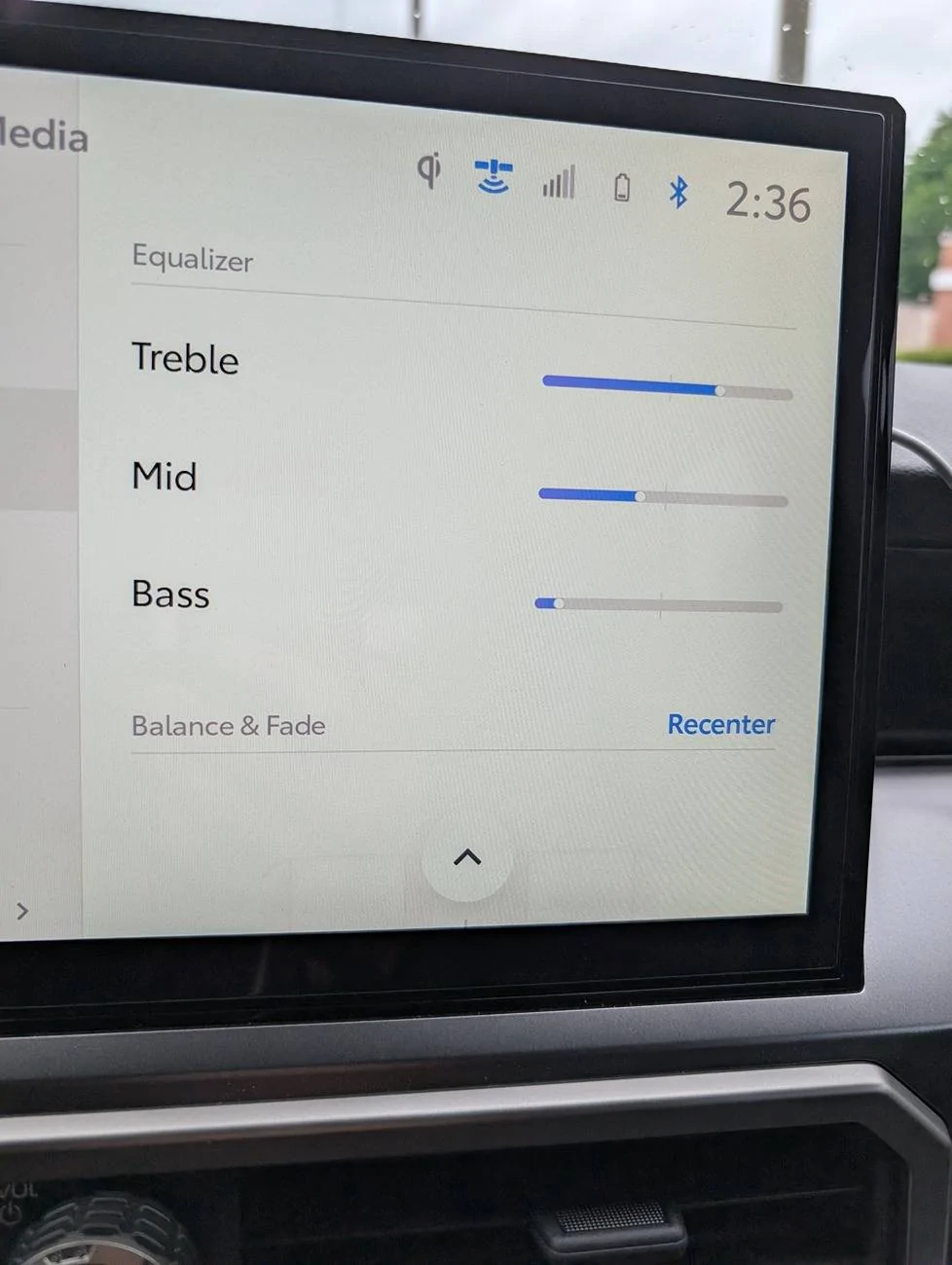

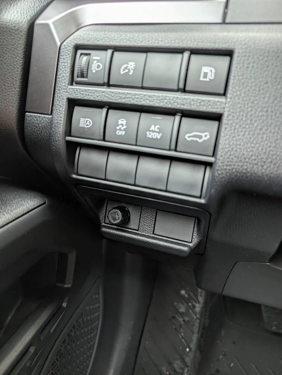

I've turned down the factory JBL bass and the subwoofer is handling all the low-end frequencies. Plus, they installed a handy bass control knob in the aux panel, so I can easily adjust the subwoofer without fiddling with the amp.

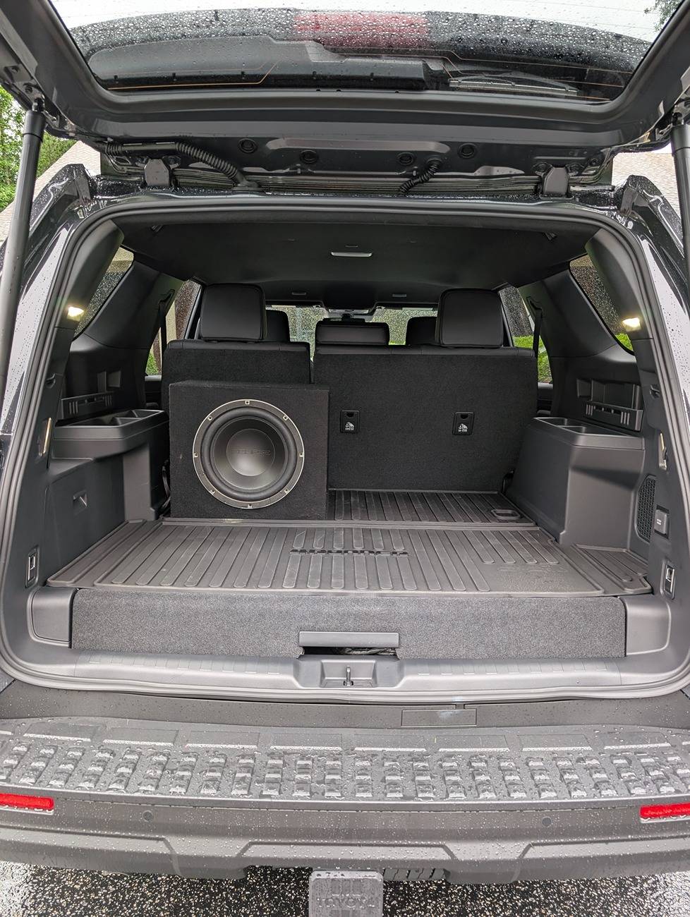

And the best part? The subwoofer can be quickly disconnected and removed whenever I need extra cargo space.
SPECS:
*Rockford Fosgate - 250 Watt Mono Amplifier (R2- 250X1) [installed with Velcro - no drilling - in the empty cubby area between back seat and hybrid battery]
*Eclipse 10" Subwoofer #86100DVC [old school]
*Bass Control Knob [spec unknown]

Exactly what i needed. My sub i use to have in my 5th gen is sitting on the floor. Do you know which wires are spliced into at the factory jbl sub to get signal for the rca converter?
jrenzag
jrenzag
Jan 29, 2025
Raleigh NC
2012 Jeep Grand Cherokee Overland
Unfortunately, I did not watch the install that closely. All I can tell you is that it was one of the wires that connects directly at the sub.

Ah ok yea i know i did the same thing when i had a cayenne a few years ago off the factory sub. Not as clear of a signal as it would be from RCA from the head unit but functional.
