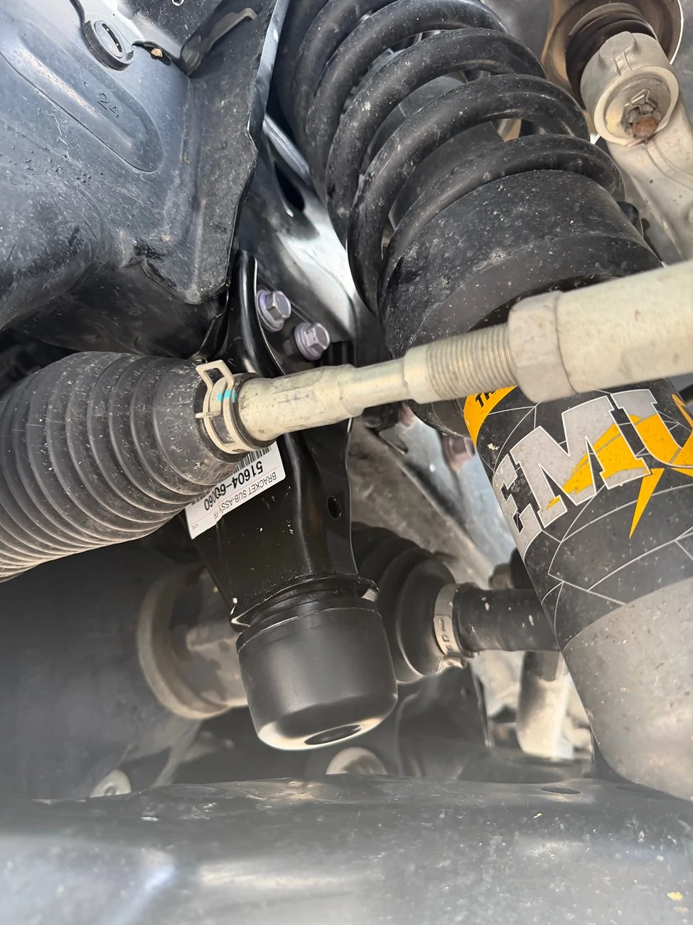

Part numbers:
Driver Side: 51604-60060
Passenger Side: 51603-60060
Frame Bolts (6): 91674-N1030
These are for either LC250 or GX550. We have the same frame, TNGA-F, and they bolt on to threaded holes directly above LCA - 2 on the side, 1 on the bottom of frame.

Does: Driver Side: 51604-60060, Passenger Side: 51603-60060 come with the rubber stop? or only the bracket? Thanks
Just the brackets. You’ll need (6) frame bolts as well 91674-N1030. I used Durobumps - DBF17T. You can get them from Durobump (I know…duh) or I got them from SRQ Fabrication - they had some in stock.
