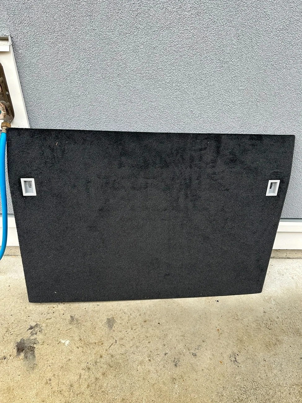

I pulled up the floor panel, per Vincenzo's great recommendation. Plenty of room to store my emergency Sven saw and my jumper cables (folded neatly).

I loosened the two 10-mm bolts securing the hold-down latch to the floor , them pulled up on the rear of the floor panel to release the three clips on the back edge of the panel. There is a space 3 or so inches deep under the floor panel.

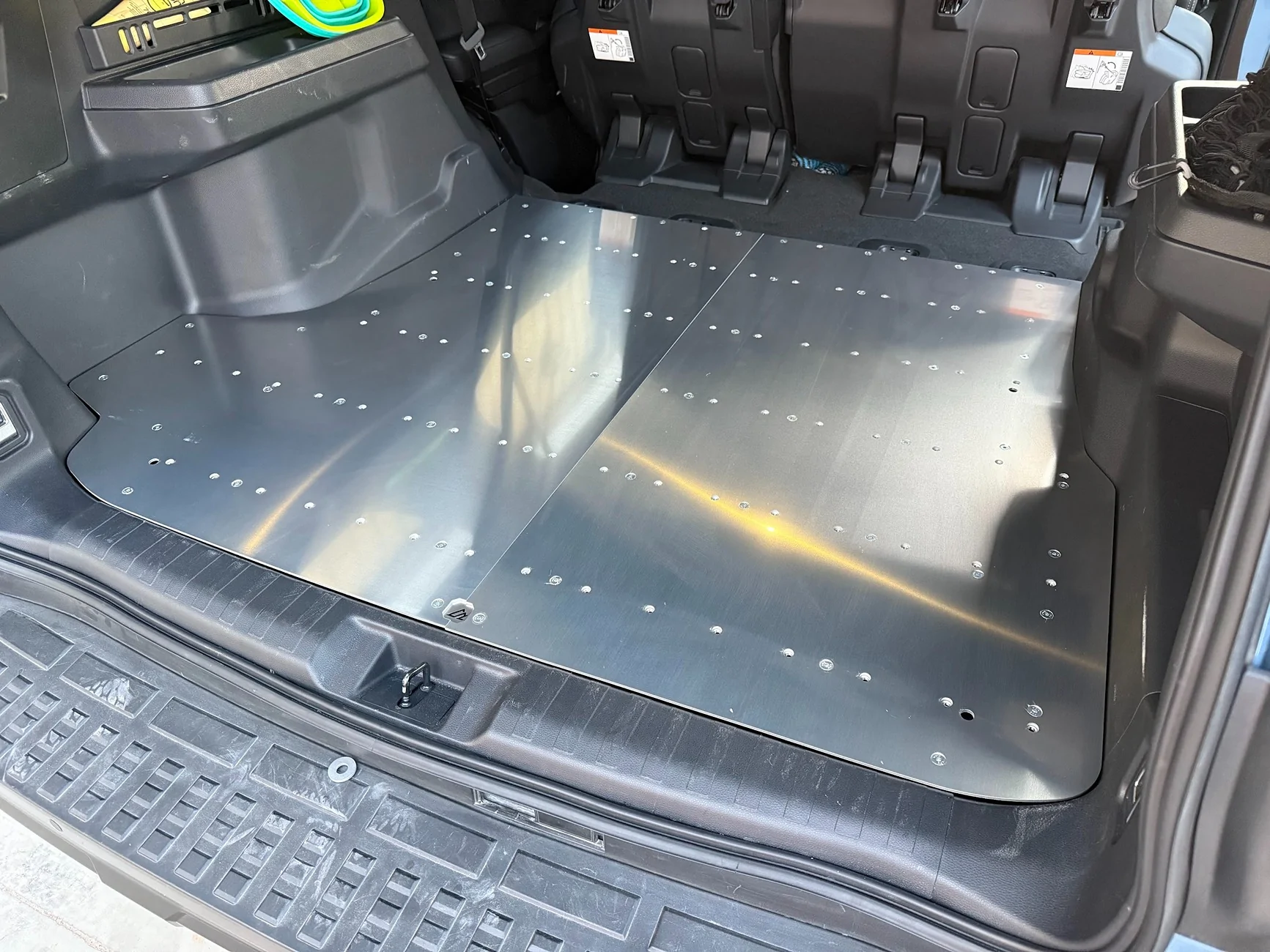

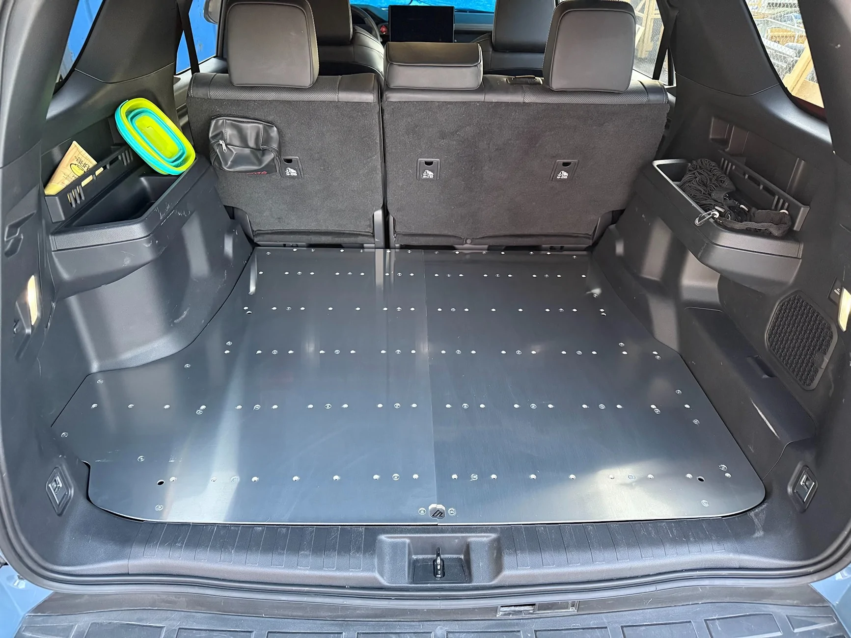

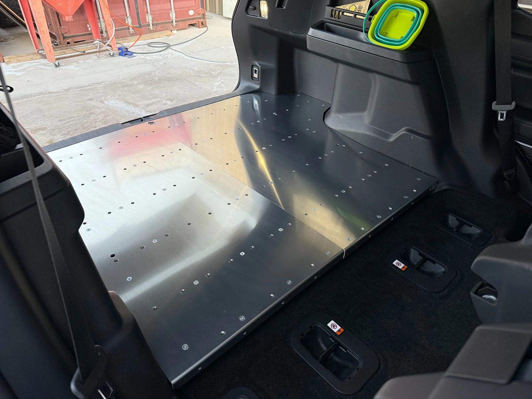

We are hoping to have our solution for the 6th Gen available soon. Here's an early prototype image. The production version will have access doors for the storage area under the platform, and possibly some mounting solutions for aux batteries or compressors under the floor.

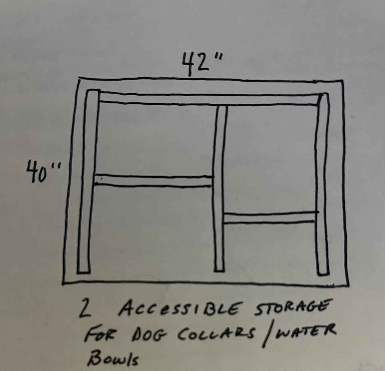

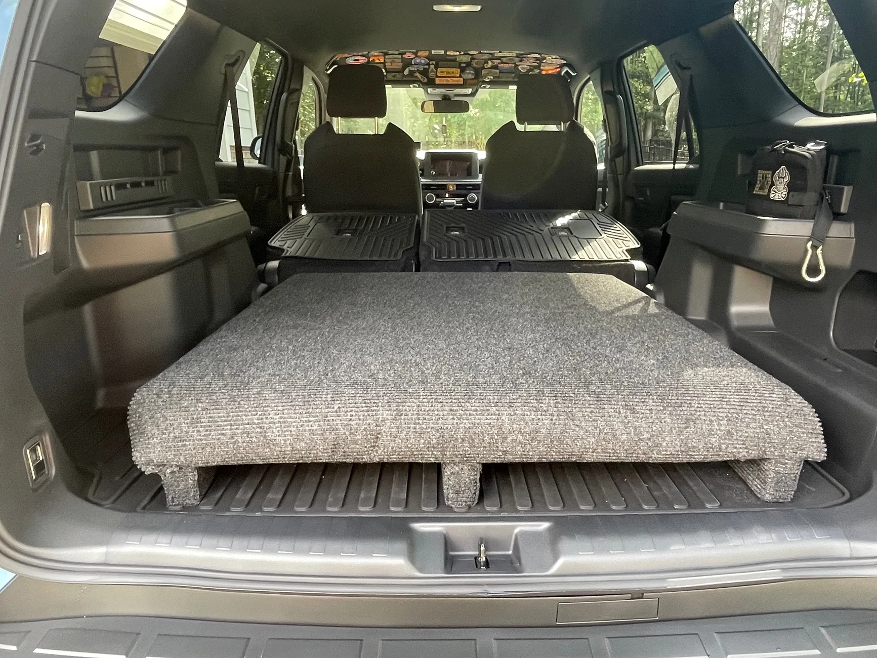

Does seem objectively dumb but stay with me… The flatter floor would be so much nicer for me and easier for my two dogs too, at least I’m guessing it would. They’re older and not appreciating the seat height difference in the back. The height to jump in isn’t the issue but they haven’t figured out what to do with the mismatched levels. When I have them in the just cargo area they complain the whole time since that’s not what they’re used to.
I thought the hybrids had a few storage compartmented though, no? I don’t have an issue with needing more storage or carrying space for large items, more so would love some options for smaller gear and things.
2025 2026 4runner 6th gen Need Aftermarket Storage Solutions for Cargo Area IMG_9145
I built this for my two labs. 2x4’s, 1/2 maple plywood 3” memory foam and carpeting all cost me $100 to do. Here is the underside of the platform

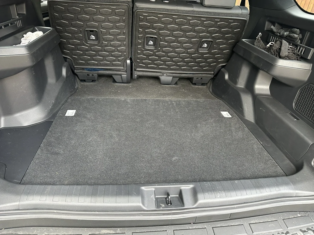

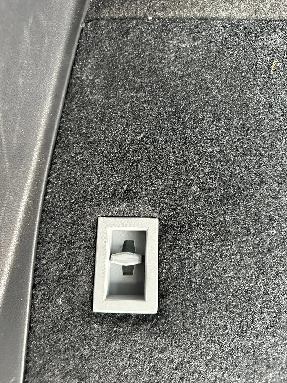

Here is what I did.
I replaced the tie down with a 3D printed insert. I then replaced the 3 clips on the board with some Velcro. It is nice to access this space. Thanks for creating this thread. I can keep a small socket set, pull strap, and jumper cables in there.

Here is what I did.
Can you share the link to the file? I’ll print this asap. Totally what we all need. Well done!!

Here is what I did.
This is Amazing! Can I bother you for the file too? We need to start a 3D print thread. We had one on the Bronco forum that wasn’t half bad.
demack6
Jan 3, 2026
Victoria
'25 4Runner
Here are the stl files.
I have included two files for the bracket. One with a simple hole and the other with a slot. The screw is okay if you print it horizontally. You may have to chase the threads with a die depending on your printer setup.
If you don't trust the screw, source one on amazon or get a wing-bolt and use the bracket with the hole.
