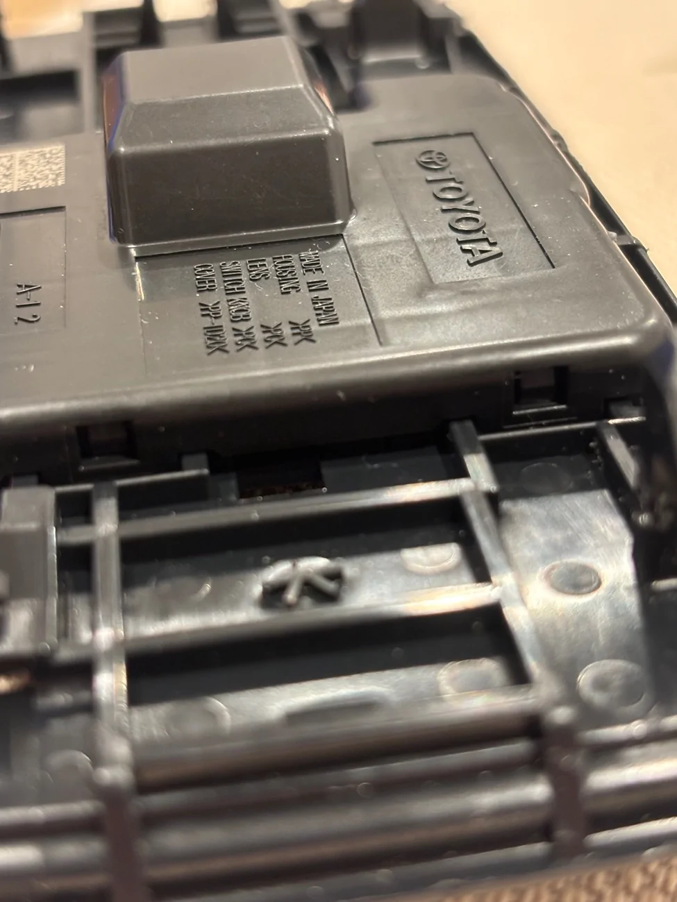

Unsure which plastic clips you are talking about. Is it these little square ones on the housing next to oem light plug?
Those clips are the ones you'll need to remove. Check out the video by Meso on how to remove it.
Ah dude thank you so much, i was trying to find this video and kept getting the map light one haha. Got it now thanks man

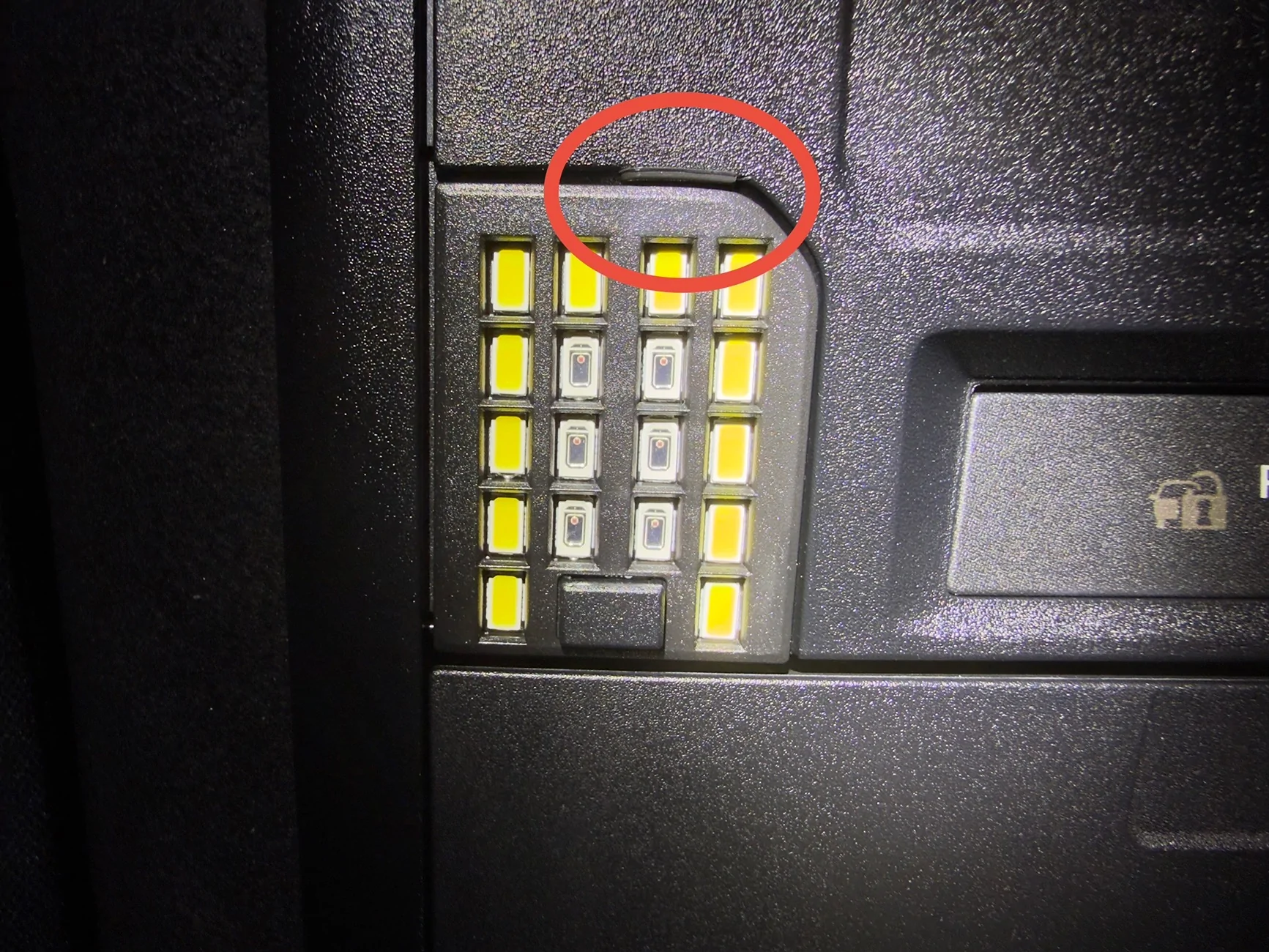

Just got these a couple days ago and installed them today. Overall install was easy. The dome light took about 5 minutes to replace and the map lights took about 15 minutes. Using a trim tool to assist in getting a firm grip on the overhead panel really helped get it out. I still did manage to break two of the bezel clips. For those who don’t want to drill, it’s definitely possible to route the wiring through existing holes. I didn’t drill any holes at all.
I am, however, having issues with the map lights not activating as expected. I’ve got mine set on “door” and the led module on the passenger side operates as expected, but the driver side doesn’t always come on when the door opens. I have to tap on the led module and then the light comes on.
When approaching the locked truck and using the key fob to unlock, once again, the passenger side comes on but the driver side does not.
I checked the connections several times and even took the whole thing back down and re-installed everything, but the same behavior persists. Any ideas?
Overall, the quality feels quite cheap for the price paid. But, they appear to be the only game in town for red LED replacements of the OEM interior lights
For anyone else who may run into this issue, the workaround that I settled on was cutting a small piece of plastic to use as a shim between the led module and the surrounding trim. I stumbled upon that by noticing that if I used something to wedge the led module tightly against the trim, the lights always worked as expected when flipping between “off”, “door”, and “on”, as well as when locking/unlocking the truck via key fob.
Not much of a solution, but at least the lights now work as expected.

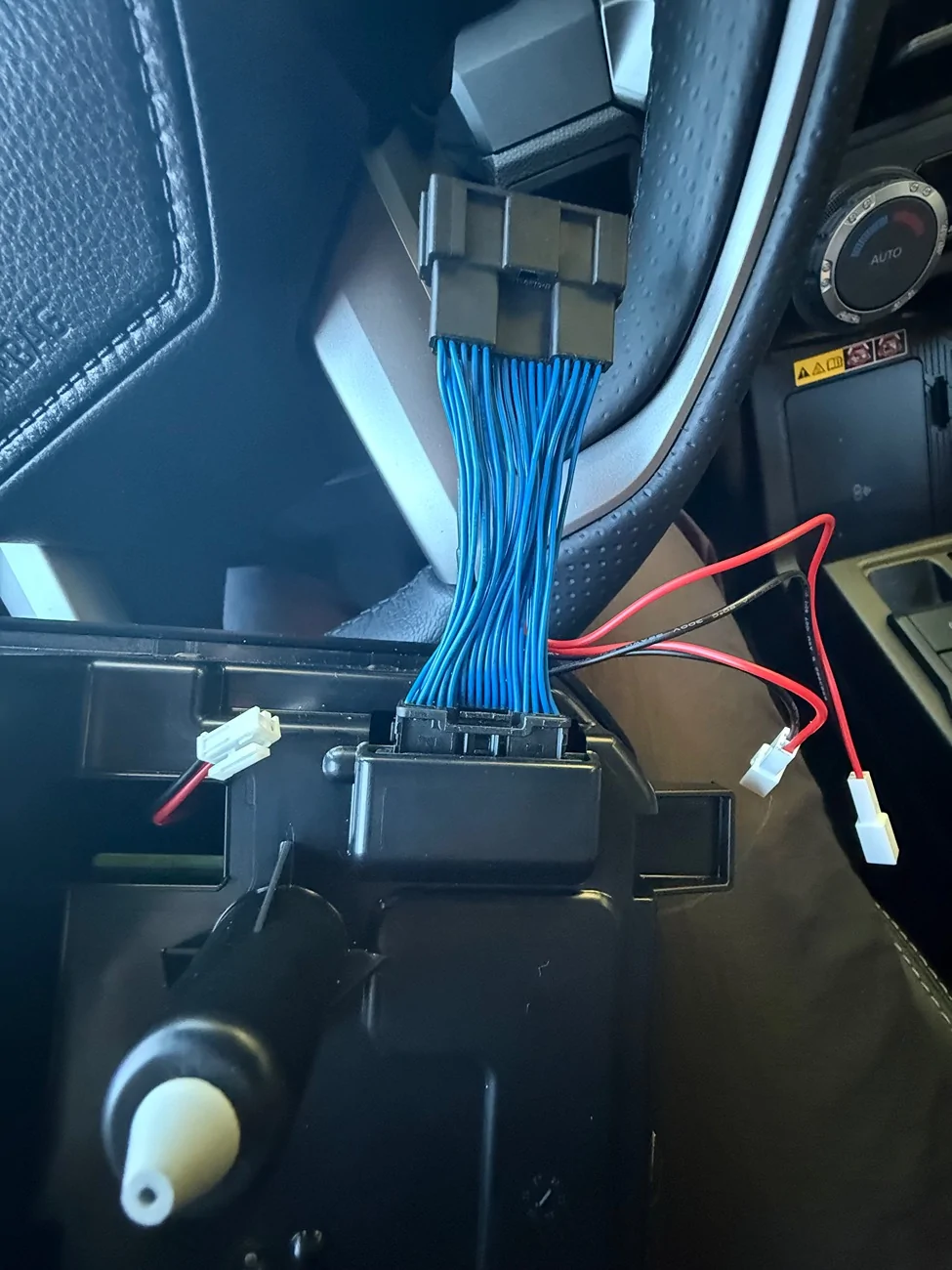

Install video here:
2025 2026 4runner 6th gen MESO Customs Switch-Back Interior Overhead Dome & Map Light Upgrade (White-Red Modes) IMG_4482
Quick question for you. Was this connector easy for you to insert during install?
As you can see in my photo, the connector on the Meso map light harness does not fully seat into the overhead console module. It stops short and never clicks or locks into place. I compared it directly to the OEM connector, and while it appears to be the same size and pin count, the OEM connector seats and clicks without issue.
I purchased the map lights listed for 2024+ Tacoma / 2025+ 4Runner on the Meso Customs website. I’ve confirmed the connector orientation is correct and even tested both directions to be safe. I’m hesitant to apply more force, as I don’t want to risk damaging the female connector on the vehicle side.
Just wanted to confirm whether this is expected and requires firm pressure, or if this may be a fitment issue with the harness.

I placed the unit on the table and with each index finger applied equal pressure to seat the harness.
Hope this helps?!
