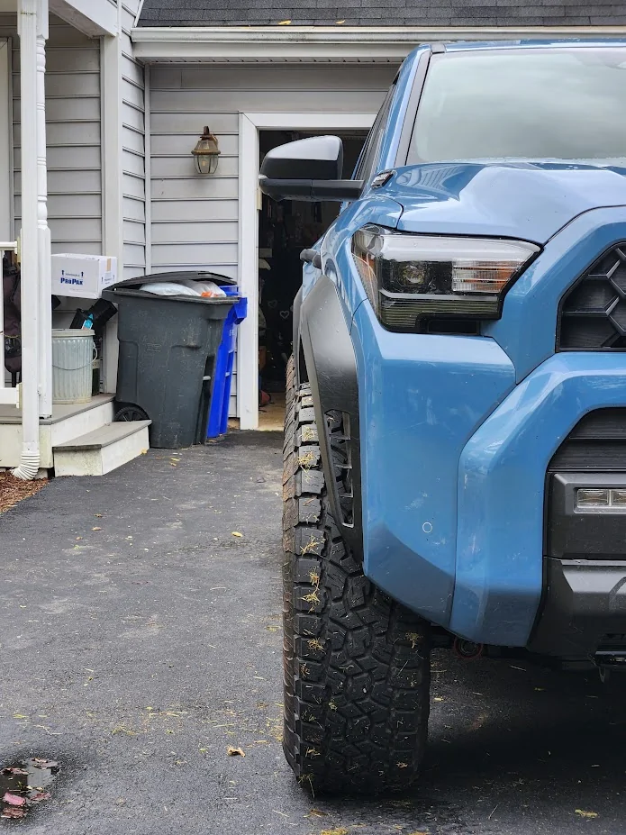

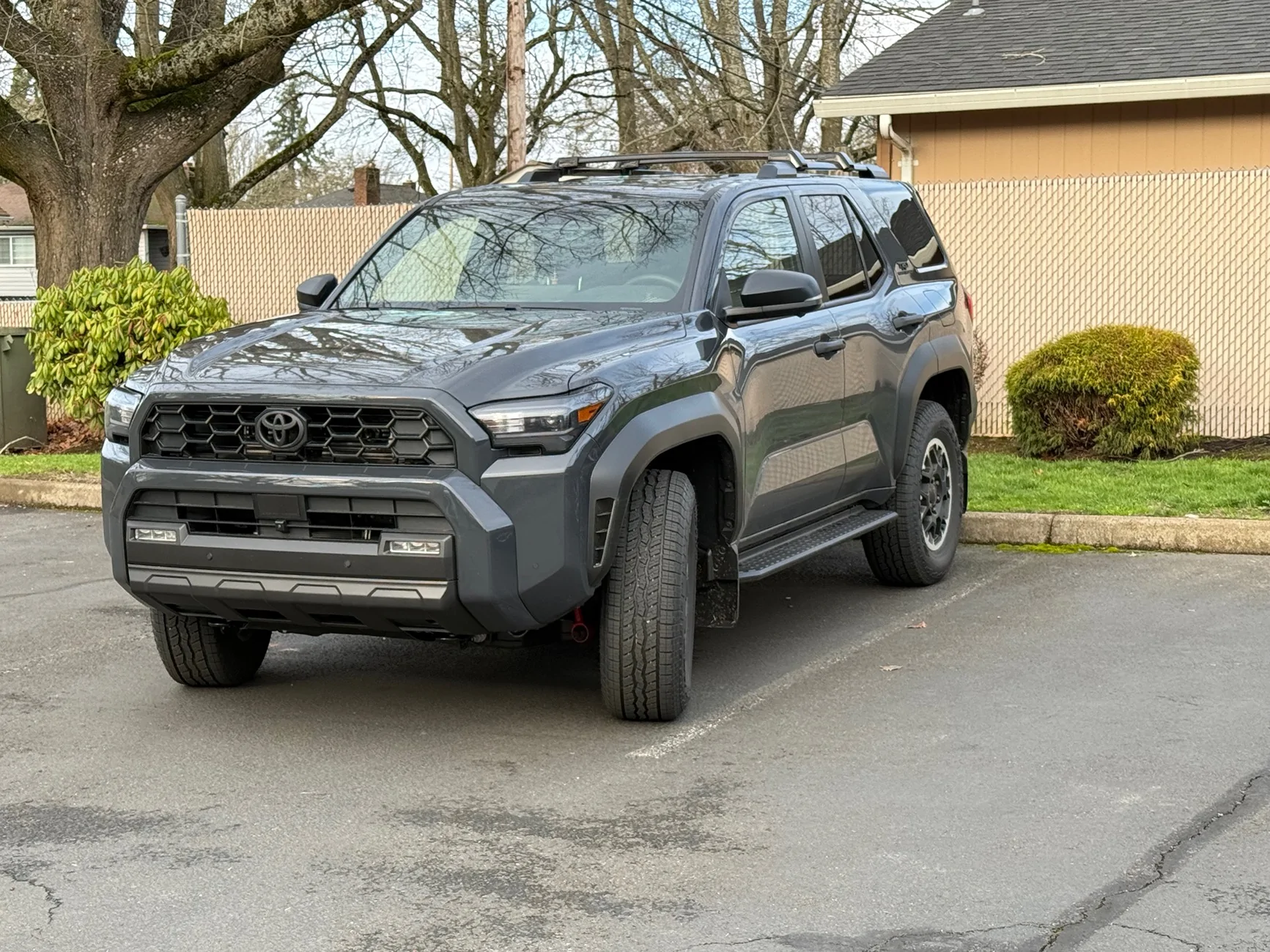

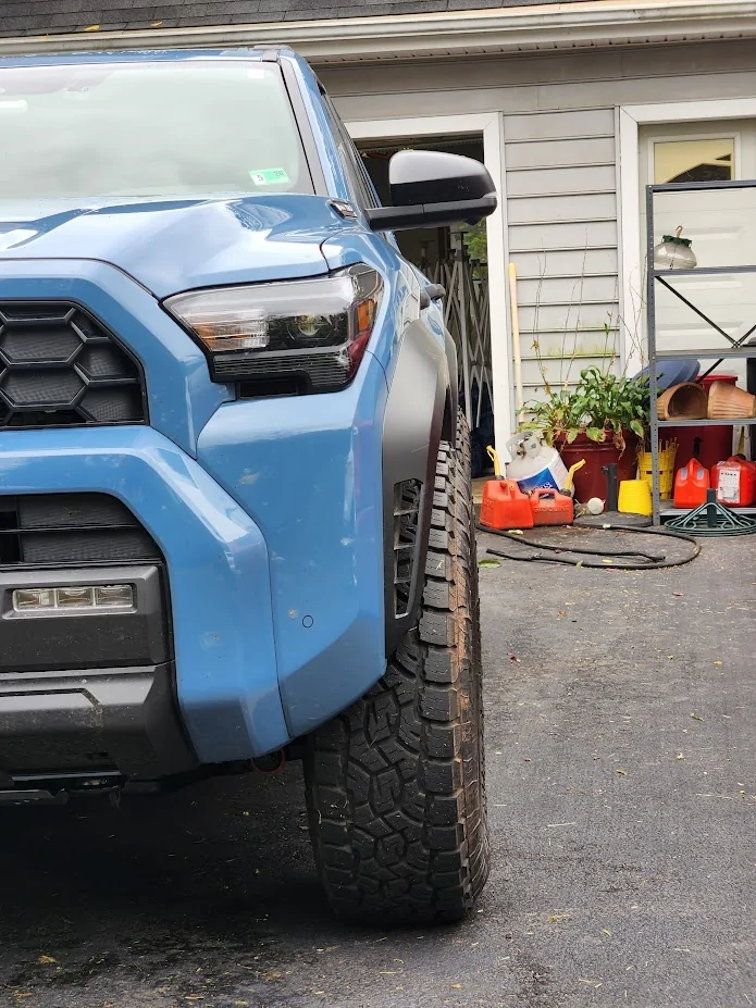

TRD ORP with 285/70/18 Toyo A/T III on TRD PRO (+20 Offset) wheels:
2025 2026 4runner 6th gen Looking for some poke references! 20251012_124315
2025 2026 4runner 6th gen Looking for some poke references! 20251012_124331
2025 2026 4runner 6th gen Looking for some poke references! 20251012_124355
Note: I've swapped these tires to TRD Flat Black option wheels (+45 offset) because the rear tires rubbed on the fender flare at full articulation off road - and I did not want to risk damage to tire or fender. So that poke is 1 inch less on current setup. (Strangely I've not yet photographed that)

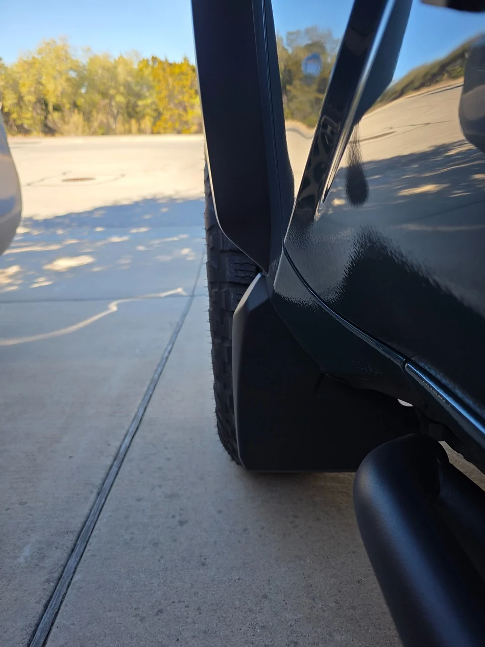

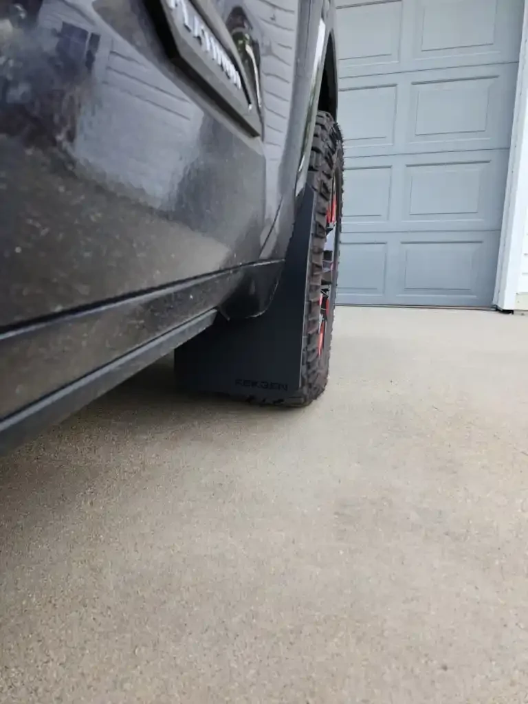

right now i am stuck with the oem mudflaps for this winter.
i will be looking into some rekgens that i used on the 23 tundra. not to fond of the rallye armor mudflap cost and from what i have seen of the ark's they dont thrill me either. so its going to be a costly venture to find the right set of mudflaps for my appeasement.
they worked perfrectly on the 23 tundra since i have the auto boards on the 23 tundra platinum as i do on the 4R platinum.
i went with the oem mudflaps on the 23 tundra and they sucked, so i tried the rekgens.
here is some pics of the 23 tundra oem flaps vs the rekgens i put on....

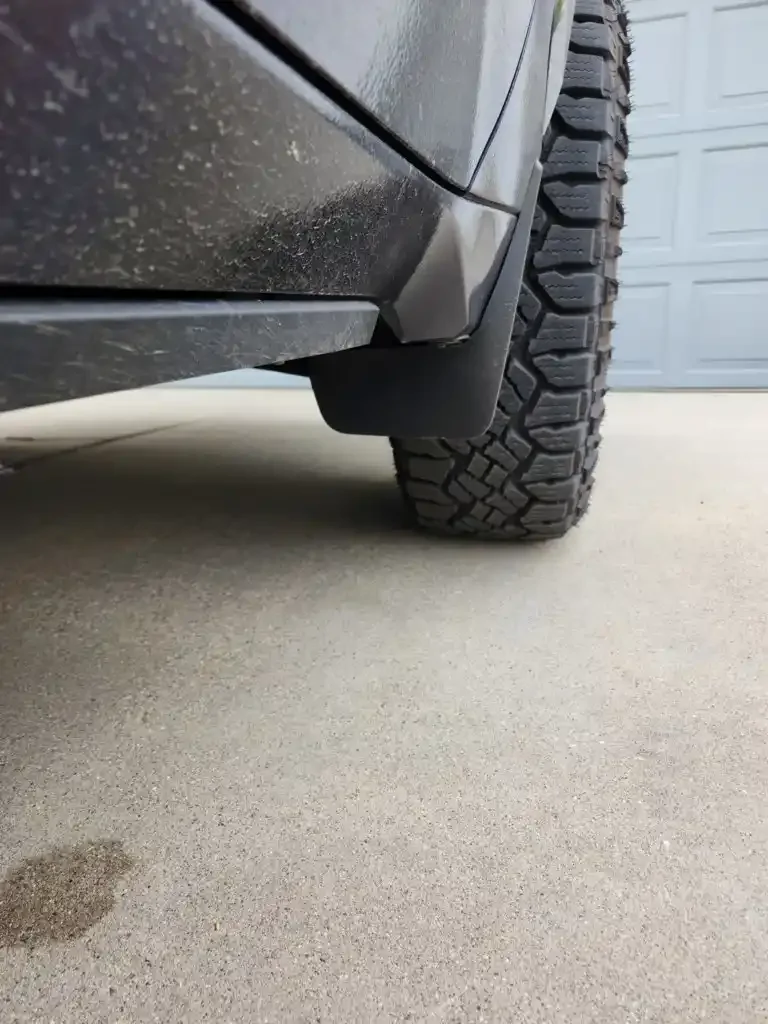

Fortunately, the TH flaps are a little wider than that.

Love to see this! Seems like the right amount of poke to me, but you’re right I’d hate to damage fender flares.
Two questions; Did you do any trimming or mods at all like crash bracket delete?
if not, do you think it would clear the fender flares with a minor amount of trimming?
Yes, with this setup (+20 offset wheels) the crash bracket rubbed, and it rubbed on felt and air dam tab in front. Removed the crash bracket and Was able to bend the tab up and push the felt back with heat gun to eliminate front rub, but when the rear tire rubbed on fender, I switched.
With +45 wheels the rub on the front is gone and I might be able to reinstall the crash bracket but haven't tried yet. Offset matters.
the width isnt the issue, its the outer coverage and height coverage. they dont extend out far enough to catch/deflect debris hitting rear passenger door kickout. also the oems down extend down far enough to mitigate the rearward splash to keep it below the bottom edge of the rear doors.

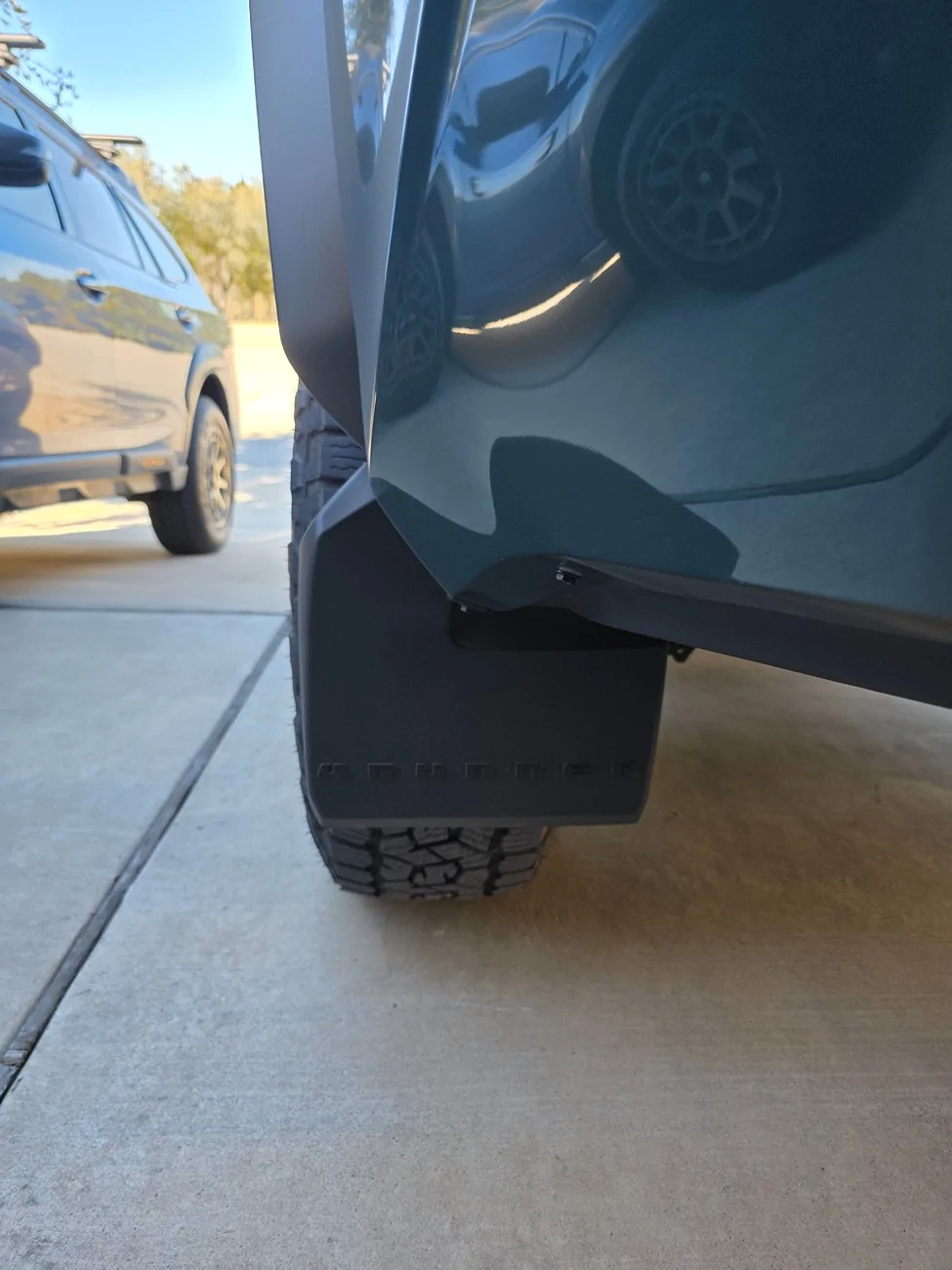

Hey JR. For what it's worth, I have the ARK flaps on my PRO and really like them. They are low profile and being that they are black, along with the Pro, they just seem to blend right in and I don't even notice them. Best of luck on your search!
