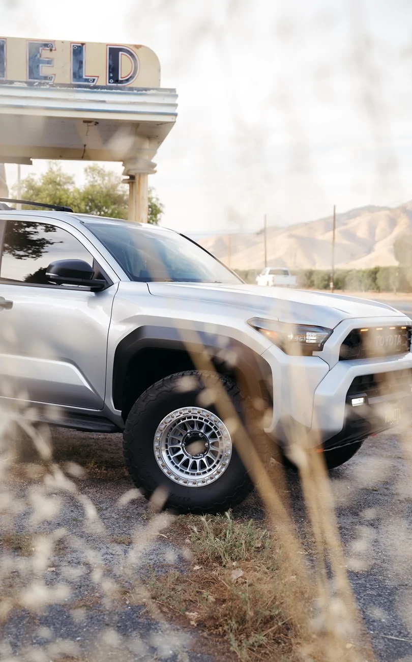

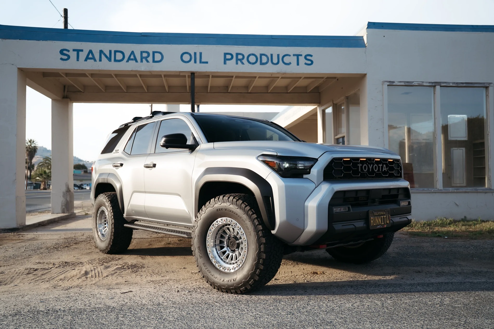

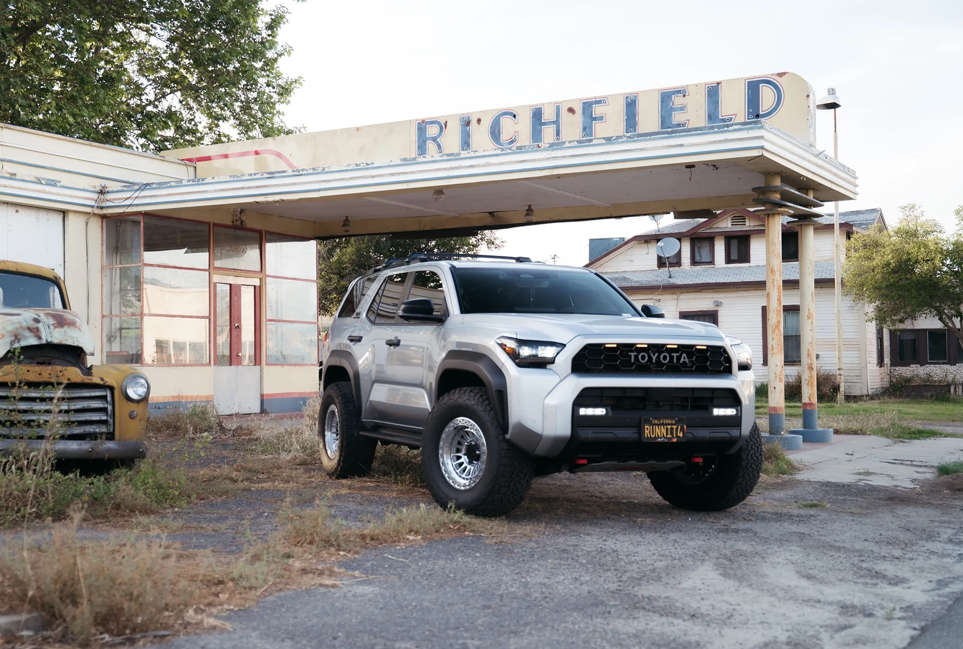

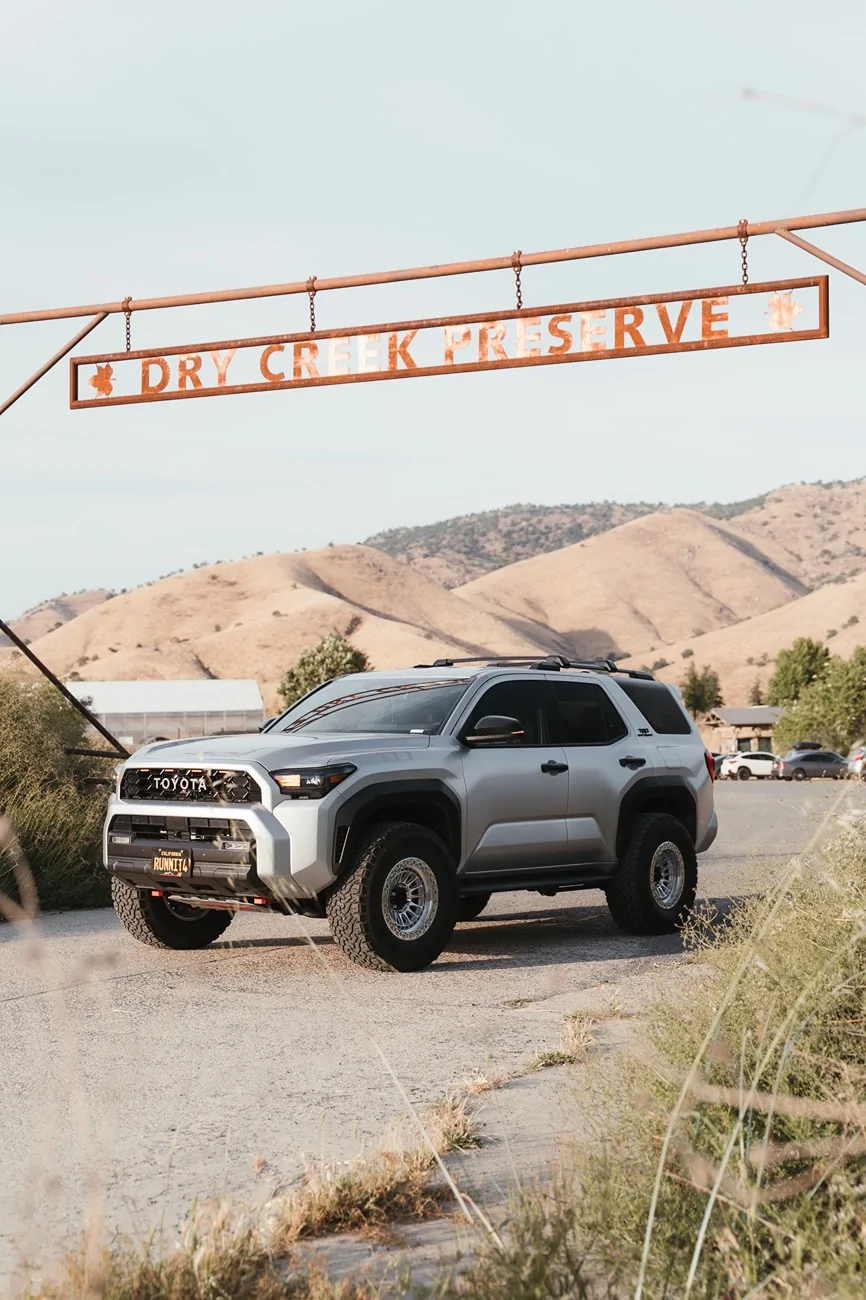

2025 4 runner off road premium
Lock Off-Road Mojave 17x9 ET 0 offset wheels
Wrapped in 35s - BFG KO2 315/70/17
Westcott leveling kit
Lasfit white DRLs
TRD skid plate and some red tow hooks to tie it all in
Had pretty noticeable rubbing, had to trim about an inch from the front bumper and push the fender liner forward. Had to take a chunk off the rear metal fender as well, but would definitely do it again.

When you say leveling kit, are you referring to the 1/2” front spacer?
