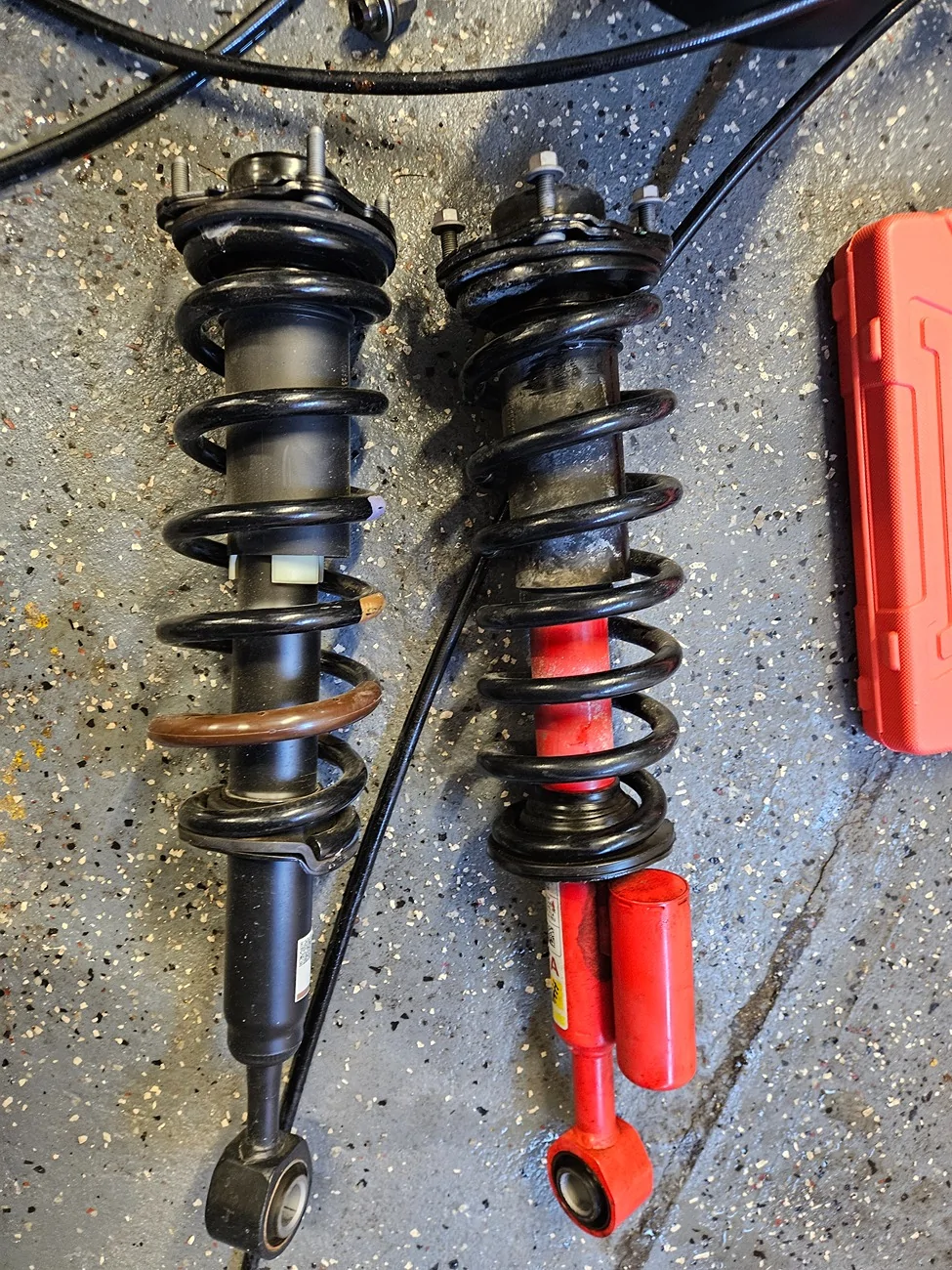

So I wanted to try a smoother shock option because the bilstiens have way too much compression. I like digressive rebound on shocks but it feels these are valves the same on compression making them rough on small bumps. I picked up some used Landcruiser shocks since theyre fairly cheap and supposedly rides better then every 4runner according to reviewers.

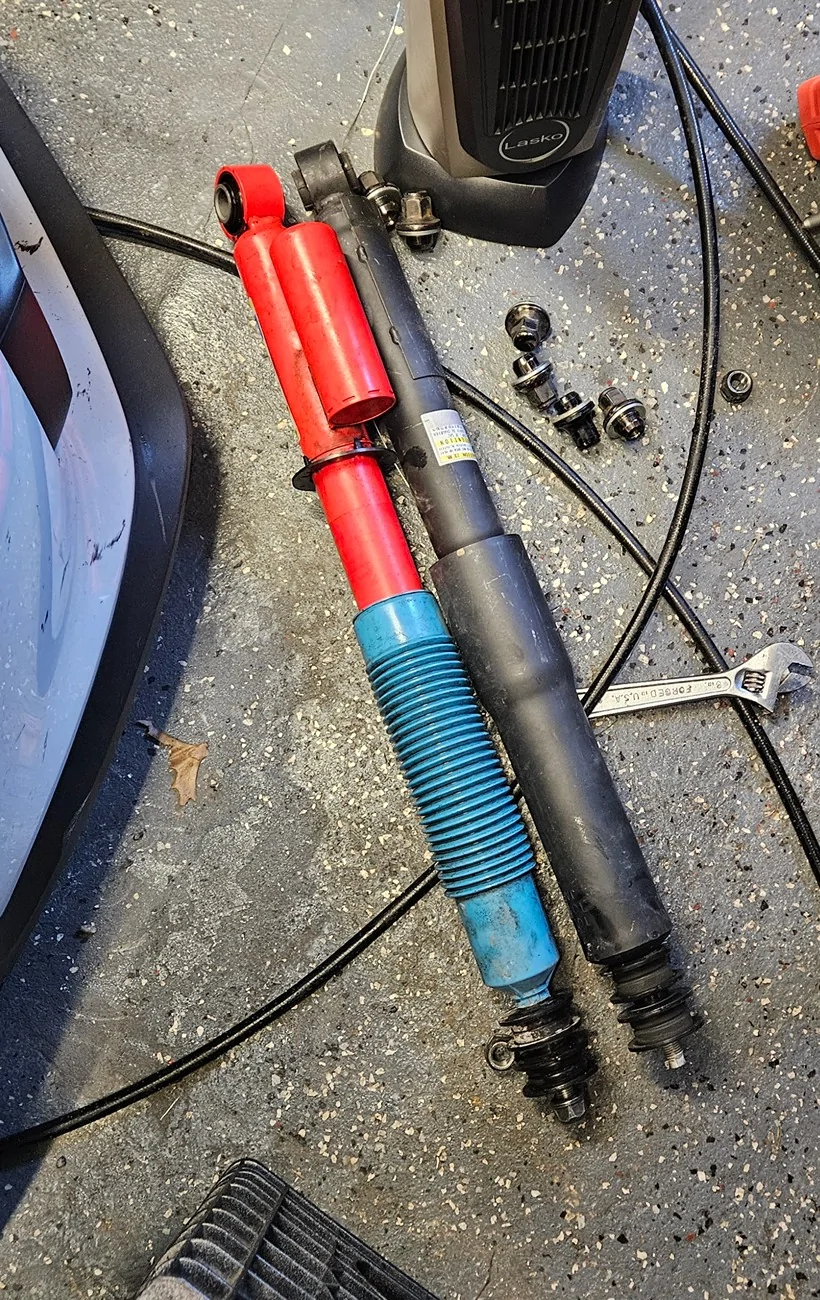

So far i can say, it's a trade off, They're notably softer that I can compress the rears easily by hand, the Bilstiens you need two hands pushing the shock into the the ground to get any movement. Length is the same front and rear.
Ride wise the LC tokicos cut the sharp edge of small bump but you medium and large bumps are much rougher, body roll is a tad more and the springs i have no idea. The front have one less coil and are a bit wider which would suggest a softer spring but thats also for a truck that only comes hybrid (~350lb) heavier vs non hybrid.
Over all it doesn't ride that much different and I'll have to see how it tows which I'd expect it to be worst but i may look into a revalving option for the bilstiens to ease its compression valve
2025 4runner 6th gen Land Cruiser shocks installed on 2025 4Runner TRD ORP 20260205_151102
2025 4runner 6th gen Land Cruiser shocks installed on 2025 4Runner TRD ORP 20260205_154438

Did you swap the springs as well? did you get any lift?

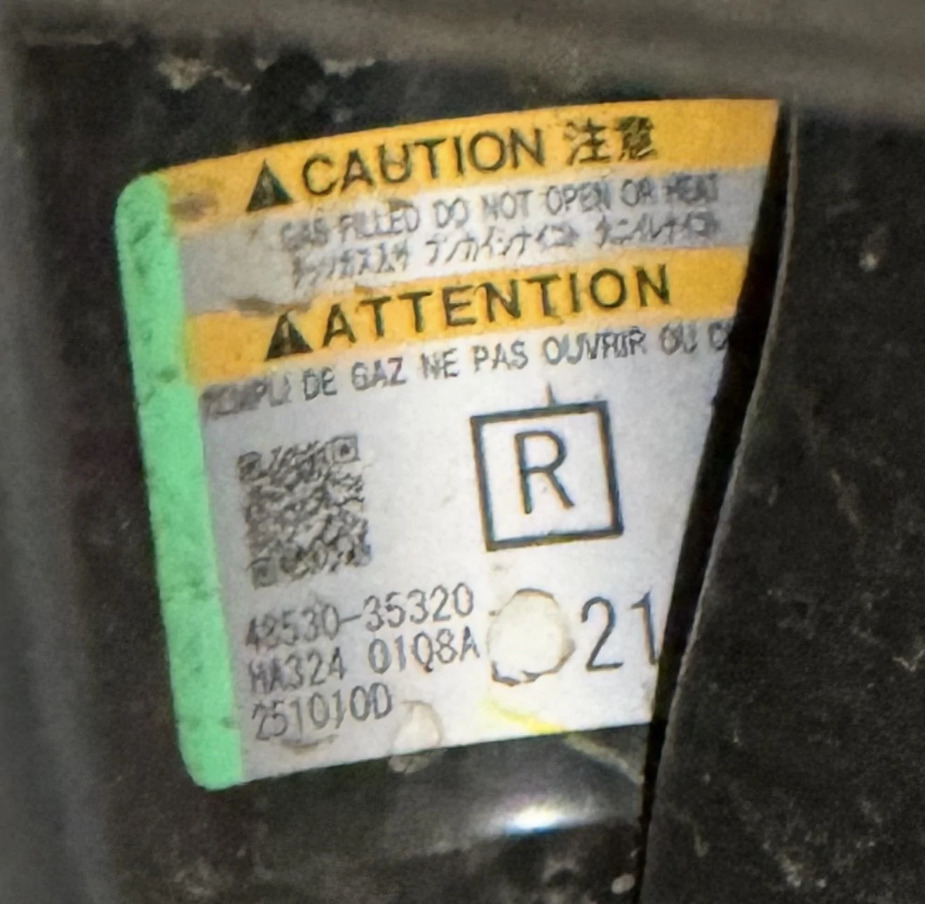

Those look a lot like the limited rears, which are also tokico. Only the front are AVS. I wonder how the Limited rears differ from the LC!
Here are pics of the labels on my rear shocks
2025 4runner 6th gen Land Cruiser shocks installed on 2025 4Runner TRD ORP IMG_0004
2025 4runner 6th gen Land Cruiser shocks installed on 2025 4Runner TRD ORP IMG_0003
I forgot to measure the bilstiens ride height but i still have a small rake so i bet its the same. I put the LC front springs on but did not change the rears so it is still trd orp rears.
I know the sr5 shocks are cheap or cheaper. But they do ride pretty smooth. Did you think about going that route? As far as finding some 6th gen SR5s used or buying new from Toyota?
Nah i wanted to go for the "luxury" model shocks that get the best word from reviewers and is on a truck more expensive then mine.
