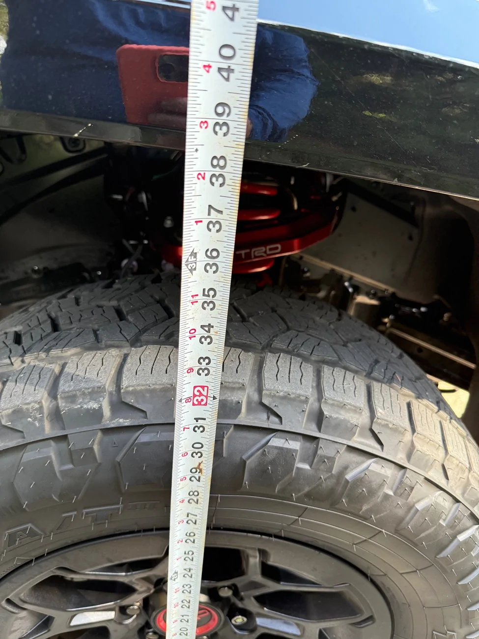

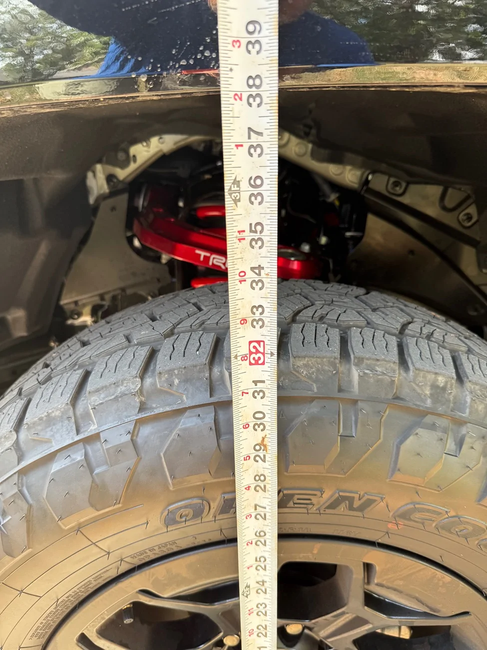

I have an '18 Pro w/17K miles that's bone stock other than a Wescot collar lift. I may upsize the tires at some point.
Hey Scrapp, are you getting any kind of vibration now that it's been lifted? Also, how is the nose dive in the front...has it been eliminated or reduced drastically?

So far 551 Miles in a month. The only mods so far have been the Wescott Designs Full Preload Collar Lift Kit and the Toyota Info Screen Protector.
I've gone off the reservation with numerous mods on our ORP . I'll post some photos of it and a list of mods sometime this weekend. I'm enjoying both vehicles and prefer the Pro, although our ORP is growing on me.

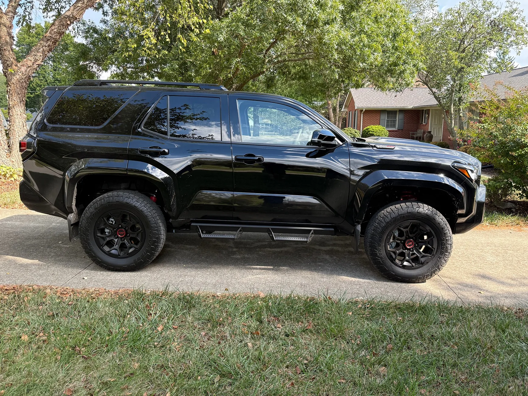

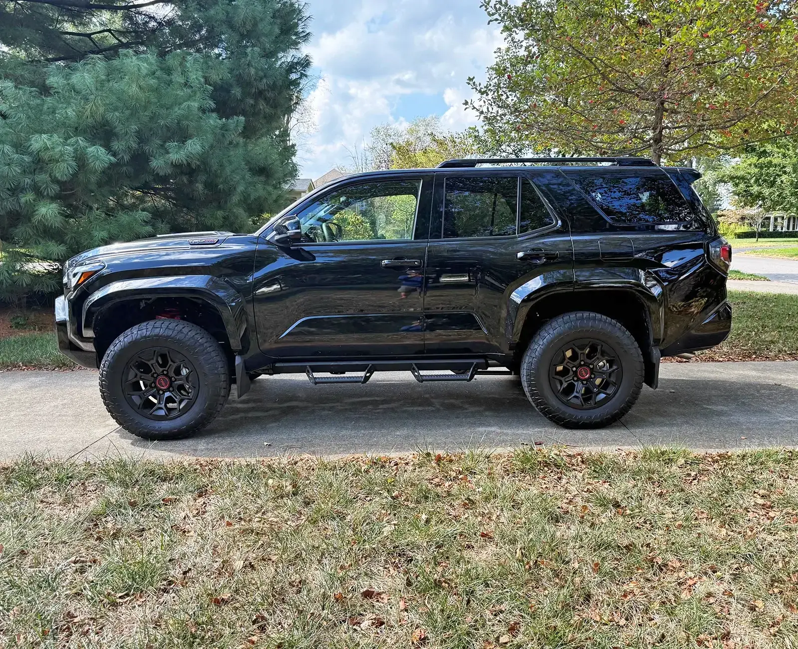

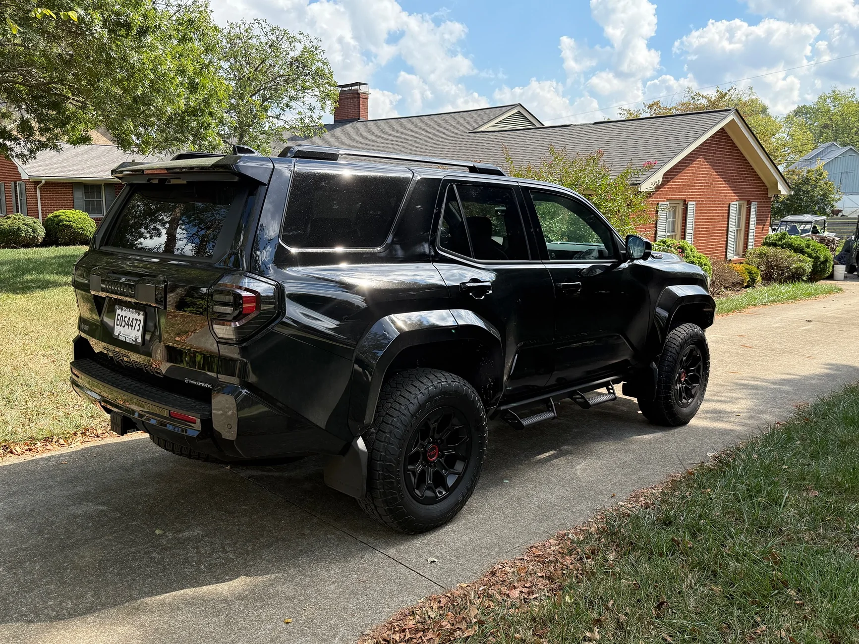

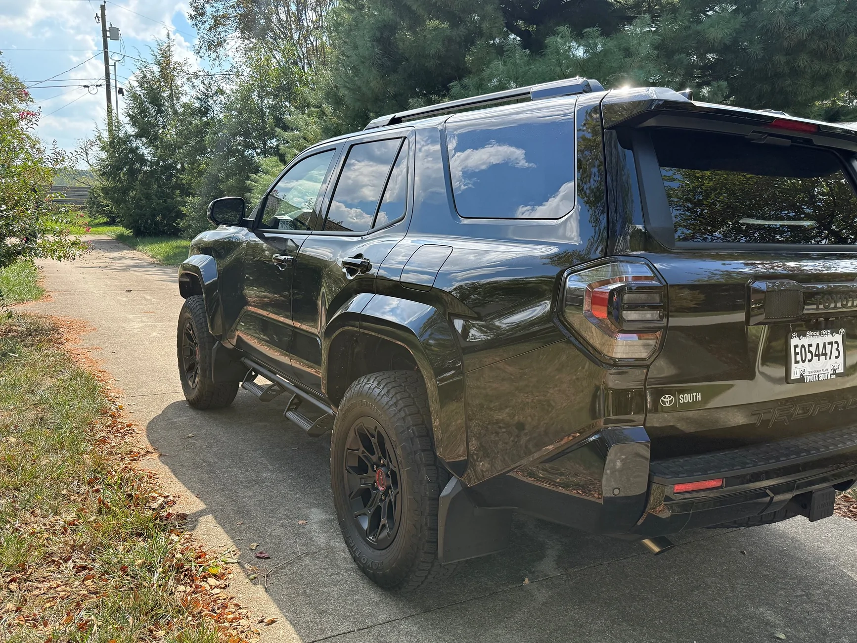

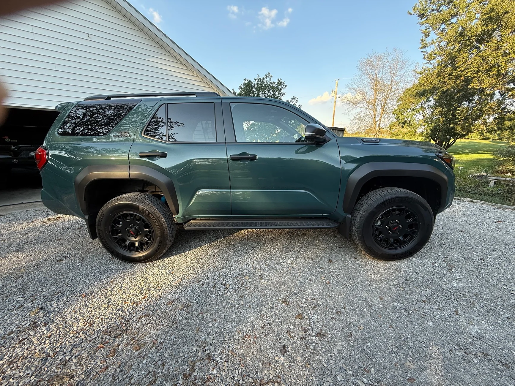

Here's a photo of our TRD OFF ROAD Premium with Westcott Kit. Lifting this vehicle and changing the wheels transformed this vehicle. Changing the Ugly wheels actually seemed to change the color of the paint. I wasn't crazy about the color but was vetoed. I really like it now

Thank you for these pics as well. Very helpful. Rig is looking good.
Did they install the full kit in the front (i.e. 1" top hat and collar)? I suspect they did because it looks like a full 2" lift. As I expected, It's perfectly level but for me it gives it the optical illusion of a reverse rake. If you indeed installed both the top hat and collar, then that answers my question.
I will be only installing the collar in the front.
Thank you!
Same

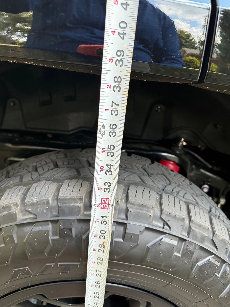

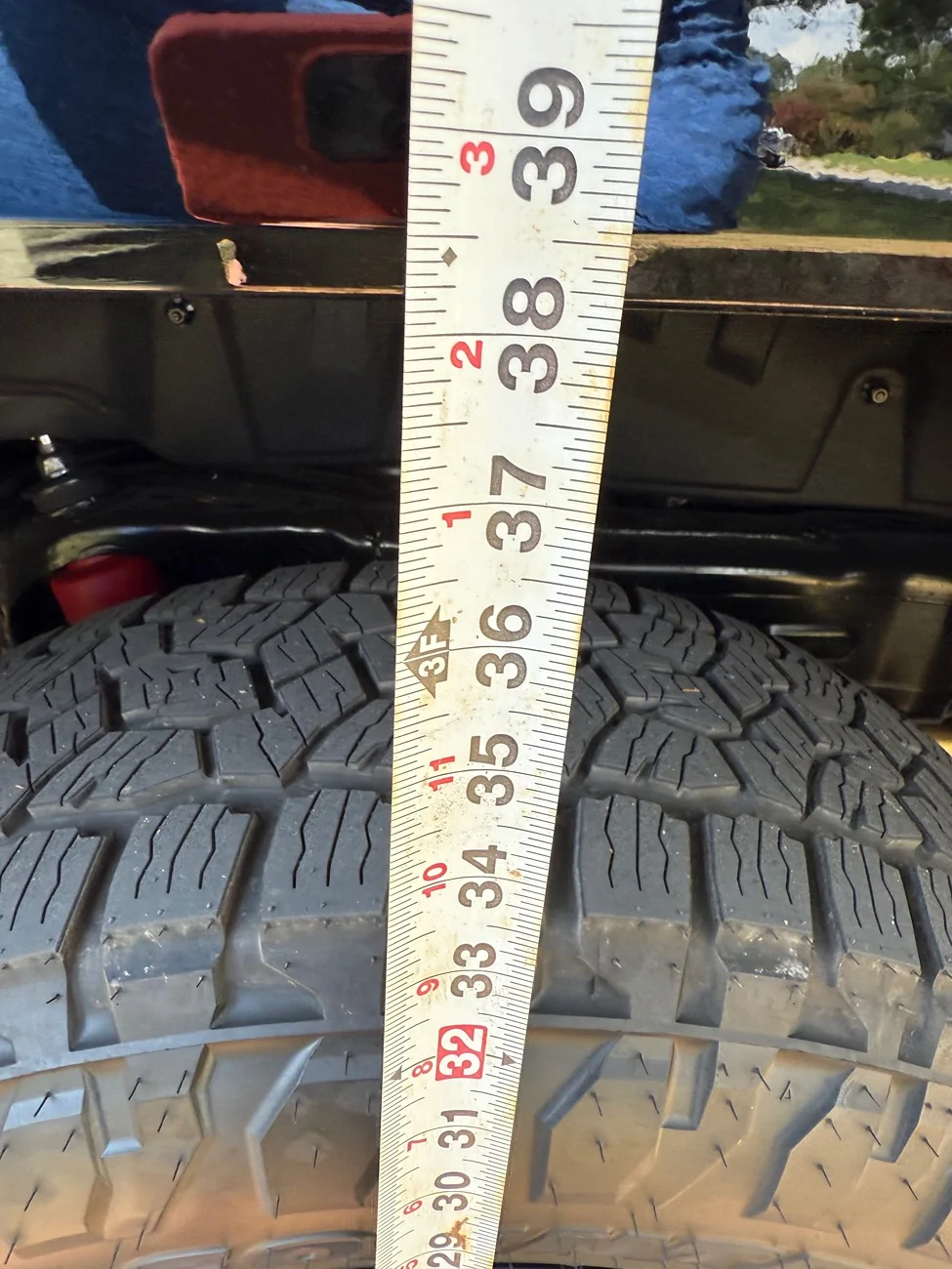

Papadap, I am with you with just installing the collars in the front and pucks in the rear especially with your larger tire set up. I know it will look great and give you the look and function you are going for. I have noticed on two Westscott YouTube installation videos (Tacoma & Land Cruiser) that they are installing the collars only on the front suspension with no top hats. I am surprised that WD is not offering a package that excludes the top hats. Maybe you will enspire them to do just that once you show us all what it looks like with the measurments. I assume that are not getting as many orders for the PRO and Trailhunter so possibly the R&D hasn't caught up with all of the other offerings from Toyota. I contacted WD to see if they would just sell the preload collars and pucks as a kit. Jason wants me to send them the measurements of my stock height, front and rear from hub center to wheel well to determine what components to get. I told him that it's for a 2025 TRD PRO 4Runner. I would think they should already know that information. No point in buying parts I don't want or need.
I spoke with Ty over the phone at WD and they told me I could not make an order without the top hat, sadly.
