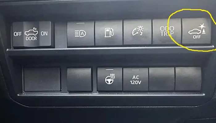

doesnt anyone know if any trim of the 4runner has this specific button circled ???
this is somewhat from our 23 tundra. i use this button to turn off the sensors for car wash and backing up.

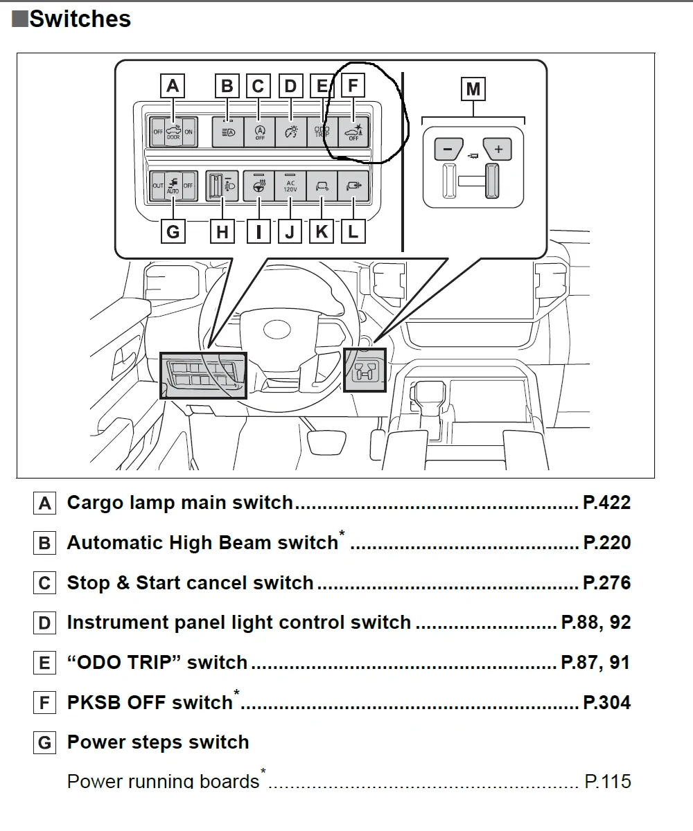

i guess they didnt enable this button in the 4R. looking thru the manual you can only do this via the multimedia head unit.
button doesnt exist in the 4R going thru all the button layouts in the manual.
at least in our non HV tundra there is a dedicated button for the PKSB to temp turn off.

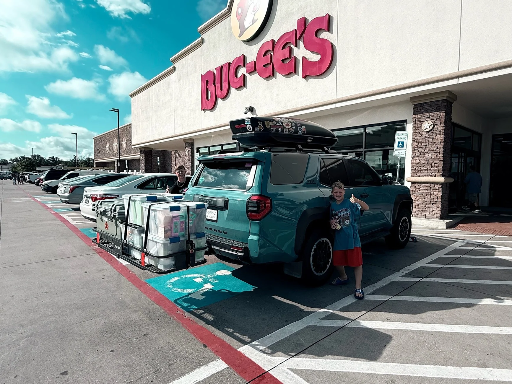

Nice! You can fit so many beaver nuggets in that roof box. How does that setup work for you so far? I'm contemplating a yakima or thule box, but afraid it'll get me 15 mpg on a 1k mile road trip...
I really like the Yakima it’s the Carbon 16, I want to say been using it 5 years now. Super easy to setup we put duffel bags with our clothes in it. Now. as far as how it affects mileage I really couldn’t tell you. We have a lot of factors going on as you can see from the picture. The rear cargo area is filled with camping gear, the hitch has the cooler and then containers with food and pots and pans, etc., in there. We are family of four. My boys are 13 and 11. So there’s a lot of weight Being moved. Driving from Dallas, Texas to Yosemite national Park and back this year we averaged about 16 1/2 miles per gallon. With the air dam removed in front.
