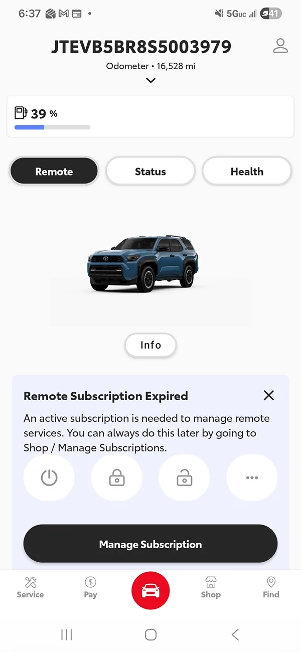

But I Believe that as long as you are subscribing to any of the Toyota Services you will be tracked, unless I'm missing something.
You don't need to be subscribed for some communication from vehicle to toyota. I let my subscriptions end after the year "free". The app still reports current odometer and %fuel in tank. (No longer reports distance to 'empty', but % fuel in tank is just as helpful. )

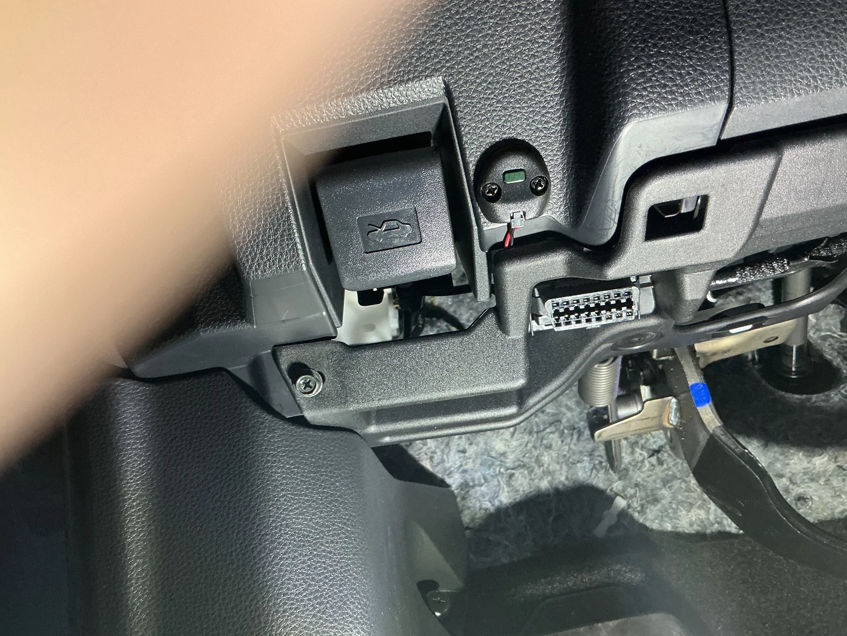

I tried to get under that dash to find that tracker but I’m too fat and old to bend that much. Will have to go to a stereo and alarm, shop to have them, remove it, but I did come across something else why I was under there. I have a suspicious button right next to my hood release. I’ll show a photo.
Wow! That's really interesting. That looks somewhat familiar to a friend's aftermarket tracker that was put on his car.

It also looks like your OBD port is black, should be white.
