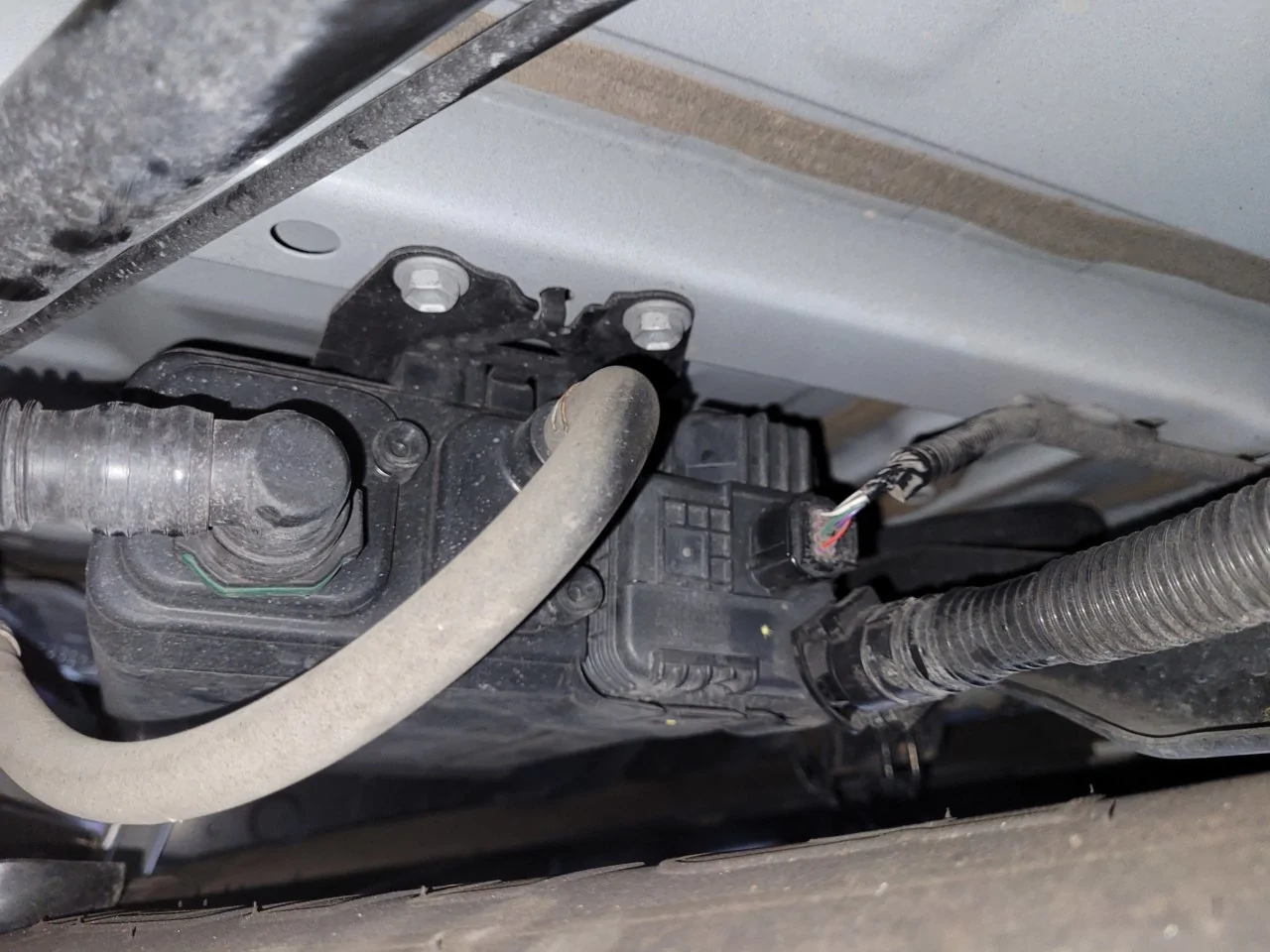

I think this is the culprit. Might be over the spare. Not sure how long the test should run but there are reports of them getting stuck on for hours.

Not knowing what effect this test actually has on components, what would happen if it ran excessively? My guess is no alarm. No code because it did not fail. Which is why no codes popped up at the dealer.
Could it cause fuel vapors?
