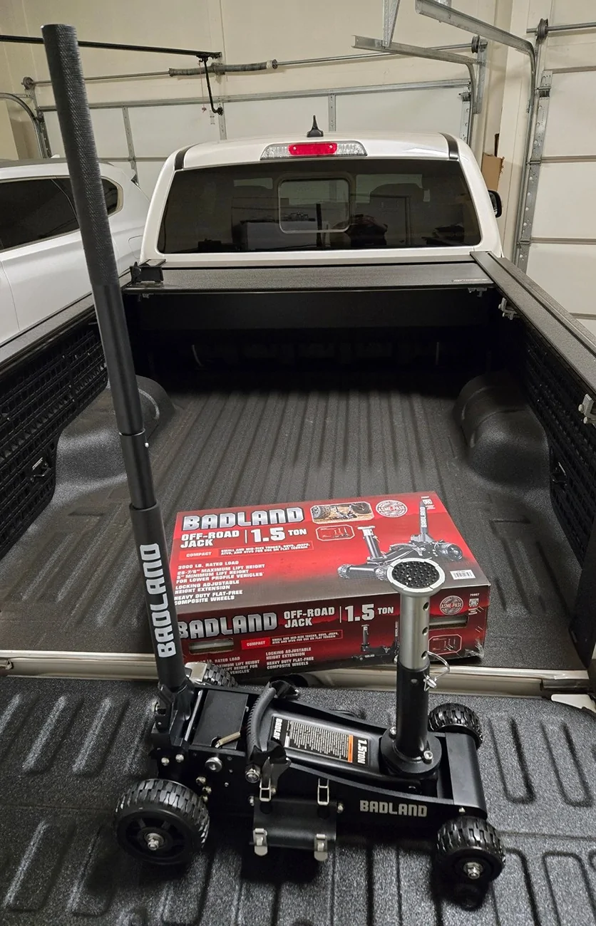

Here is one solution I’ve seen, the Badlands 1.5 ton jack:

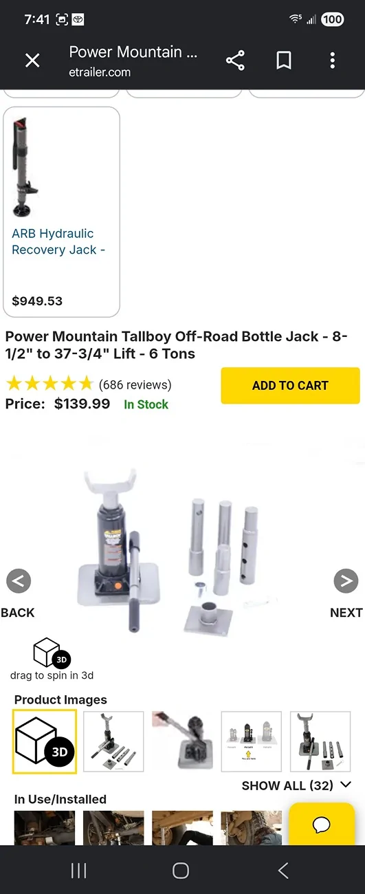

I personally would never use a emergency Jack with a lifted vehicle it's just too dangerous. These are very Stout strong and very reasonable and they come with all the accessories for a lifted vehicle. Disregard the image of the tall boy on top we're talking about the lower Jack with the accessories . The bottle jack . Hope this helps here's an attached picture.

Off-road jack is much safer and more capable.
2025 2026 4runner 6th gen Emergency Jack Acceptable with Lifted Vehicle? Badlands
Thanks for sharing, @Joe Dirt! I hadn't heard of this bottle jack before, doing research on what to get. Seems pretty solid and reasonably priced. How do you secure it so it doesn't fling itself unexpectedly? Thanks!
recovery boards make a good base for it.
