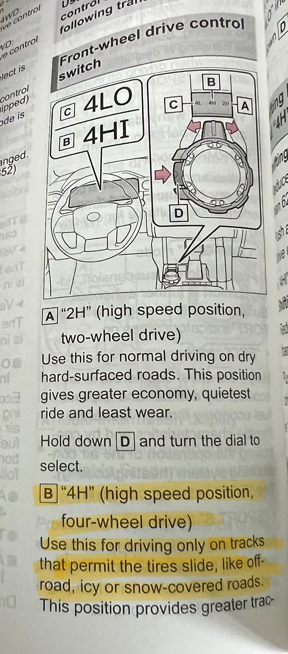

Use 4H only on roads that allows tires to slide. Never on dry pavement, unless you’re on a straight line.
Reference below is from the owner’s manual
