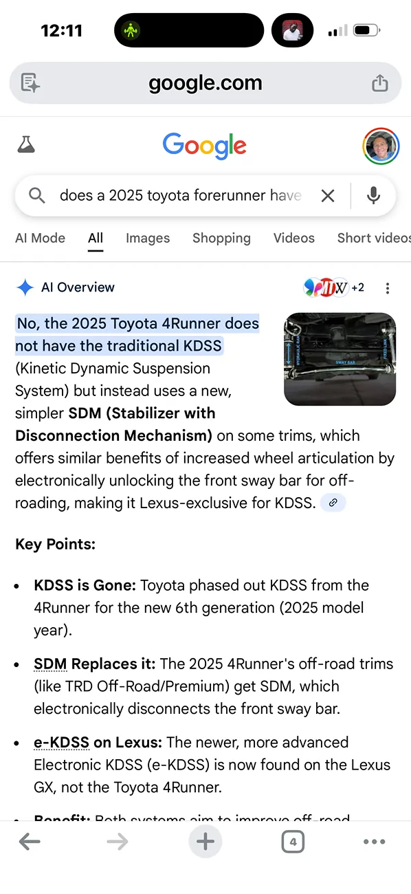

Got it. So do we have KDSS or not? I put a lift on mine and don’t feel any “sway”. In fact it feels more planted than before, especially with my new coils.

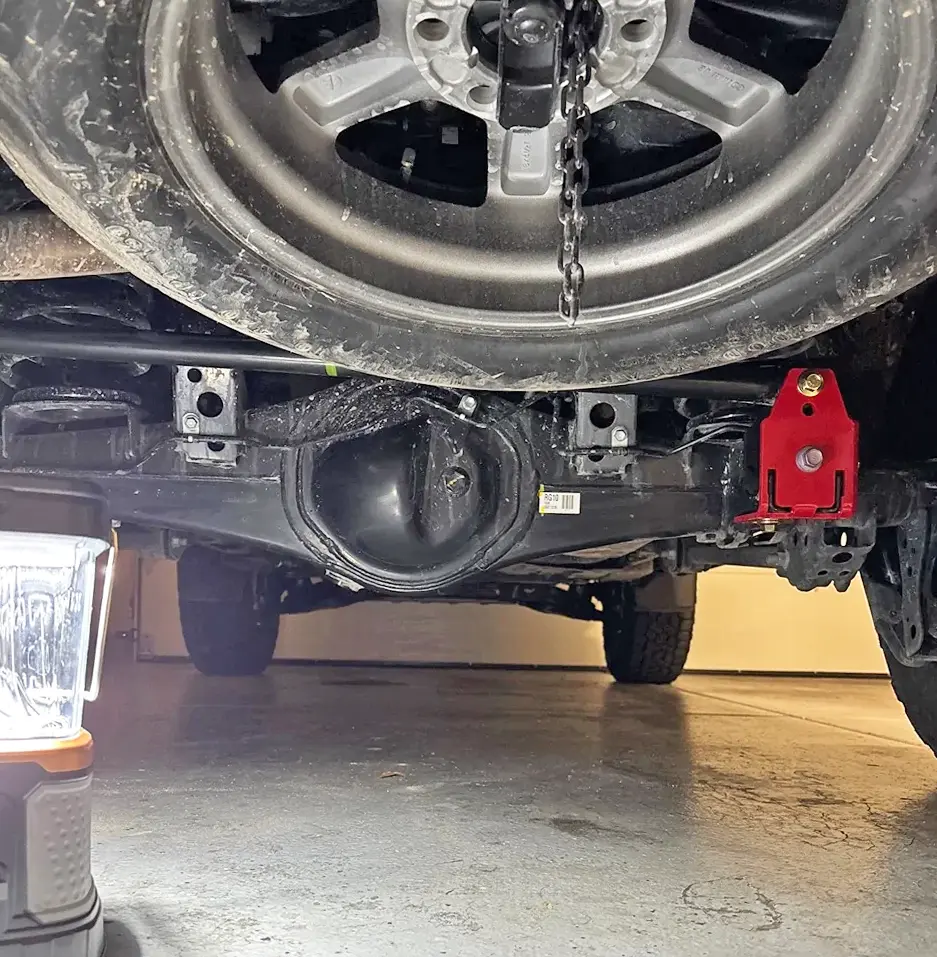

My sr5 doesn’t have KDSS and you’re only using spacers or lifting about 1 inch, you don’t really need this.
I lifted the rear about 2 inches, which throws off the panhard bar balance, so that’s why I installed it.

Before install, the panhard bar was angled (green arrow). After install, it’s level and balanced.

I think your confusion is with the brand name "Dr. KDSS" This bracket doesn't have anything to do with KDSS and is only a panhard bar correction kit.

I agree with you. A lot of people are confused by the brand name “Dr. KDSS.” This bracket actually has nothing to do with KDSS—it’s simply a panhard bar correction kit.

Ahhhh, now that makes sense.
