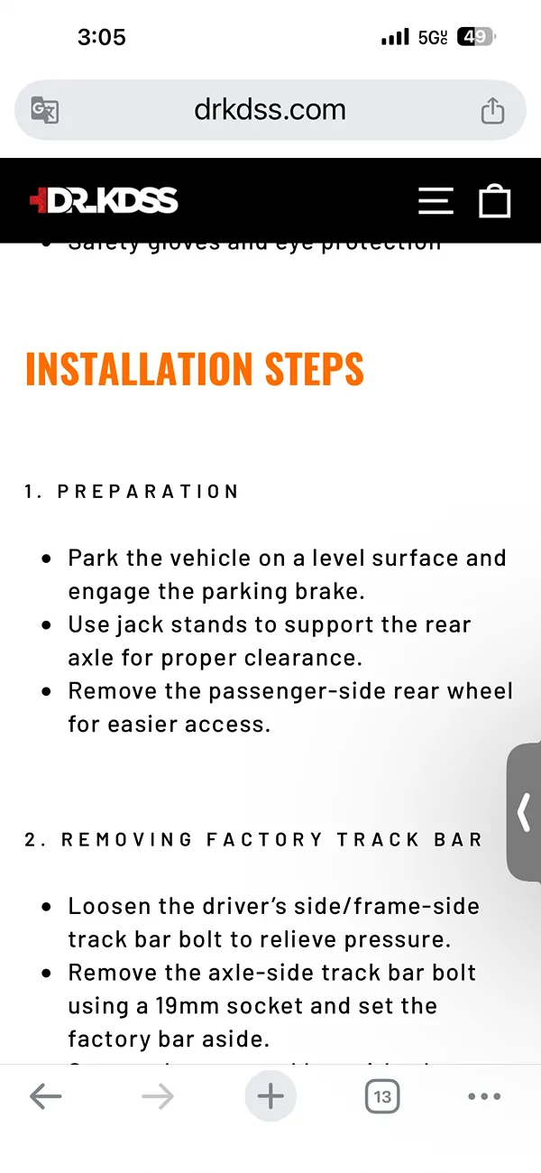

Hey, quick question for the install. I just ordered mine. Do you have to jack up the vehicle or will the track bar align even if it is not relieved of the weight?

You can check out Dr. KDSS’s website to see how to install it.
You don’t need to jack it up or remove the tires. Loosen the driver side, remove the passenger side, install the bracket, and tighten everything to spec.
