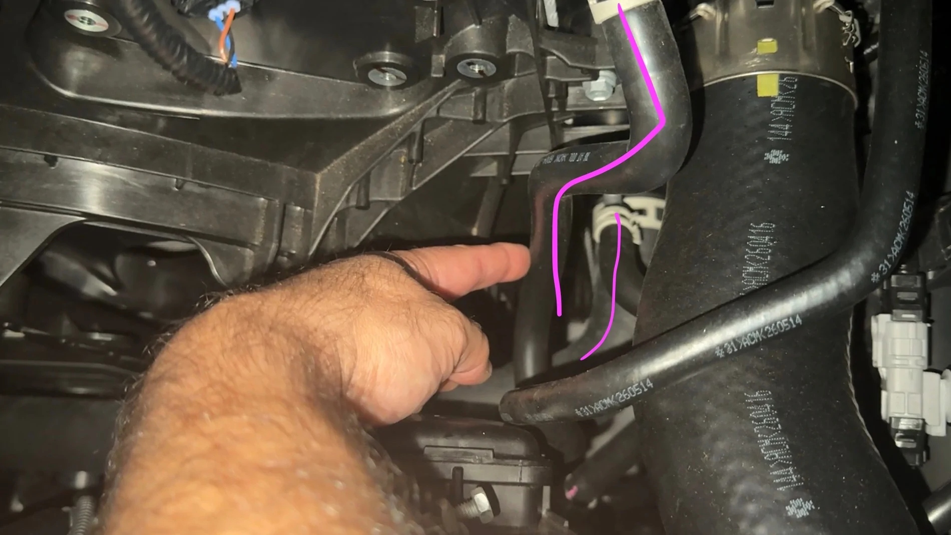

Mine
2025 2026 4runner 6th gen Does your 4Runner have a transmission thermostat? IMG_3360

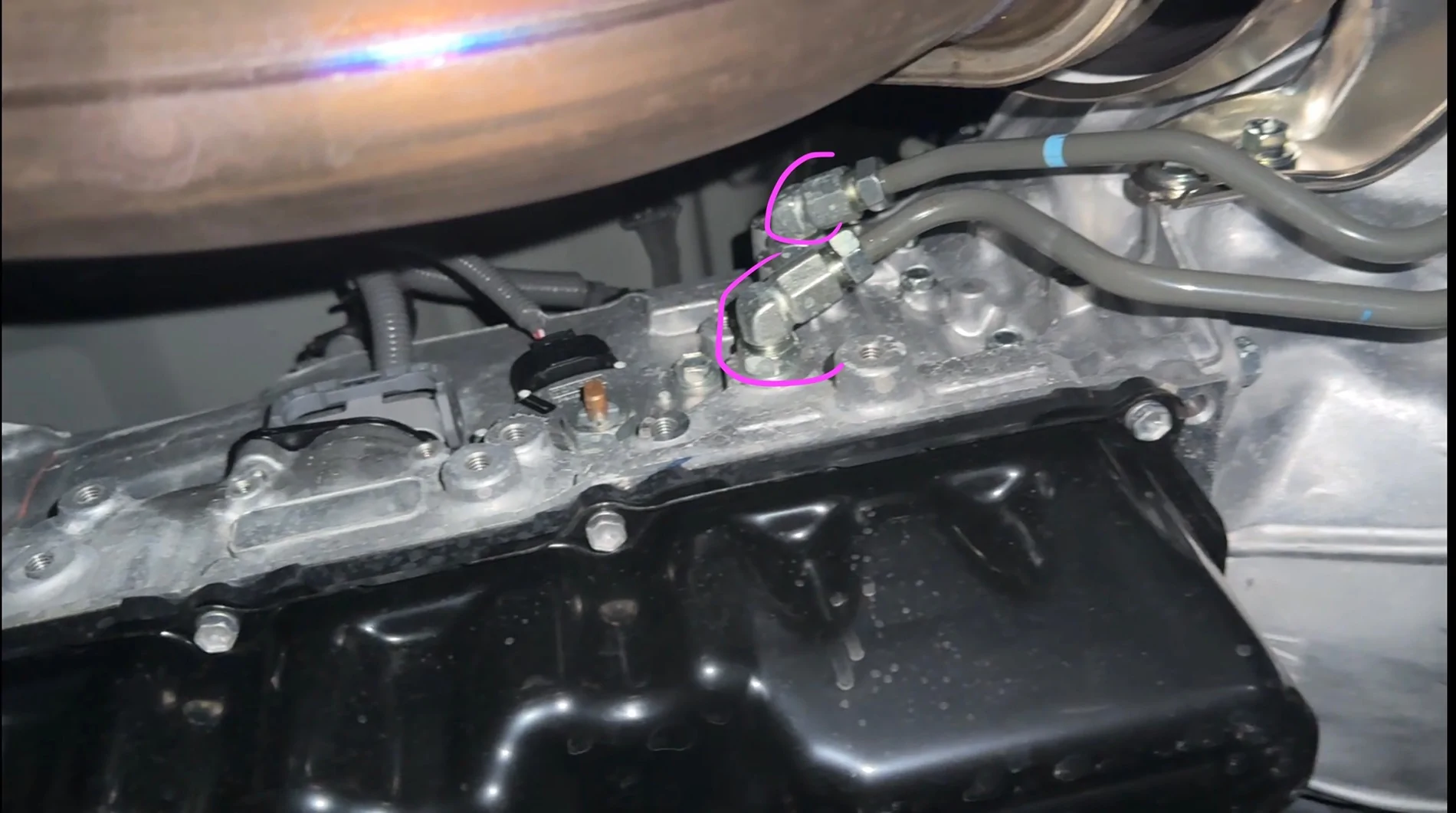

TRD OR
2025 2026 4runner 6th gen Does your 4Runner have a transmission thermostat? IMG_3361

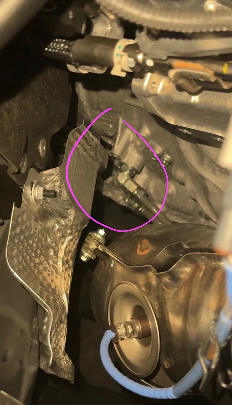

It would be amazing if I could get a few users to reply to this with their 6th gen 4runner model year and packages. And whether or not their truck has a transmission thermostat or not. This PDF outlines the 3 equipment types these 4runners can come with. My question is which models come with what parts?
My 2026 TRD ORP comes with the bottom option, "model with oil cooler assembly" and it doesn't have a thermostat.

The 2026 4wd non hybrid Limited my local dealership has, does have a thermostat. This is with the AWD T-case.
So right now I still have no idea which trucks get the thermostat and which get the sandwich cooler.
@Burgi do you remember if your SR5 had the sandwich plate cooler up by the radiator?
