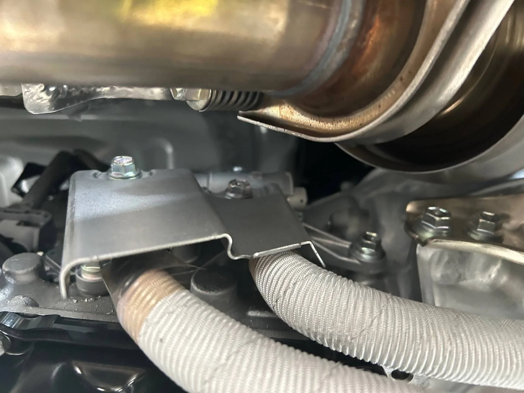

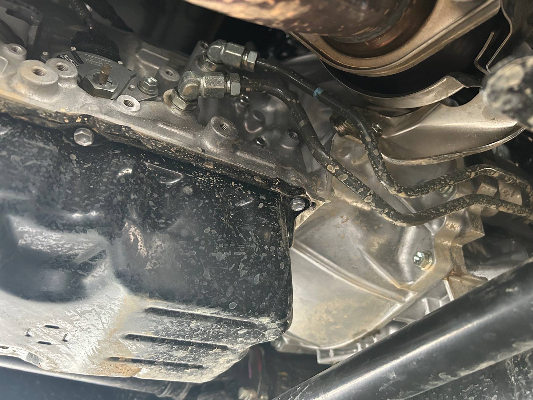

My transmission on my sr5 4x4 is absolute dog poop. Constantly slamming gears, jerks, bucks etc. I went to check the transmission fluid which requires you to pin the thermostat. I don’t have a thermostat. I went to the dealership and looked under a bunch of Tacomas and 4Runners and they all have transmission thermostats. The dealer didn’t have any sr5 models but I looked at TRD OR and a limited and they have thermostats. Did they forget to install one at the factory? Can anyone with a 4x4 sr5 take a look at theirs? Thank you
Mine
2025 2026 4runner 6th gen Does your 4Runner have a transmission thermostat? IMG_3360
TRD OR
2025 2026 4runner 6th gen Does your 4Runner have a transmission thermostat? IMG_3361

thanks for the reply. I looked all through the cooling system and can’t find one anywhere. I do not have an extra cooler either. All I have are the radiator and an intercooler for the turbo.

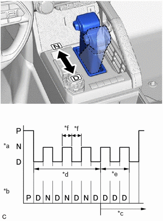

what do you mean pin the thermostat ?
if you want to check fluid level there is a start/shift procedure and the system will let you know when the fluid is warm enough but NOT 113degF or higher. if higher than 113F you cannot accurately set the level need to let it cool down and start over
toyota suggests you start at 68degF (cold basically) then if you do the below the D indicator will let you know when you can check the level with the standpipe in the drain plug hole
ADJUST AUTOMATIC TRANSMISSION FLUID TEMPERATURE (when Not Using the GTS)
NOTICE:
  • Make sure to switch to automatic transmission fluid temperature detection mode within 60 seconds after starting the engine.
  • At the automatic transmission fluid temperature detection mode, the D shift indicator illuminates for 5 seconds before it flashes when moving the shift lever to P or N if it is an appropriate temperature or higher.D Shift Indicator at Automatic Transmission Fluid Temperature Detection Mode
    Below Automatic Transmission Fluid Level Adjustment TemperatureAutomatic Transmission Fluid Level Adjustment TemperatureAbove Automatic Transmission Fluid Level Adjustment Temperature
    (GTS Display Temperature)
    35°C or less
    (95°F or less)
    35 to 45°C
    (95 to 113°F)
    45°C or more
    (113°F or more)
    D Shift IndicatorOFFONBlinks
again, a drain and fill is done cold. you only need it barely warmed up under certain
circumstances. if you drain more than 50% the fluid you need a TON more done
How to get into fluid temperature detection mode ? a shifter dance
(a) Turn the ignition switch off. [#2]
(b) Depress and hold the brake pedal.
(c) Start the engine.
NOTICE:
To reduce load, make sure that all electrical systems, such as the air conditioning and audio system are off.
(d) Slowly move the shift lever from P to S, from S to 1st, and then back to P.
HINT:
  • Keep the shift position in each position for approximately 3 seconds.
  • Slowly move the shift lever to circulate the automatic transmission fluid through each part of the automatic transmission assembly.
  • (e) From the shift position in D, move the shift lever between N and D within 1.5 seconds for 12 seconds or more continuously to switch to automatic transmission fluid temperature detection mode.
    NOTICE:
    Do not pause for more than 1.5 seconds.
    HINT:
    The automatic transmission fluid temperature detection mode will be activated by moving the shift lever between N and D within 1.5 seconds for 12 seconds or more continuously.
    2025 2026 4runner 6th gen Does your 4Runner have a transmission thermostat? 36666-fe49066d8684fd90f5fc0026182afe1b
    *aShift Position
    *bIndication of Shift Position
    *cAutomatic Transmission Fluid Temperature Detection Mode
    *d12 sec. or more
    *e2 sec.
    *fLess than 1.5 sec.
    (f) Check that the D shift indicator comes on for 2 seconds and then turns off.
