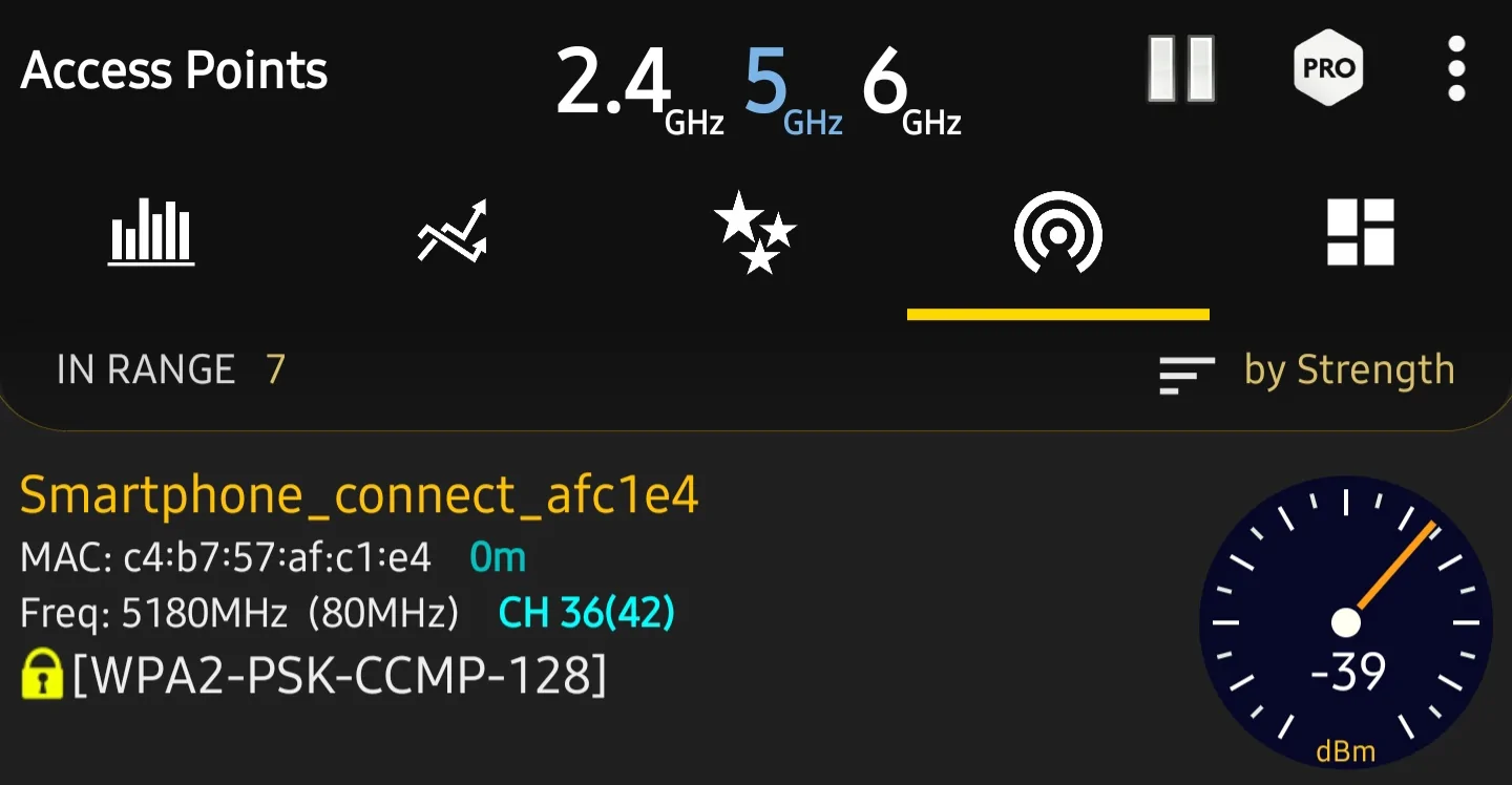

So, tested tonight on the way home and even using the built in Toyota maps while having Audible running on Android Auto, it skipped coming into town as I passed the radio tower.
I ran a wifi analyzer and it looks like the connection to the car is running on the 5GHz band on channel 36.

The tower thing is odd, because it is also not every tower I pass. I tried scanning for signals slowly this morning as I passed the one that does cause issues and my phone didn't pick anything up from the tower to give me any indicators. Android Auto was still using the same channel 36.
