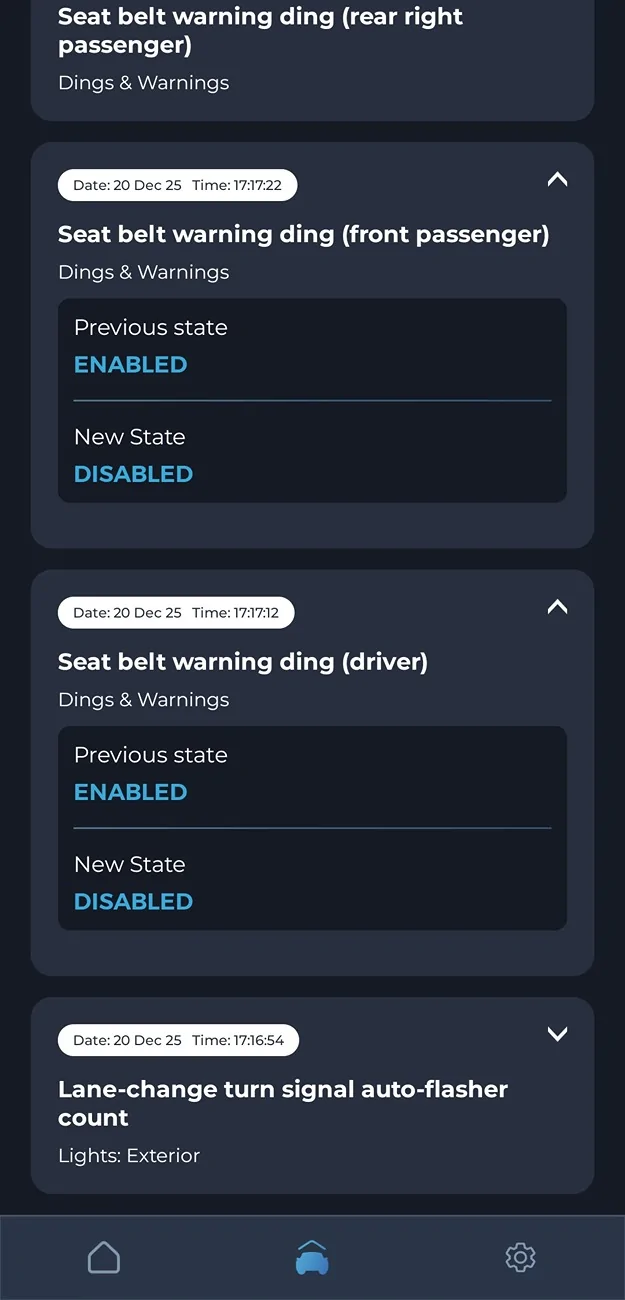

i was able to change the turn signal flash to 7 from default of 3 but unfortunately i couldnt change the seat buzzer settings on the 2026.

I bought my 2026 in late 2025 and did the Carista mod (as per the timestamp in my screenshot). 11/25 is the build date.

26 SR5 with June build date - all applicable options are enabled. Disabled the rear and passenger dings as my backpack doesn't need a seat belt :)

so from what i have gathered, builds before july-2026 dont have the seat buzzer option in carista
mine was july 2026 but the june 2026 person has the seat buzzer option and nov-2025 has it also
I just have these two for that menu.

so far i have anything with a build date before july-2026 you can still turn off the seat buzzer
mine was in july-2026 and i cannot.
