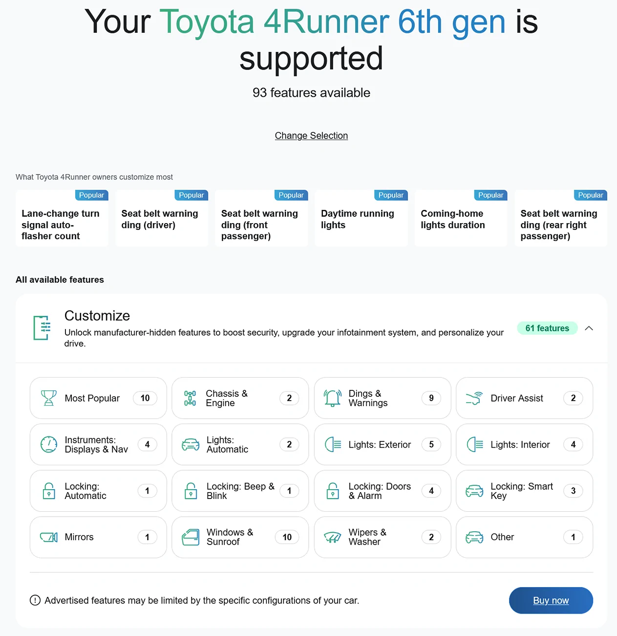

thanks for the report. its weird since you do a lookup on the website for supported vehicles and it shows 9 entries on dings and warnings for the 4runner but they dont show up in the app when i use the carista odb adapter. but ifi use the same adapter and walk over to my 25 4runner platinum they all show up.
on the 26 4runner platinum only 2 options show up and not the other 7 for seat belts.

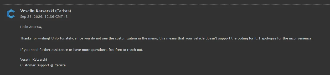

This is what I got back from them regarding the seatbelt dings after submitting my report from the app.
2025 2026 4runner 6th gen Carista Options / Settings for 2025+ 4Runner 6th Gen (screenshots) 1790205161710-0d
thats bs, my 25 shows all 9 options in the app but the 26 only shows 2 options but the website shows 9 options for the 6th gen 4runner.
there was no hardware change between the 25 and 26 MY 4runners.
2025 2026 4runner 6th gen Carista Options / Settings for 2025+ 4Runner 6th Gen (screenshots) 1790206140522-2f

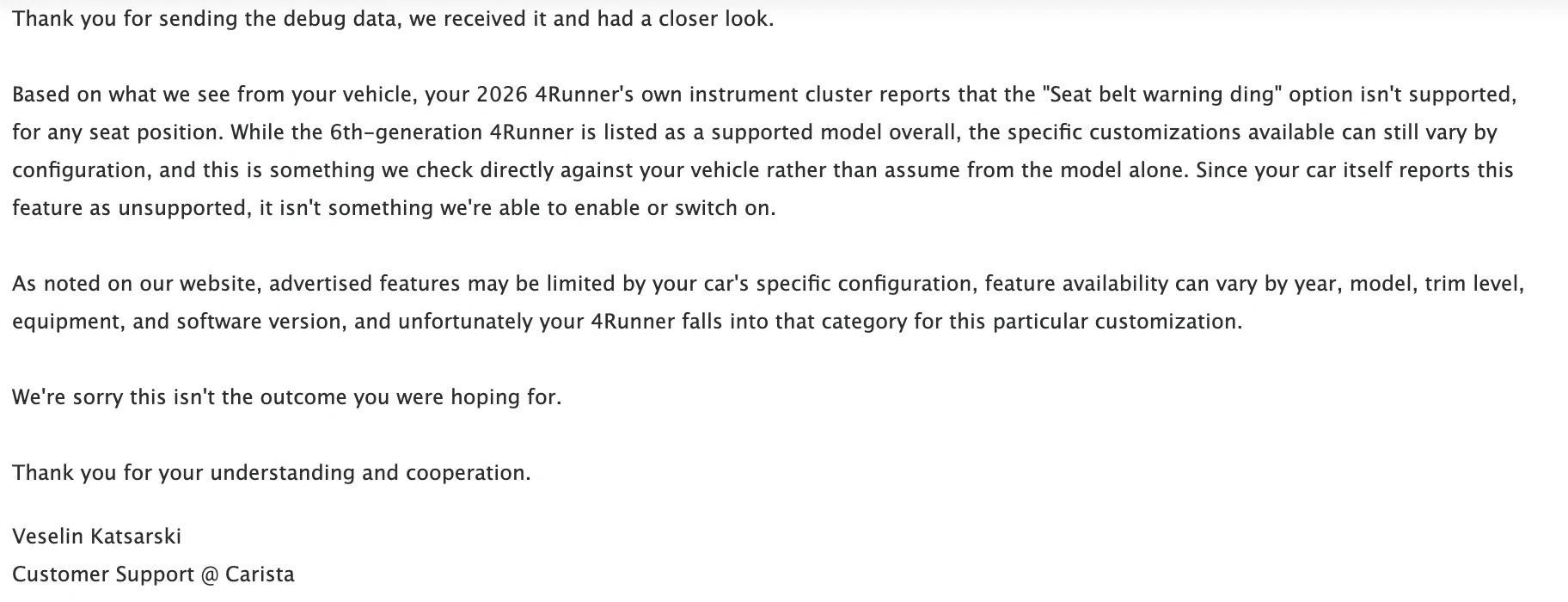

ok i sent some error reports via "report a problem", did one from my 2025 and 2026 4runner platinum's. see how that goes.
here is the export from carista on my 2025 4runner platinum

here is the export from my 2026 4runner platinum
