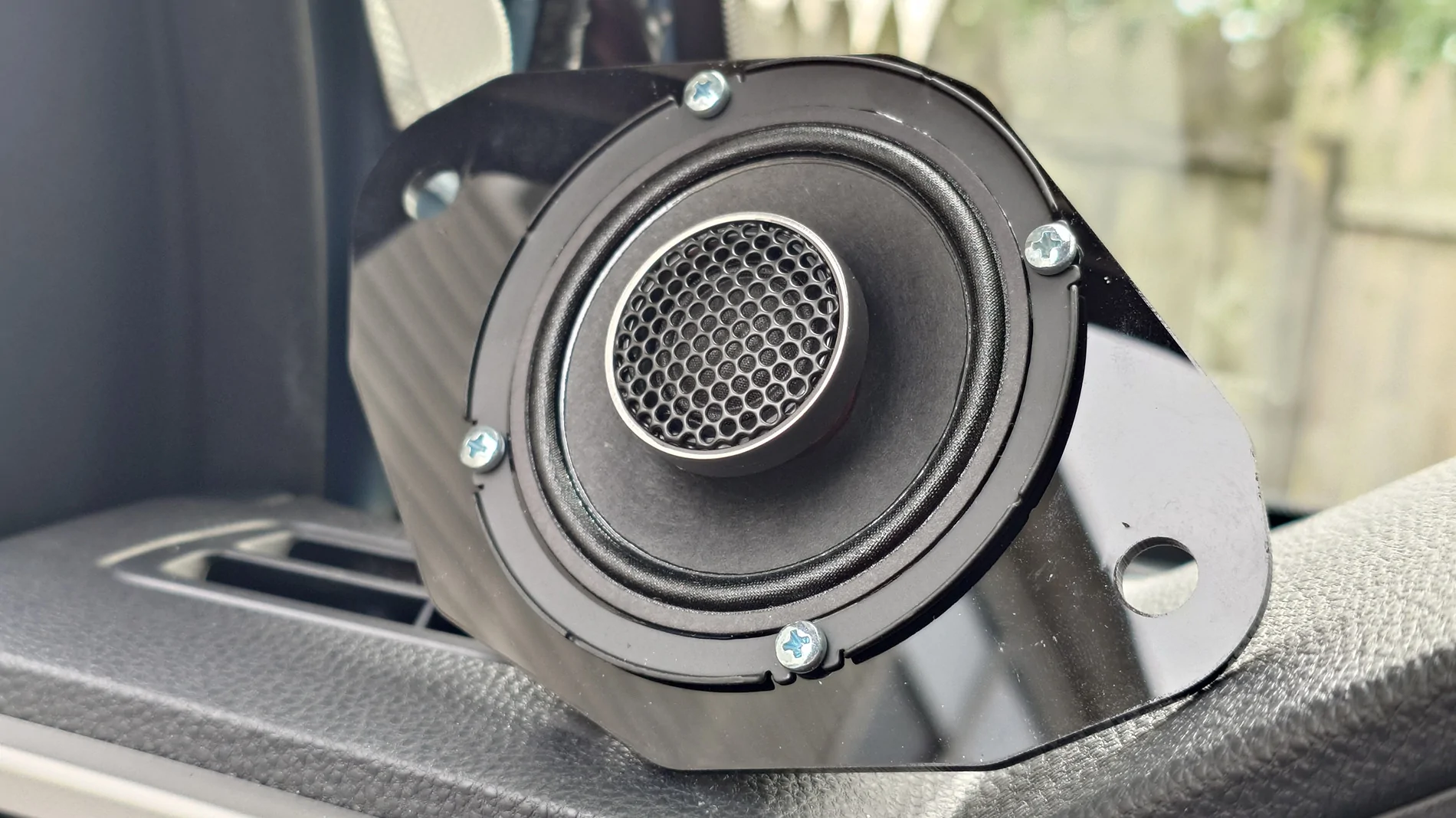

I got this kit and it was super easy to install, especially thanks to the video that takes all the stress out of getting into the door panels.

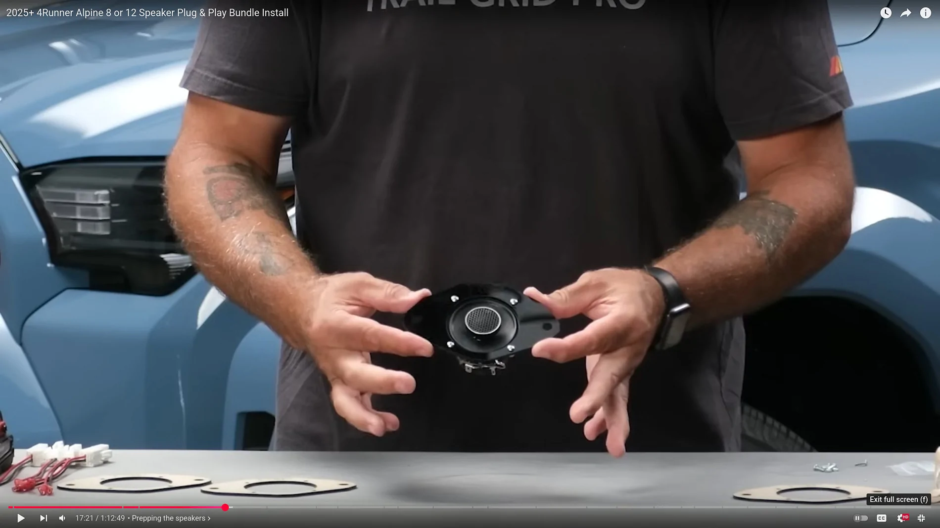

One thing I don't like is the nuts & screws supplied for the dash speakers and the directions how they show installing them in the video.

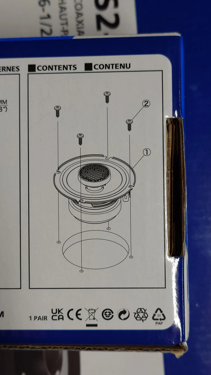

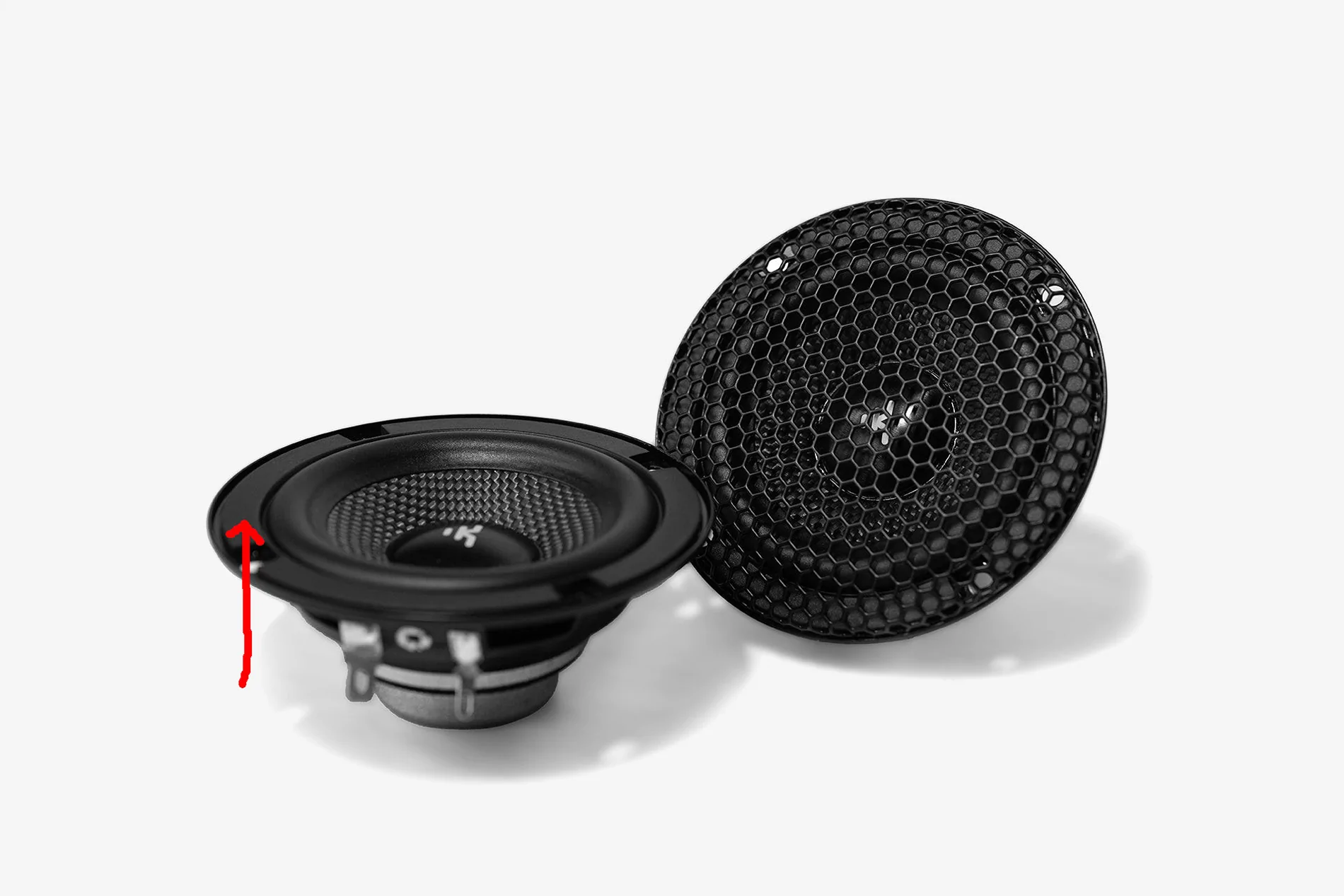

1: The video shows installing the speakers below the bracket. I say this is wrong for at least 2 reasons. 1, the Alpine directions clearly show mounting the speaker on top of whatever surface it's mounted in. and 2, the speaker does not include a spacer gasket to fill the space between the flat surface and the raised lip around the outside perimeter. If you screw that down like that without something solid filling the space, you just bend the steet metal frame of the speaker out of shape.

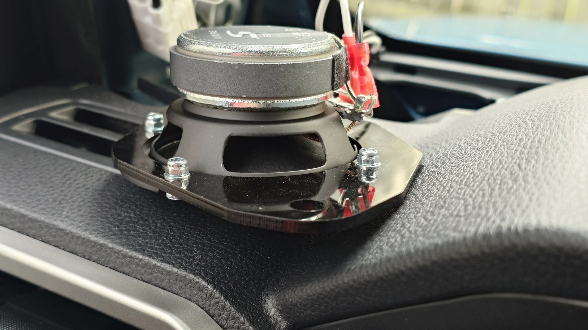

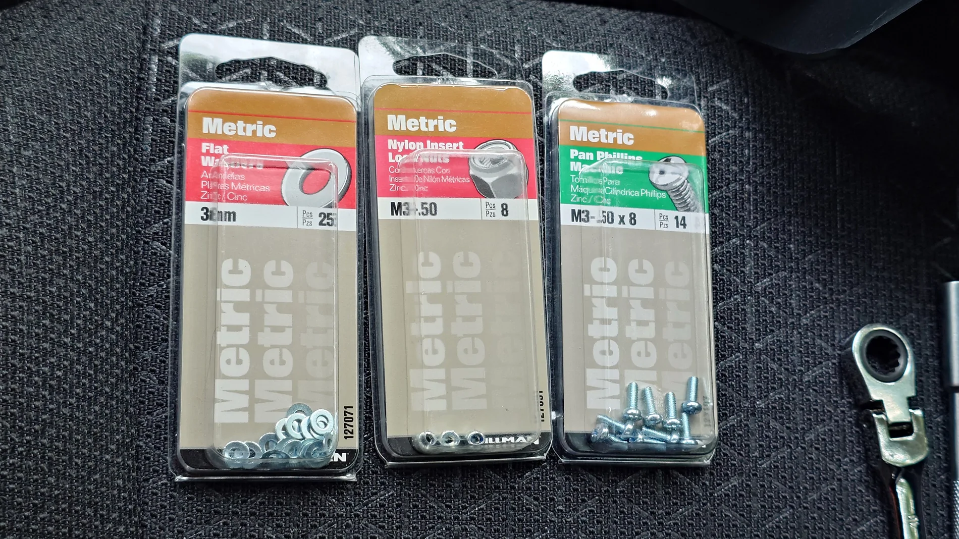

2: The screws and nuts are just plain screw & nut with nothing to prevent shaking loose over time, and no washer to spread the load from the nut on thefragile acrylic. And you can't use thread locker because that stuff detroys most plastics. It would not risk letting it touch the acrylic or the dash for that matter. Even though it literally comes in a plastic tube, I once destroyed all the screw posts on a big interior car panel made of stuff that looks and feels just like most of the 4runner interior. The blue loctite made the soft black plastic just crumble and fall apart, It's hard to describe. it didn't melt, it changed from being similar to milk jug plastic, to being like crayon,
So I got some M3 screws, flat washers, and lock nuts at lowes. (just a bonus that the new screws are metric like the rest of the truck now) And installed the speaker resting on the top surface of the bracket like this.

I had the non-jbl. I did the beat-sonic + apline 8in. All in less than 3 hours of work. Huge improvement. Loud and clear sound
@bkw777
Good idea on the washers and lock nuts. I'll probably go back and add those.
