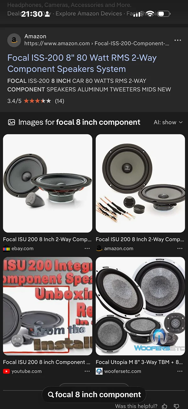

Focal now has 8 inch component mid speakers. Which i will probably get for the doors and swap out the tweets.
