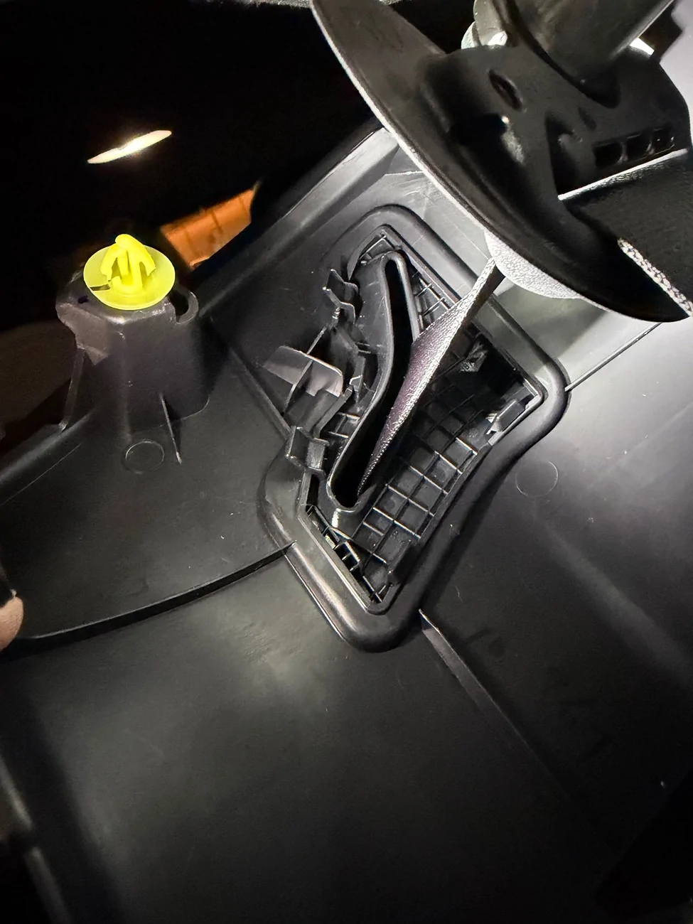

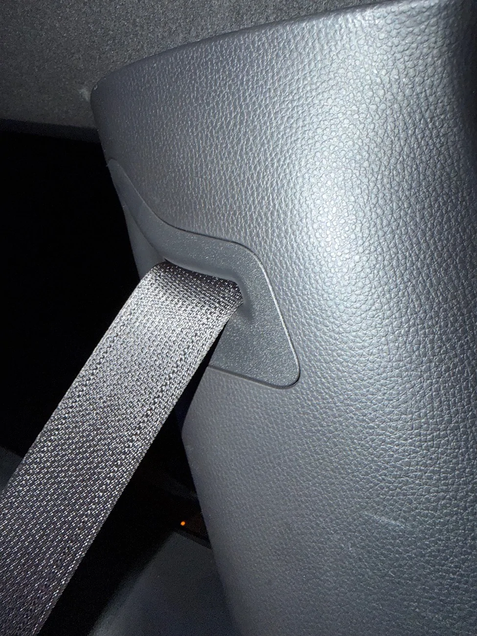

BIG FYI here! I feel so stupid for it but I was so impressed with the improvement that I did not pay attention to a simple detail. If you have a 3rd row, this will not work because of the seatbelts in the panel. I am gonna take a look tomorrow if there is a way to mod the panel to accept the seatbelt other than just putting a slit in it. If not, I will try returning it for full refund since nowhere on the site did it mention anything about not working with the 3rd row (even if it is obvious). Should I not be able to return it for complete refund, I will offer it up for sale at the price I got it for: $225 total. So bummed
toyoda80
Beau
May 12, 2025
61
58
2025 4Runner SR5 4WD Cutting Edge
This looks promising. There is an insert where the seatbelt exits the panel.
2025 2026 4runner 6th gen Cargo Lamps option install in cargo area interior - photos & DIY instructions IMG_1606
2025 2026 4runner 6th gen Cargo Lamps option install in cargo area interior - photos & DIY instructions IMG_1607
If I can match the cutout, it might turn out better than I thought.

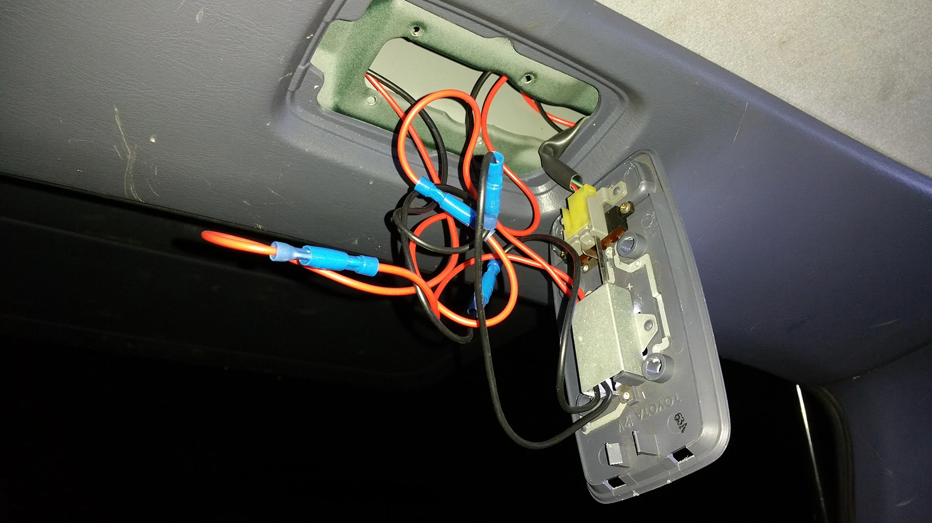

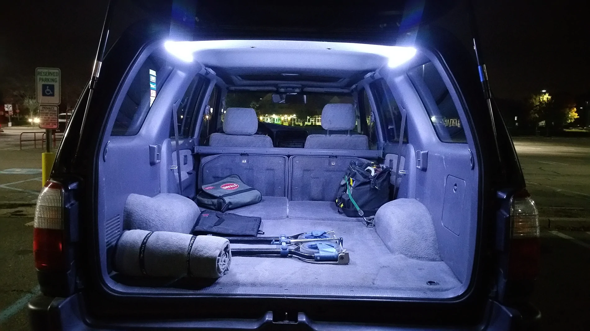

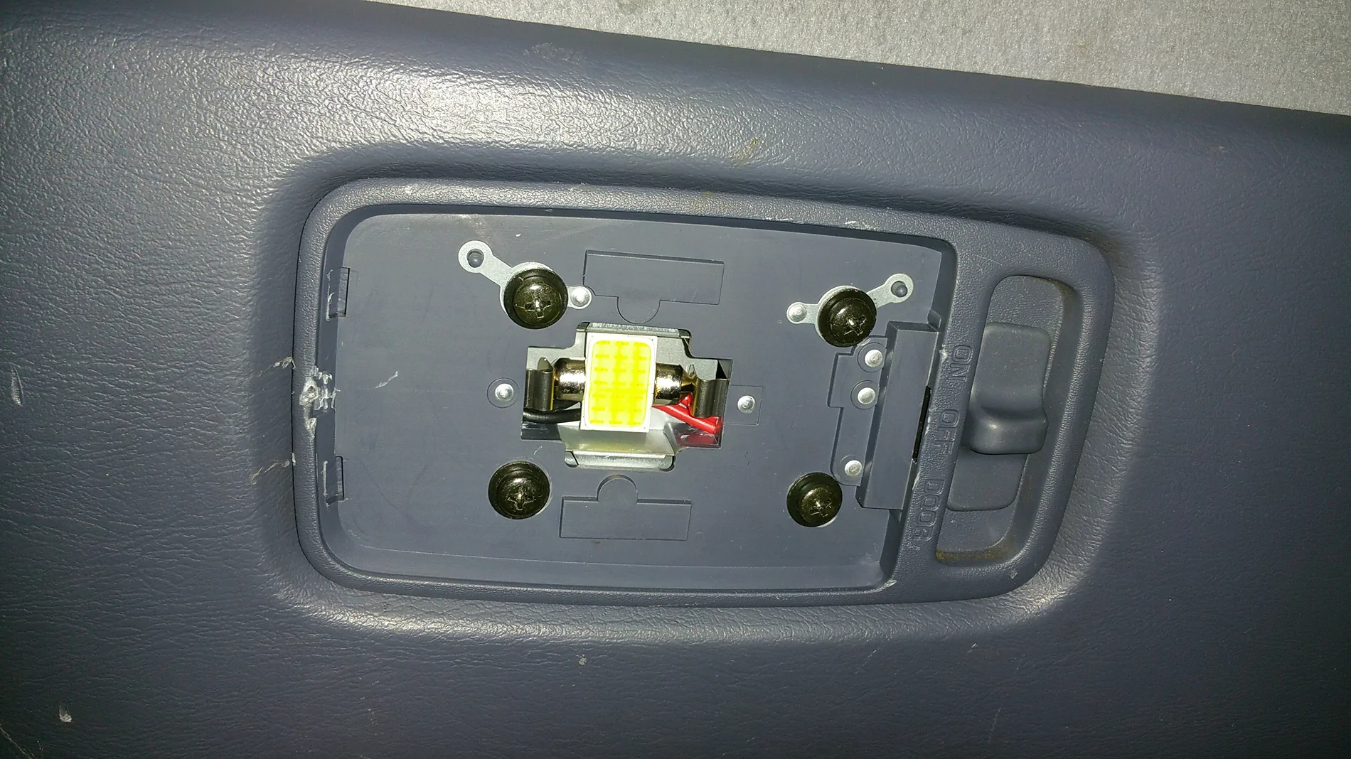

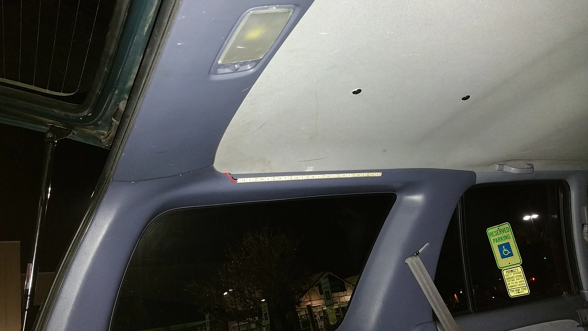

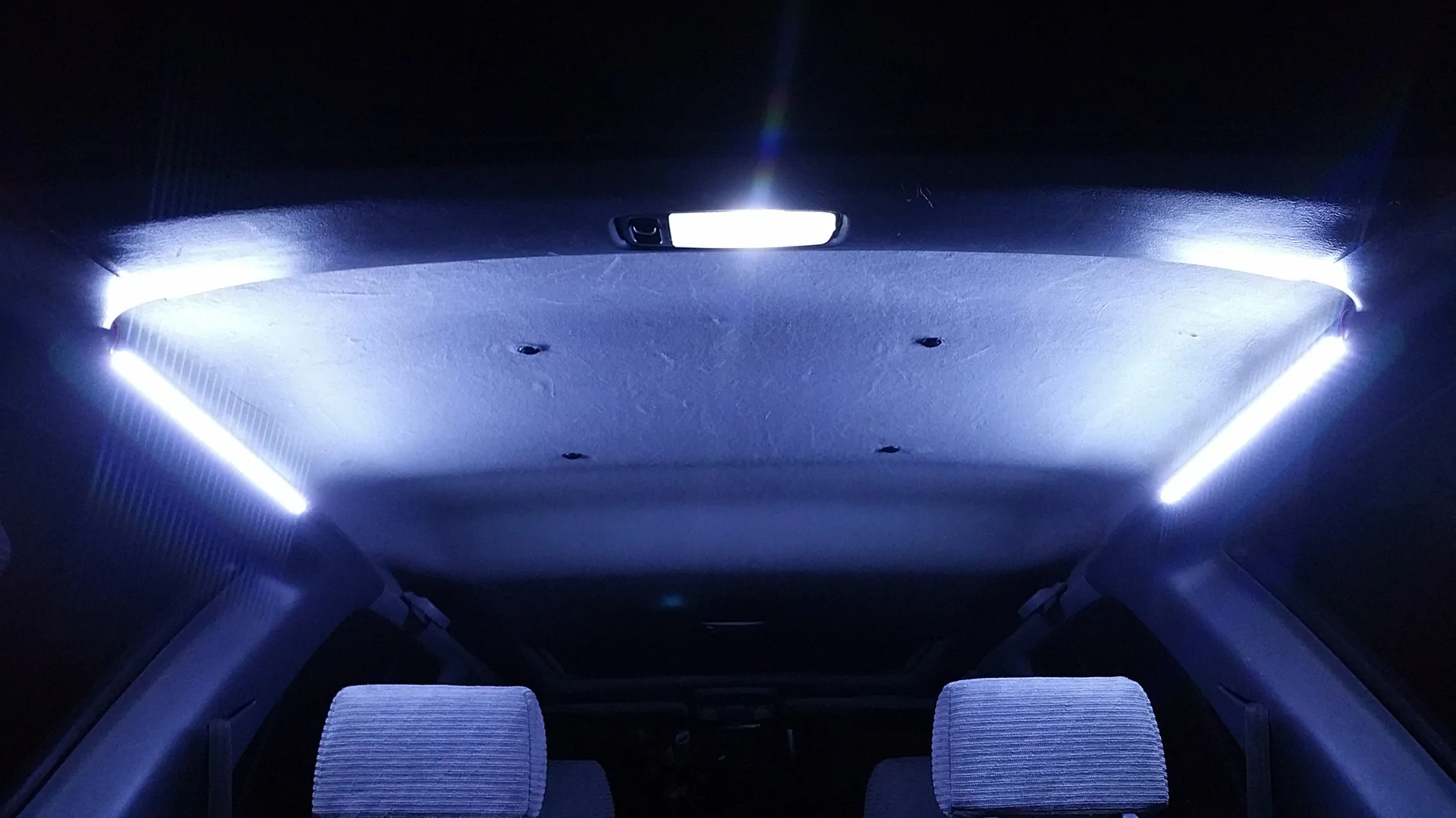

Mine came with these but to me they are pretty disappointing. They are in almost the same positions as the regular lights so it hardly improves anything. It's better, just not all that much.
In my 3rd gen I ran a couple led strips along the top edge of the windows. *that* was excellent cargo illumination. Since they are 2 long strips it makes light from multiple directions all around so your own body does create an annoying shadow right on whatever you're trying to work on.
I replaced the original single incandescent dome light with a much brighter led, and wired the new strips through some banana plugs to the led itself which then just snaps into the original fixture, so all 3 lights just run off the original dome light socket without having to touch the trucks wiring.
And since it was a decrepit old 3rd gen instead of a wonderful new advanced... it actually had an amazing genius invention that we have lost the knowledge of the ancients over the countless generations... a light switch, right at the back door, that overrides the automatic and turns the lights either off, or on, even if the truck doesn't understand why you might want the lights OFF with the gate open, or why you might want the lights ON even after a few minutes, you can just have whatever you want anway. Just imagine such utility in a utility vehicle.
