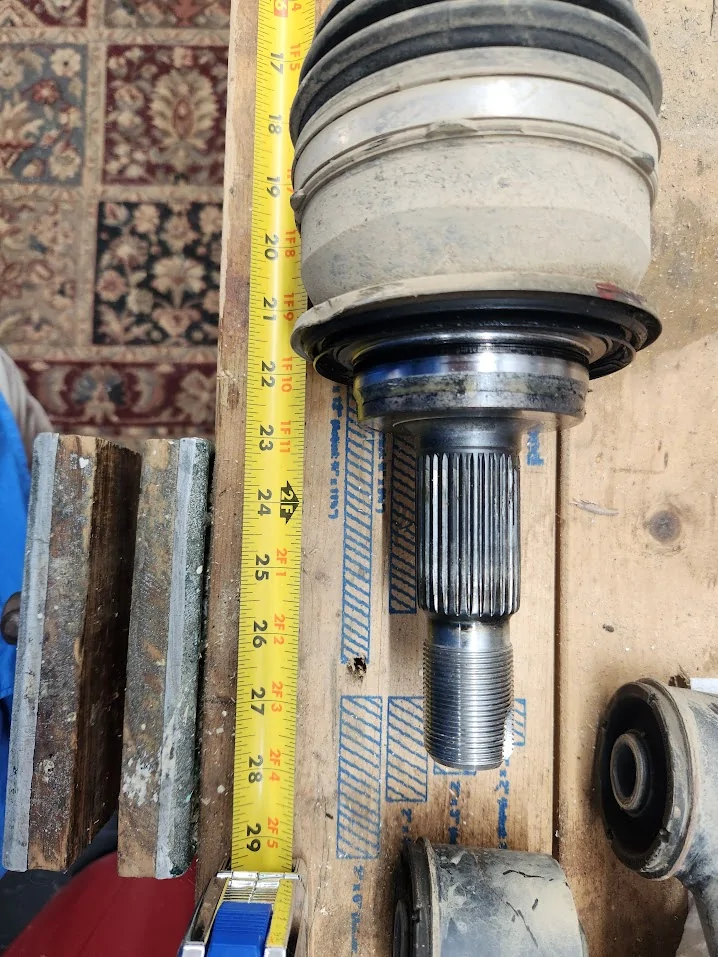

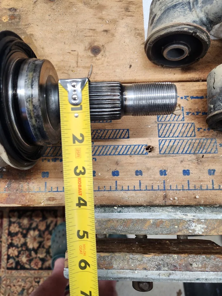

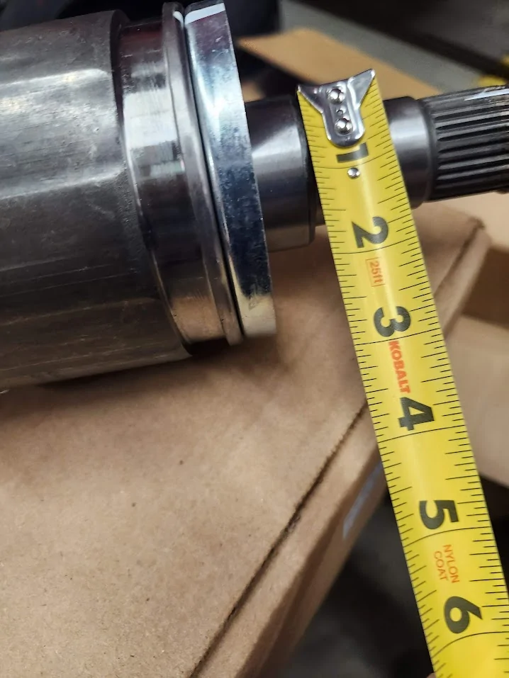

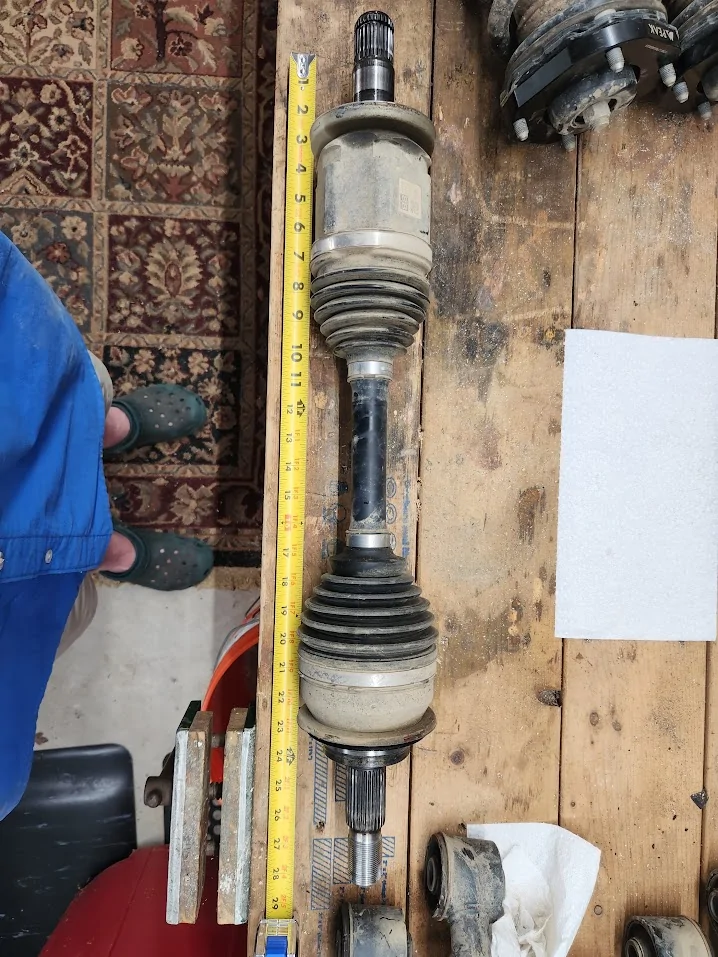

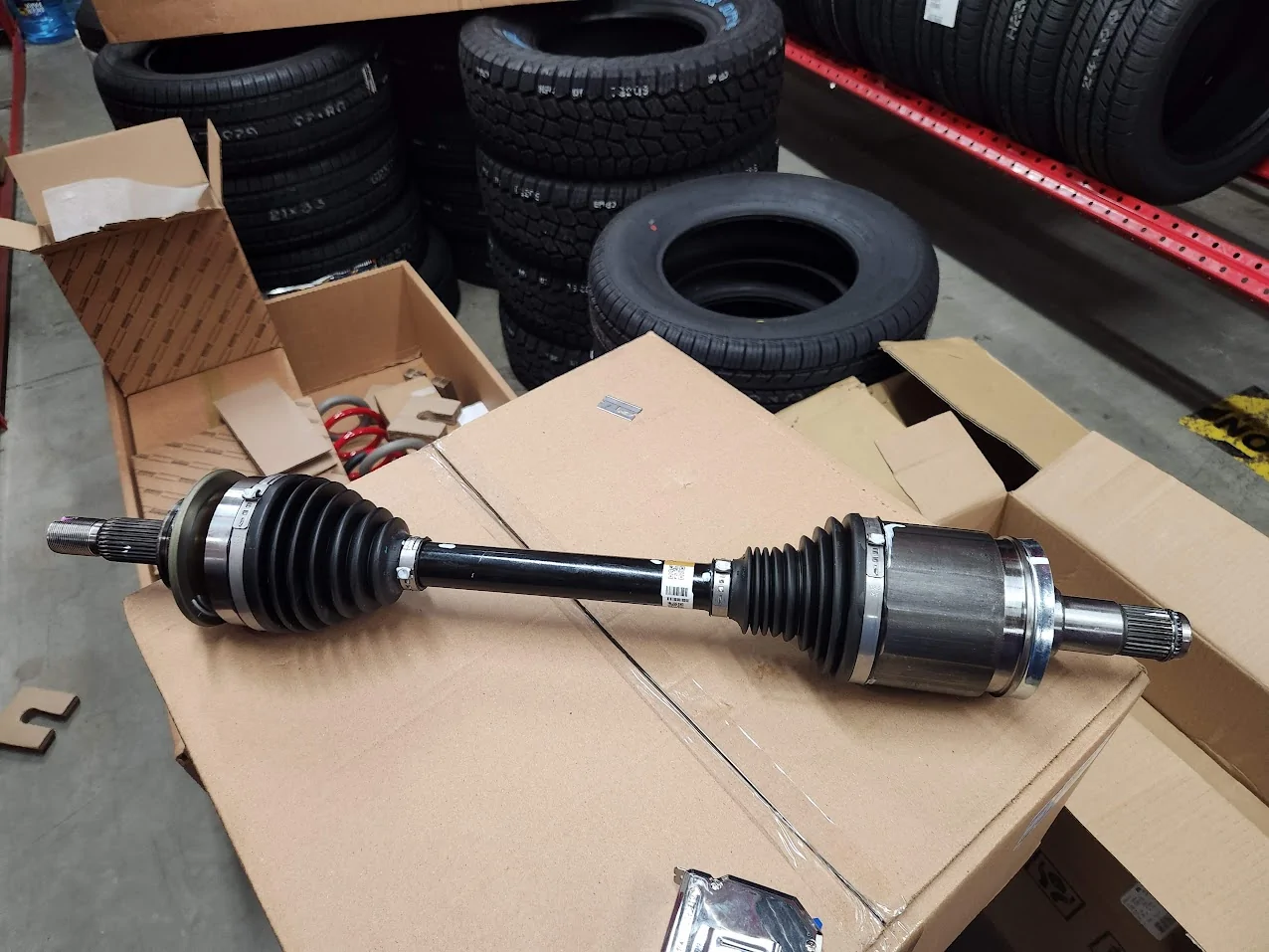

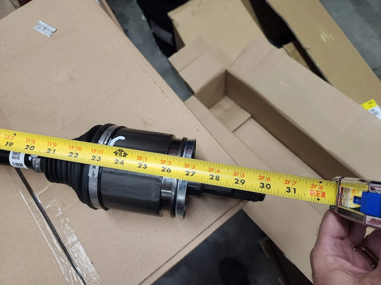

I've been meaning to post the measurements in the TRD Lift thread - and will do that at some point - but to at least shed partial light on the question about TRD kit axles.....
I had the kit installed on my TRD ORP. So this does not explicitly answer the question but adds some facts taht might help. And here are the part numbers that appear on page 2 of the TRD Lift Kit installation guide:
  • SHAFT ASSY, FR DRIVE, RH 43410-AK020
  • SHAFT ASSY, FR DRIVE, LH 43420-AK020
TRD ORP Stock Axle is ~27.75"
TRD Lift Kit Axle is ~ 30"
It might be a bit larger diameter but I'm not certain.

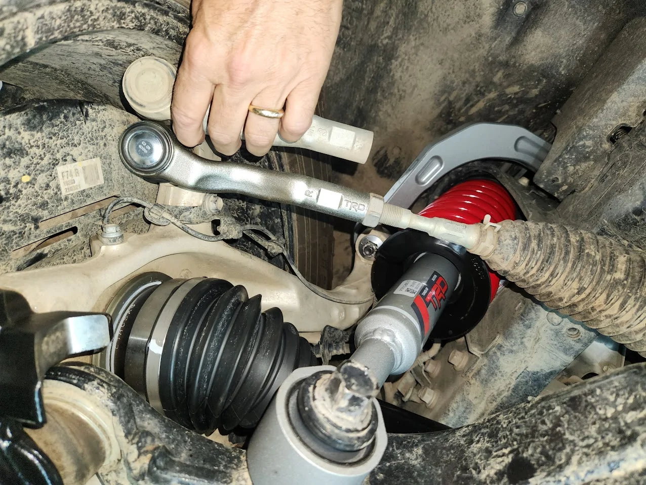

Will also note that the tie rod ends that come with the kit are also longer than stock by a bit. (maybe half inch?)
So, would it push you wheels out 2.25in?
Also, thanks for posting this!

Thank you for this information. I was told by my local Toyota dealership, that does custom off road mods, that these axles, that come with the trd Lift kit for the 4runner, is the stock axles for the tacoma trailhunter. They will swap mine with these axles.

So you’re getting the longer Tacoma Trailhunter axles installed with your Ironman lift?
