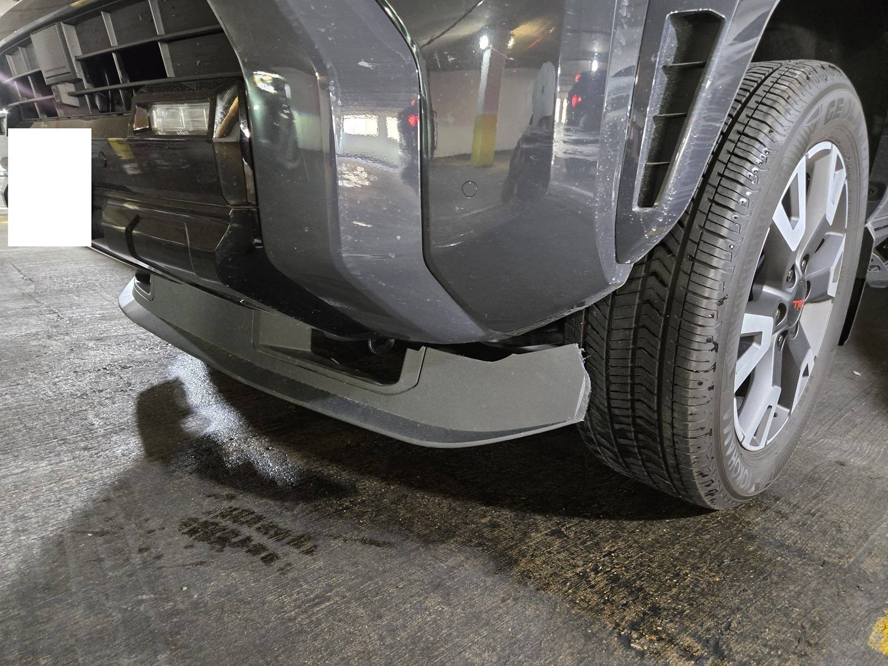

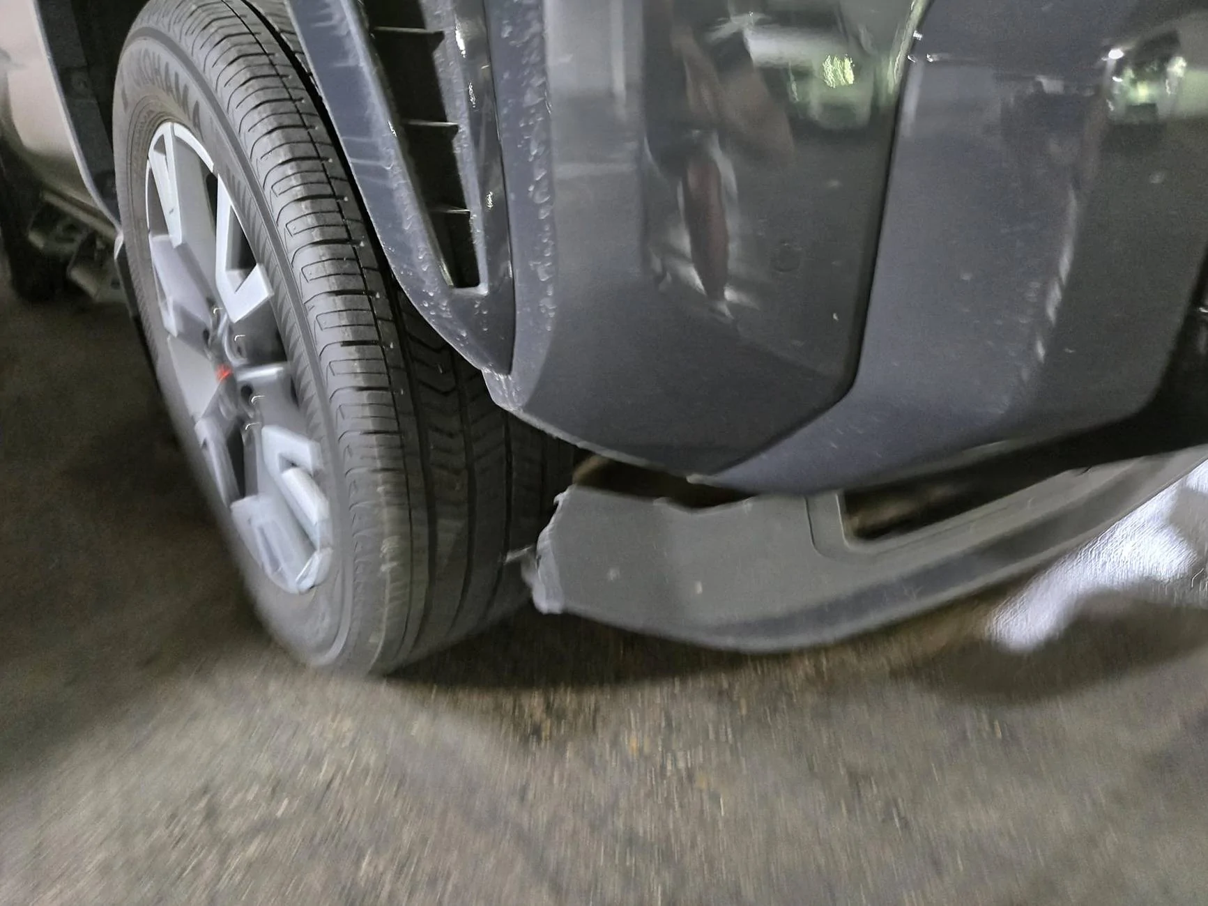

Looks like someone forgot a screw or two.. Mine was fine for the first 2000 miles... now it's hangaing off. Headed back to the dealer next week. Anyone else have this issue?
Mine got detached from the corners, some people have claimed the bolts fell off. Mine broke. Warranty replace, still on back order. Not planning to put it back on......

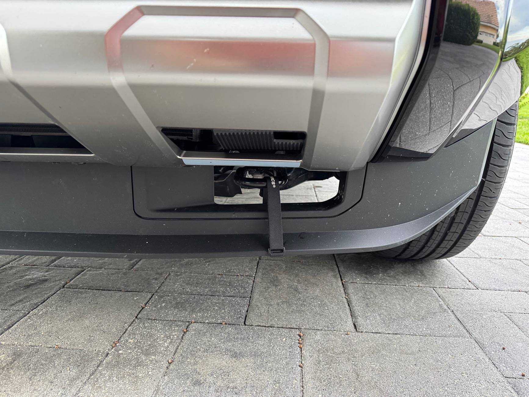

Mines being held up with a "velcro strap" for now - I have service schedueld next week
