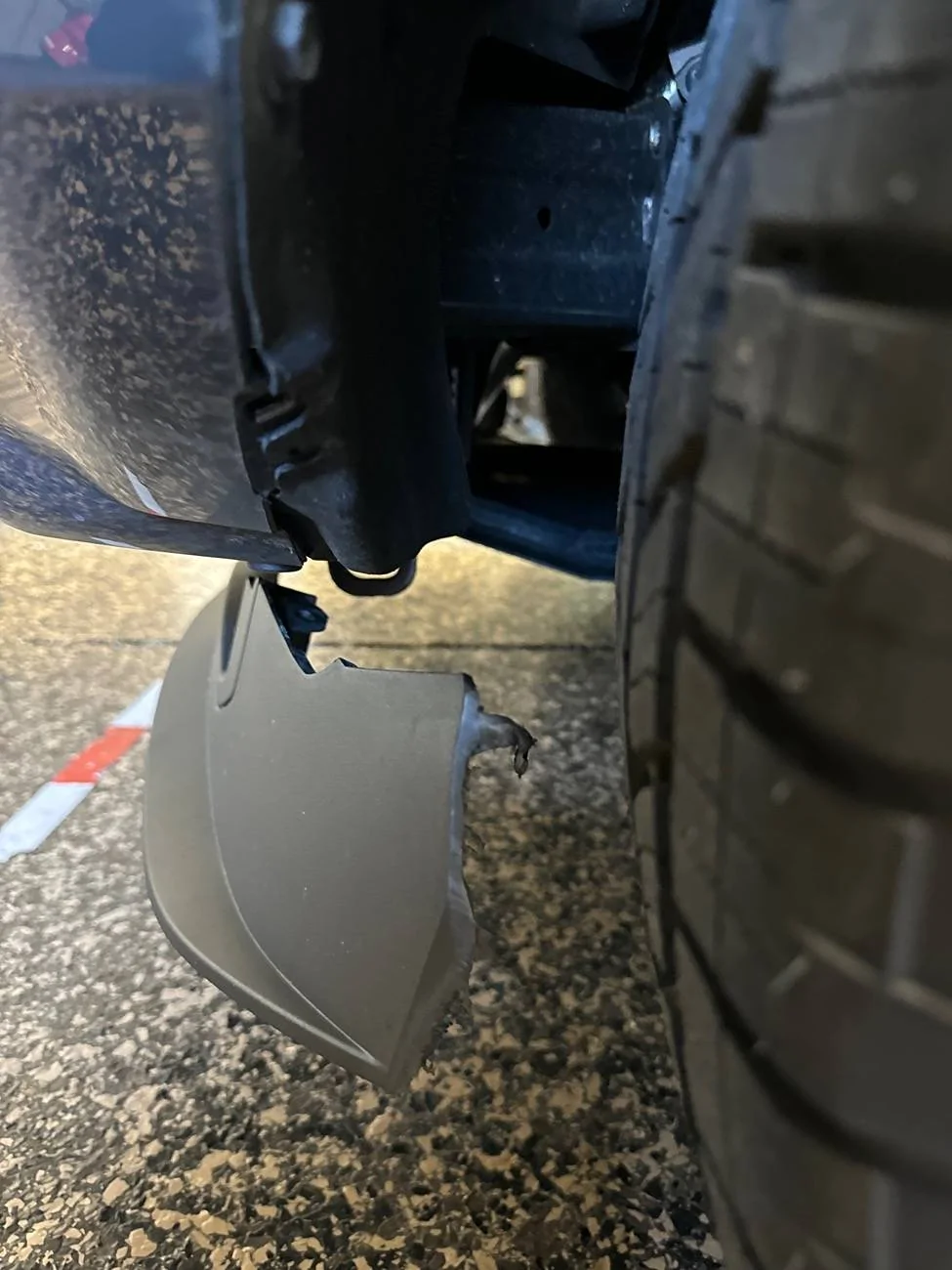

Holy crap that tape..... took mine off, all the hardware was there but wicked easy to remove, at least a few weren't even finger tight

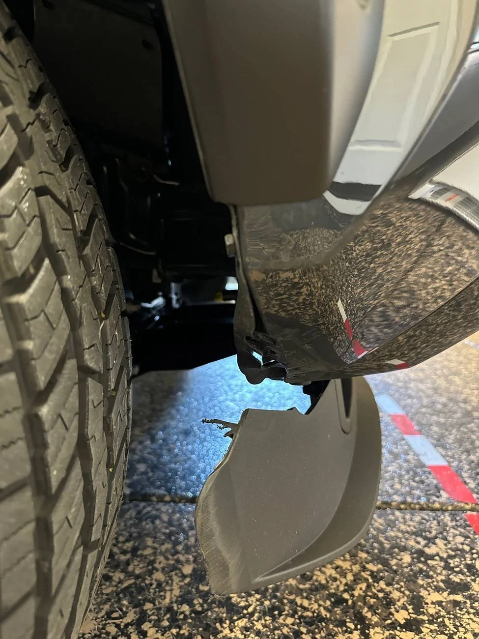

This happened to me yesterday. I heard a noise while driving when I got home three bolts were missing and it was hanging.

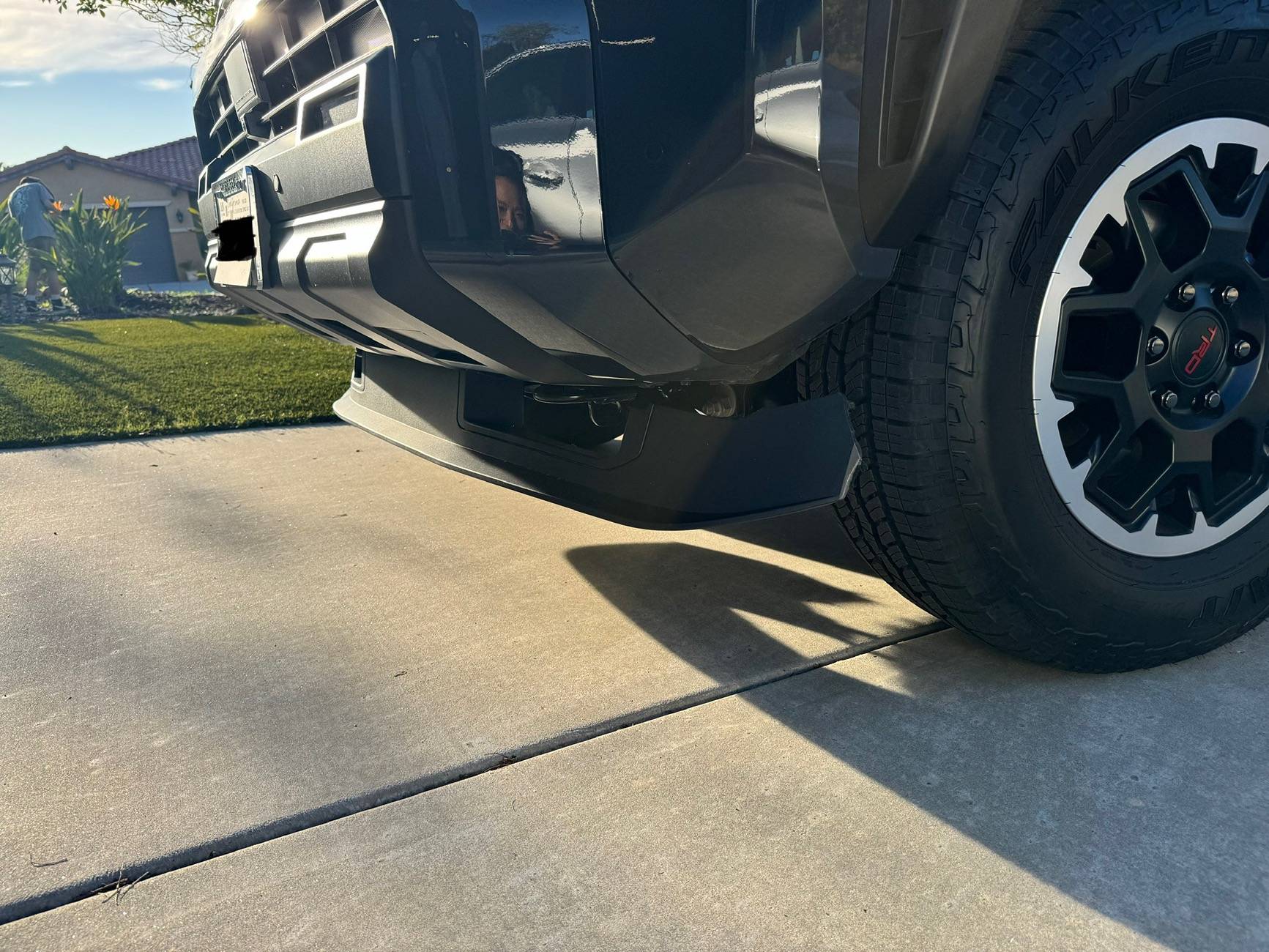

This happened to me today just one hour into a 12 hour road trip. One of the driver side clips popped off and one side dropped down rubbing pavement and tire, the dealership is saying road hazards not covered under warranty but there was no road hazard. I was getting passed biker gangs on the interstate and wondering what would happen if the whole thing came off and hurt someone.. would Toyota take responsibility..

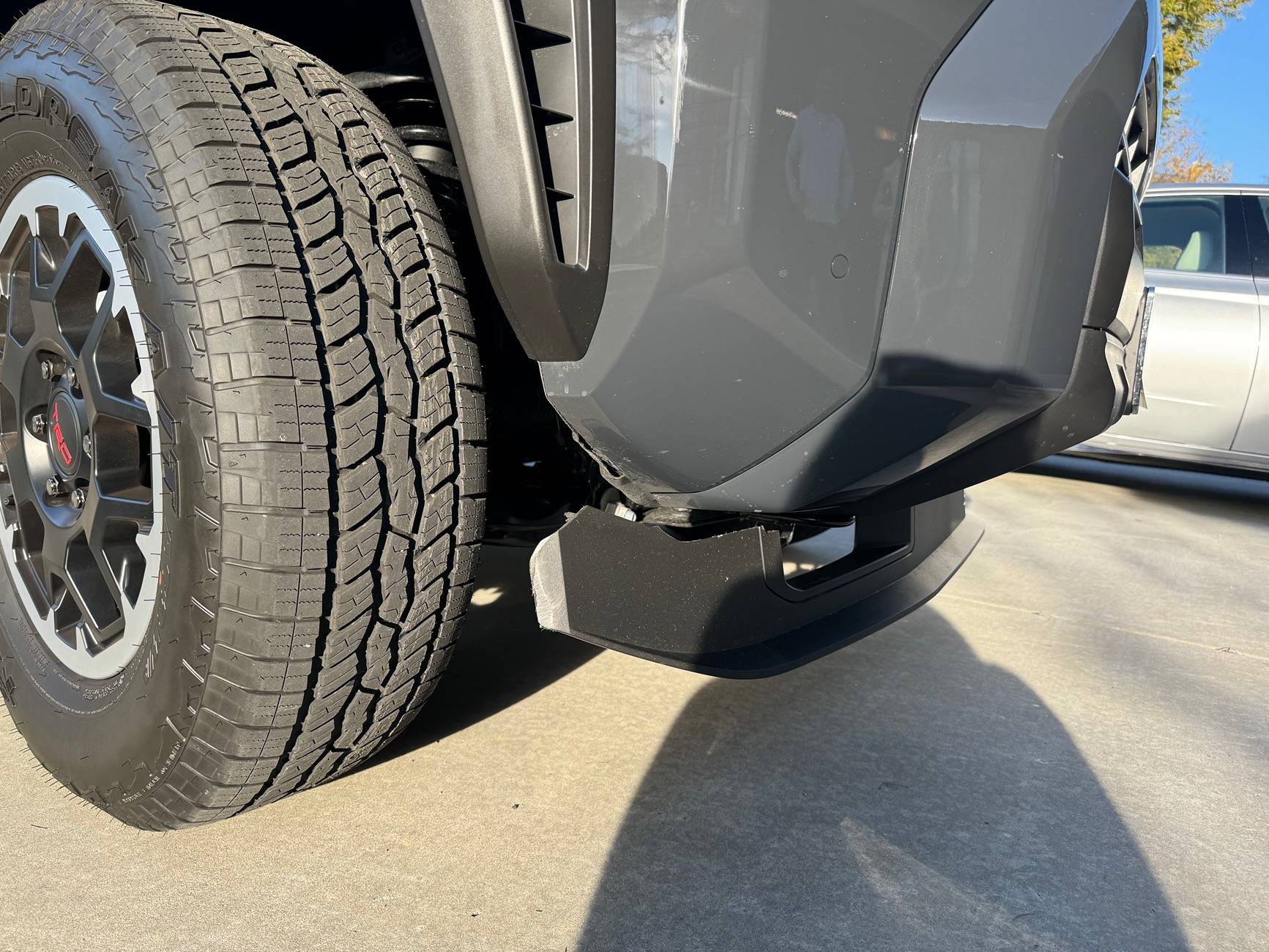

New to the thread / forum. My dam got loose after 5K miles and started hitting the tires. I took it to the dealership (different one that I bought from) and they informed me that it was clearly something I did so won't be covered by warranty. They charged $100 to remove it and quoted $800 for replacement / labor. I told them to hold off until I did more research. I am glad I did and found this thread as it's clearly a malfunction from the manufacturer and should be covered under warranty. I am reaching back out to the dealer I bought from with a link to this thread and hopefully we can find a solution. I guess this is the price to pay for being one of the first ones to have a brand spanking new model!
