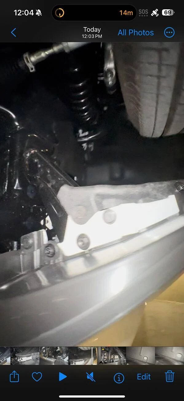

2025 4Runner I-Force Max
Okay, these post required I go check my air dam. I picked up my 4Runner on 7-1. I have 280 miles of accelerated highway driving. All of my screws were tight. However, I am not going to crawl under the vehicle every 300 miles to confirm this. I'm thinking, go with the 2024 LC250 skid plate and lose the air dam entirely.

The screws that are installed now, only make contact with one thread. This is what I purchased to remedy the problem.

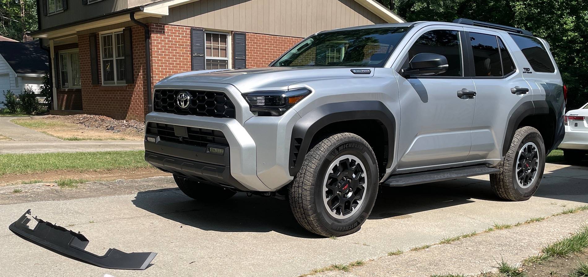

I’d recommend everyone remove that air dam. It’s eventually gonna end up ripped off and you’d rather remove it before you roll over something and that happens.
