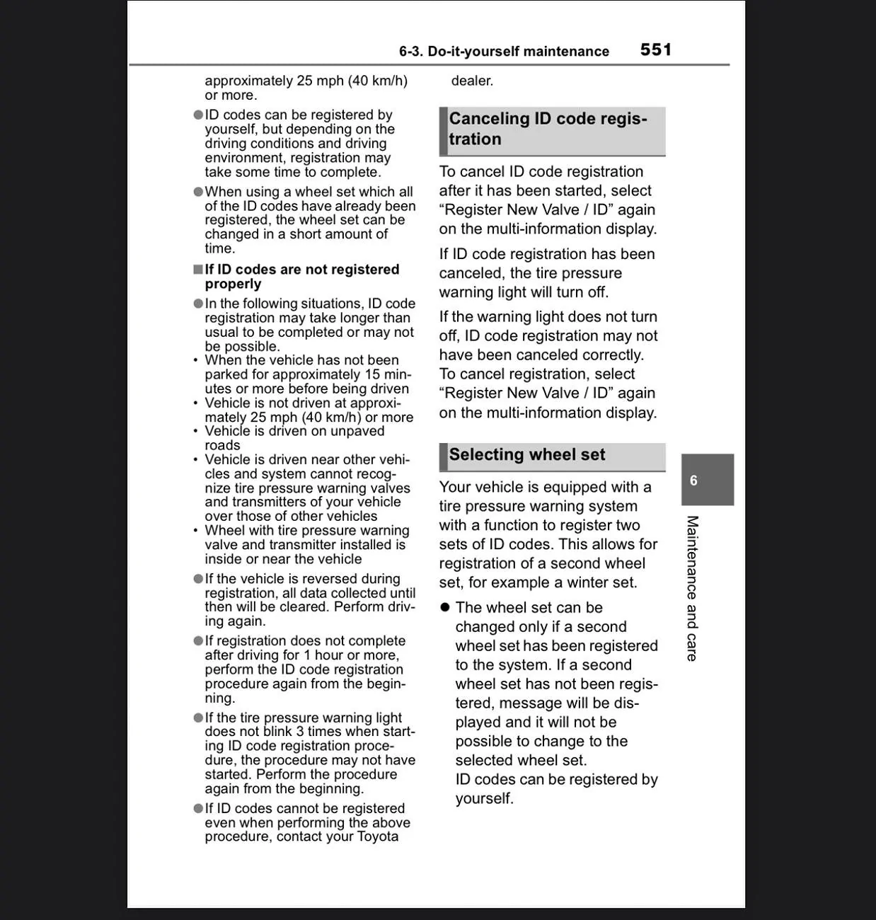

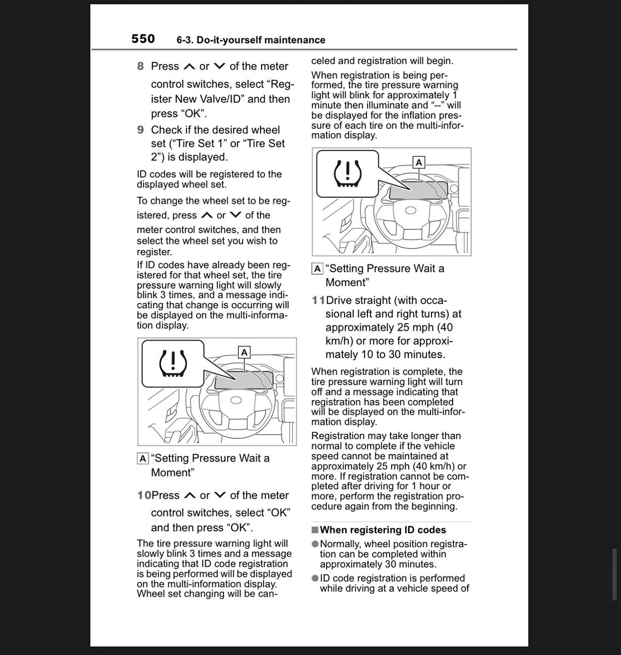

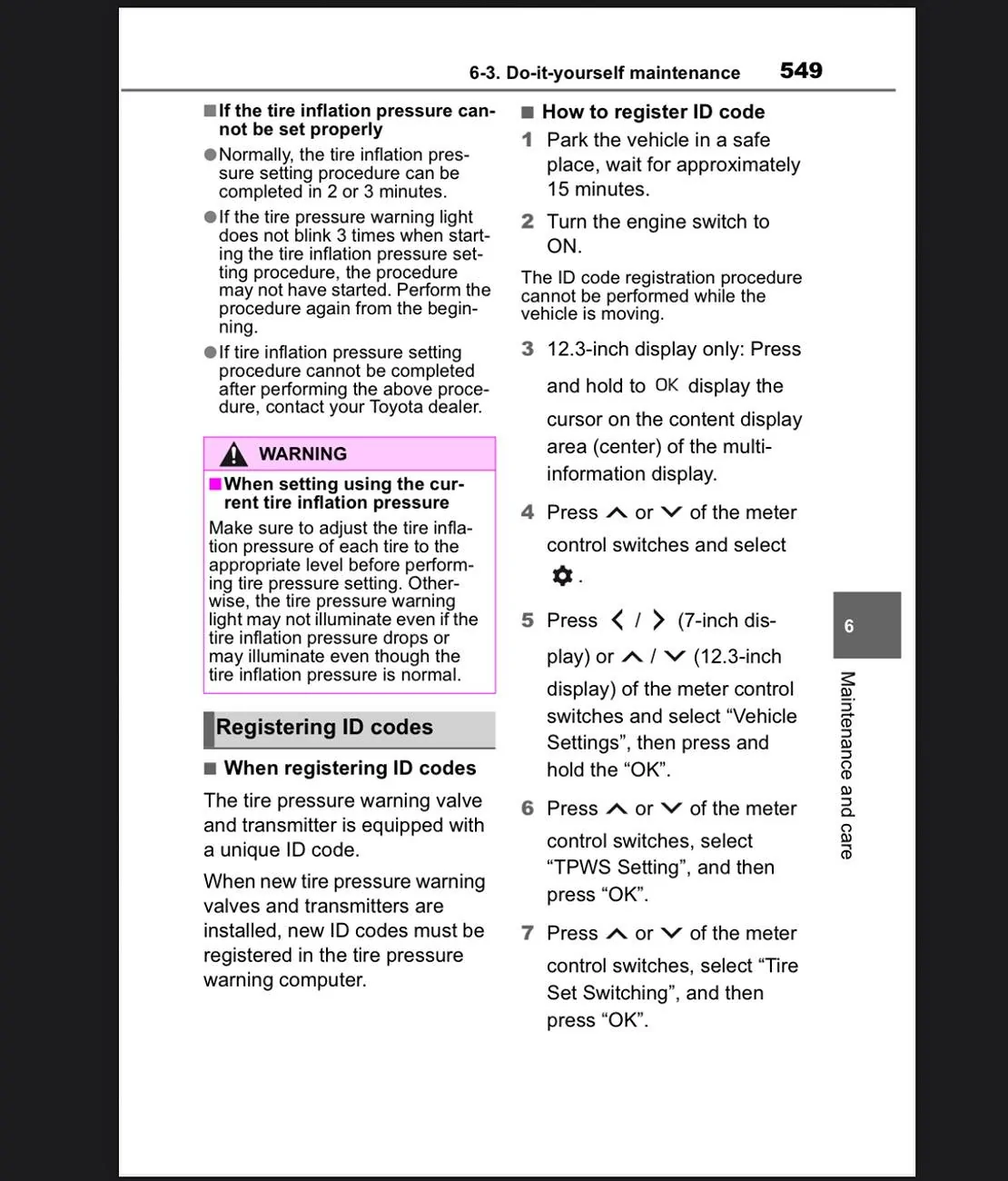

See the user menu page 549
Of course it was right in front of me. Thanks for your help. I think we have basically the same truck, at least when my wheels and tires get switched out. At first I wanted an ORP but after more consideration I decided on the Sport premium for the on highway ride. I’ve had several 5th gen’s including a 2024 Pro but the only time I turned the rear locker on was to test it out. I’m very happy with the Sport. I think the color matched flares look excellent.

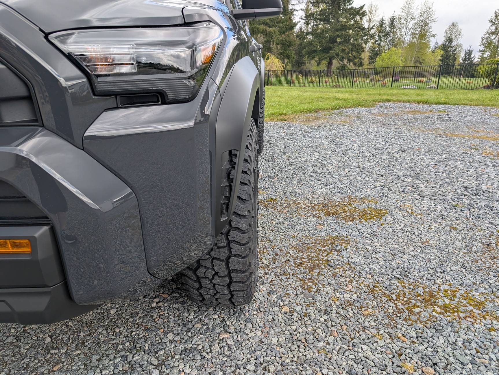

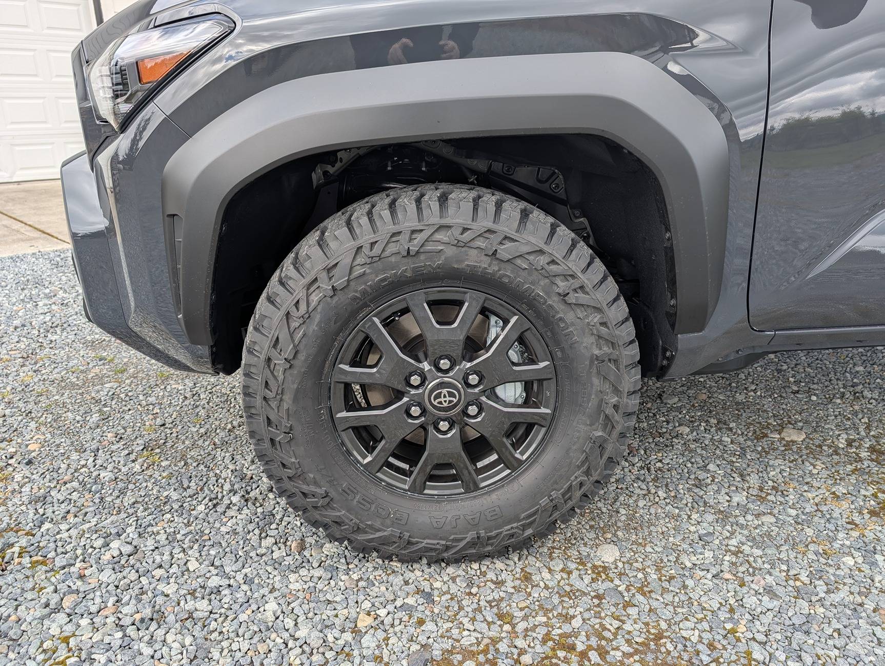

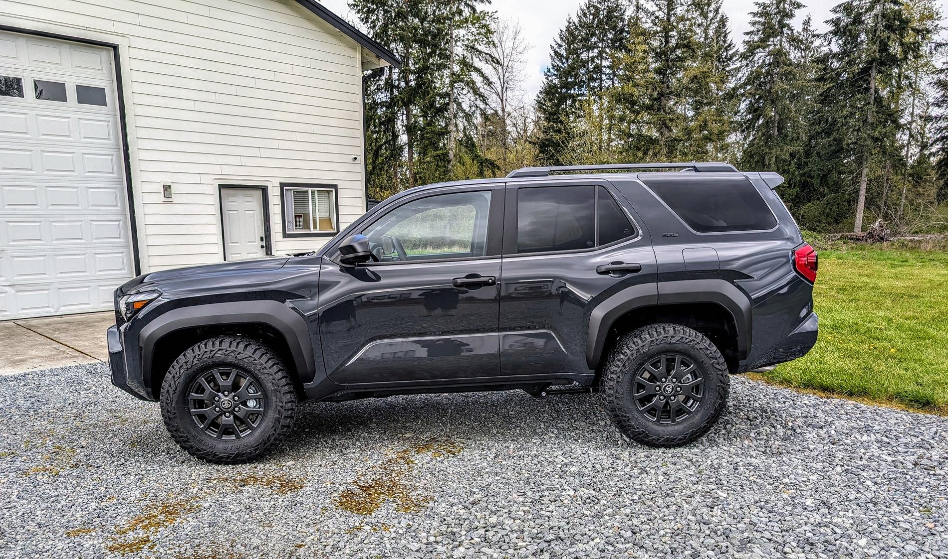

Mickey Thompson Baja Boss A/T 285/70R17 on stock SR5 wheels. Installed today with no rub. Stock suspension.
