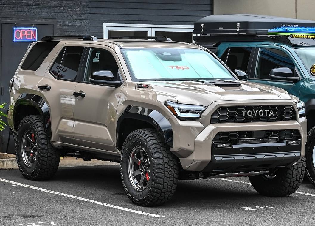

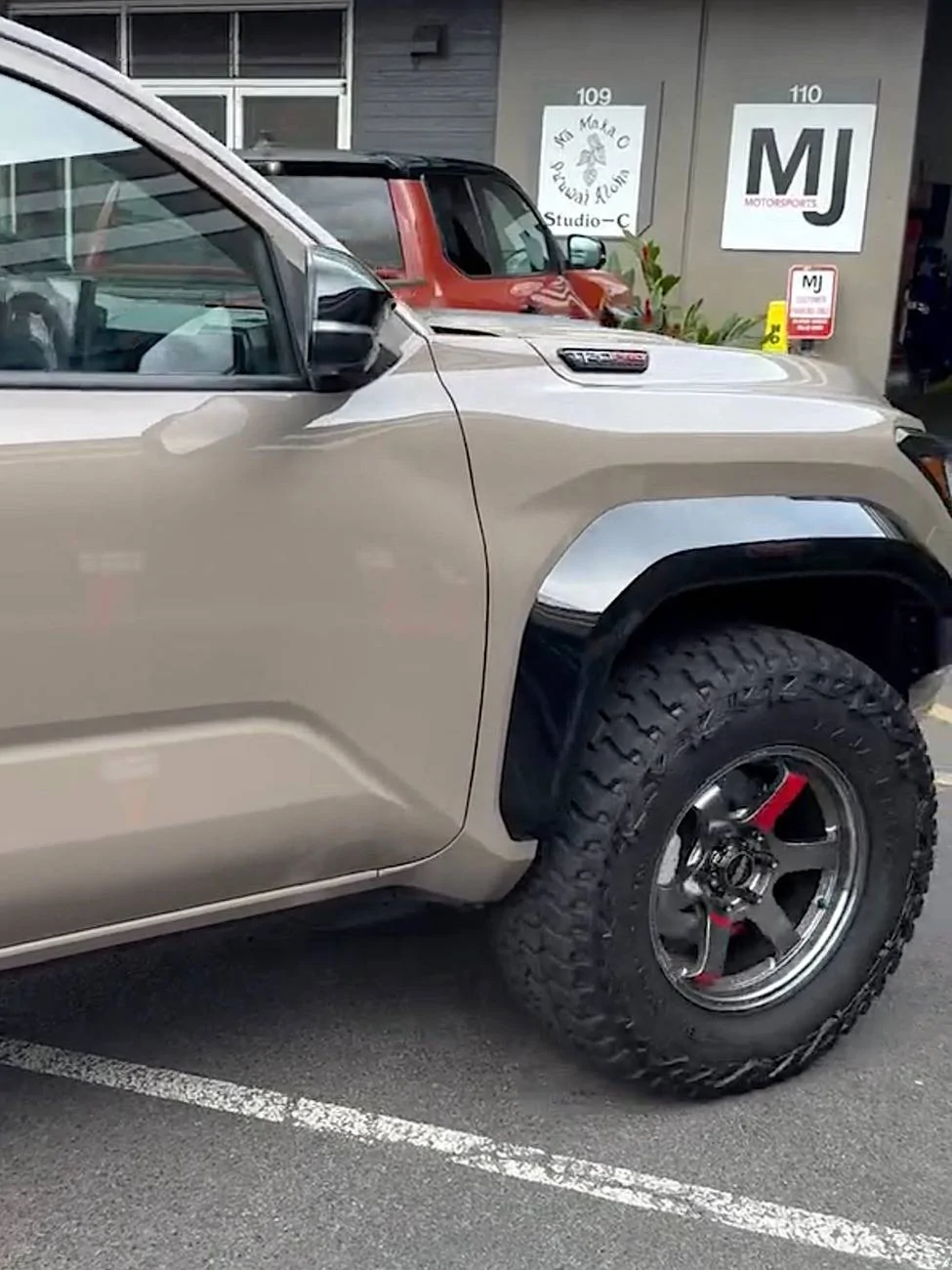

Looks great! Are you getting any rubbing at full lock with the stock suspension?
zgreen
Zach
Feb 6, 2025
351
259
No rubbing even at full lock.

Looks awesome! I’m sure you had to take the crash bracket off the rear of the front wheel wells though, right?

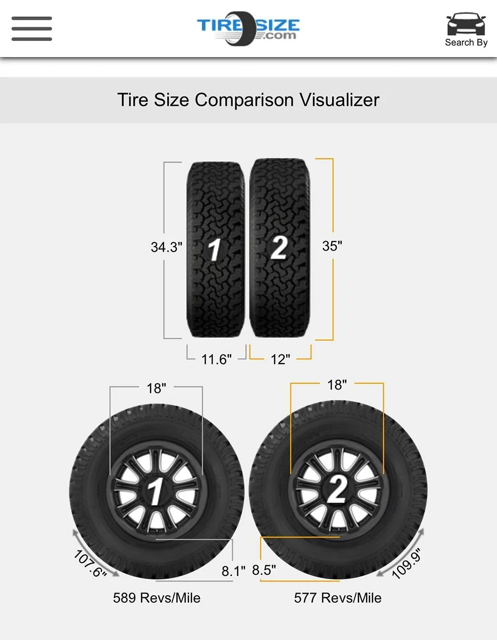

For anyone trying to replicate this by only reading the post’s title, just know that 275/70/18 tires are NOT 35s.
To be fair through, Toyo Open Country ATs in 35/12.50 are on 34.6in tall as well.

You’re not wrong, but most tires are undersized, including 295/70r18 “35s” mentioned in this post.
Also, I input the width incorrectly on that comparison. 35s can be almost a full inch wider than 295/70r18.
