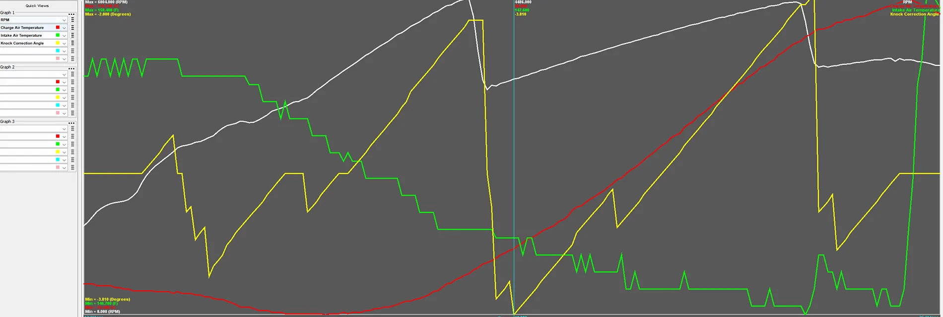

To go one step further from above, here's an example of a data log with limited parameters shown:
  • Intake air temperature (at the intake and at the manifold)
  • Engine speed
  • Knock correction angle
you can see the knock correction angle (yellow line) moves around -3, dips, then climbs to close to -2, but it also dips down to -3.8 on shift. The way to read this is to follow the RPM scale (white line) to where it peaks and then drops off, and that indicates a shift point.
The KCA in this log is what would be considered normal and would not be cause for concern.
