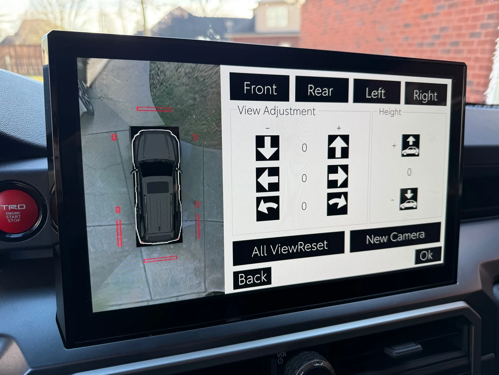

Update: It works! I tried it without my phone paired (was happening automatically so I turned off Bluetooth) and it gives me the options to adjust.
To calibrate your cameras, it's actually fairly simple. You can do it all on your radio infotainment screen.​
Steps to access the Calibration Menu (service menu):​
1. Get in your truck and close all the doors and windows. From my testing, you cannot access the Service Menu if a door or window is open. Once you access the Service Menu, you then can open a door or window.​
2. With your foot off the brake pedal, double click your stop/start button to access Accessory Mode​
2. Wait until the infotainment (radio) screen boots up​
3. Turn the volume all the way off​
3. Go to Settings > Display > Screen > Turn off Display​
4. Okay so here is the hardest part. You have to swipe left to right 5 times, and then right to left 5 times. Your screen may display "Touch to turn screen on" while you are swiping, but ignore the message.​
4a. It may take 1 or 2 tries to get this to work. If you mess up, you just have to tap the screen to turn it back on, then turn it back off in the settings. Then continue with step #4 again.​
5. If swiped correctly, you should see a Service Menu pop up.​
6. Navigate to Function Check > Camera Settings > View Adjustment​
6a. If an option is greyed out, just hold the desired option for appx. 5 seconds and it will let you select it.​
7. After selecting View Adjustment, select Next.​
8. You will now see the birds eye view of your truck where you can make adjustments.​
9. After making your adjustments, select Ok.​
10. Once it completes saving, click OK and you can exit the Service Menu. The next time you start the truck, it will ask you to complete service mode and just choose ok to complete.​

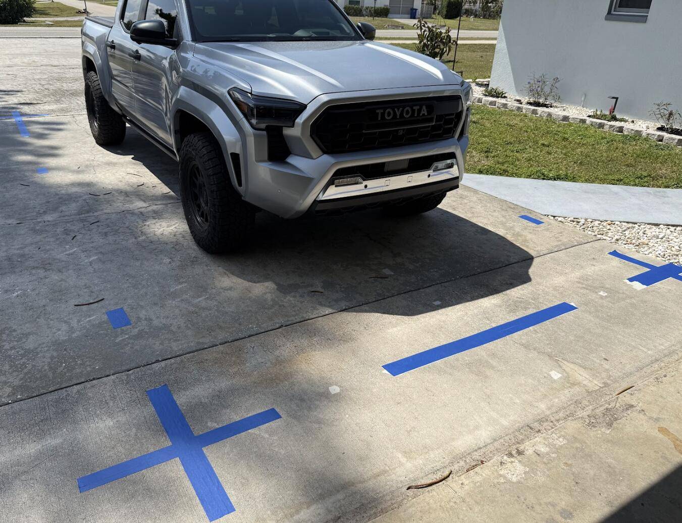

If you are looking to do a full recalibration of all the cameras, I have attached the official Camera Calibration Procedure from the Service Manual that I found shared online. This procedure is very in depth, and honestly probably not recommend if you are only swapping your front grill camera (I believe other forum members were able to change their front camera calibration to +162 or +165 to get it adjusted correctly) With my tailgate camera also being misaligned from the factory, I performed this calibration to get everything dialed in. It did take some time, especially settings up all the tape.​

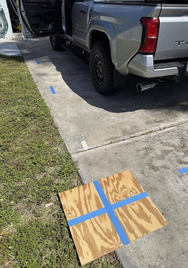

The official calibration procedure of laying tape down in precise locations was time consuming and very tedious to get all the tape lined up perfectly. Honestly, I think if you just take a 2ft x 2ft piece of wood or cardboard, put some painters tape on it, and move it around to each corner of your truck where your cameras 'mesh' together in the view, it will work almost as good. I've saw someone else mentioned they just went to a parking lot and used the painted lines.​
2025 2026 4runner 6th gen 360 Camera calibration / recalibration how-to instructions DIY 29419-00799f081414c09a202fa8573f2e9462
Tape laid out per the Service Manual Procedure​
This was as close as perfect as I could get it. It's not perfect, but I was happy with the results. Much better than how it came from factory. The adjustment values in this picture are not accurate, as each time you save, the value returns to zero.​
2025 2026 4runner 6th gen 360 Camera calibration / recalibration how-to instructions DIY 29417-26fd487f28a2d89dfc8301162e0d49c9
Using wood instead to save time.​
2025 2026 4runner 6th gen 360 Camera calibration / recalibration how-to instructions DIY IMG_0911

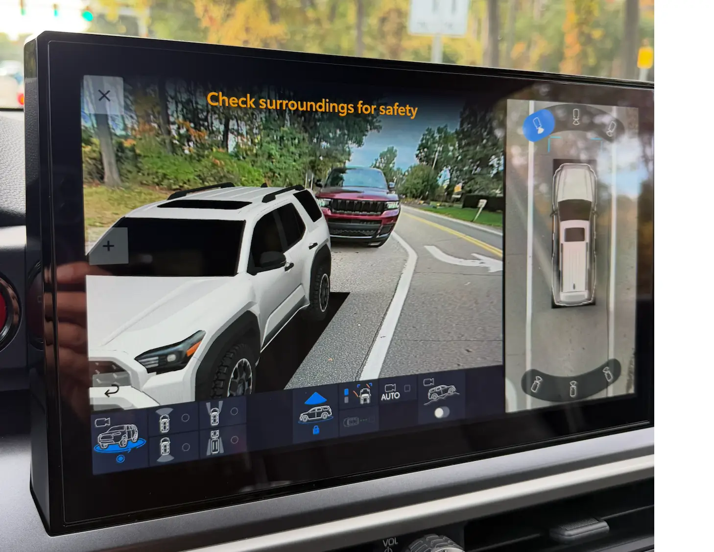

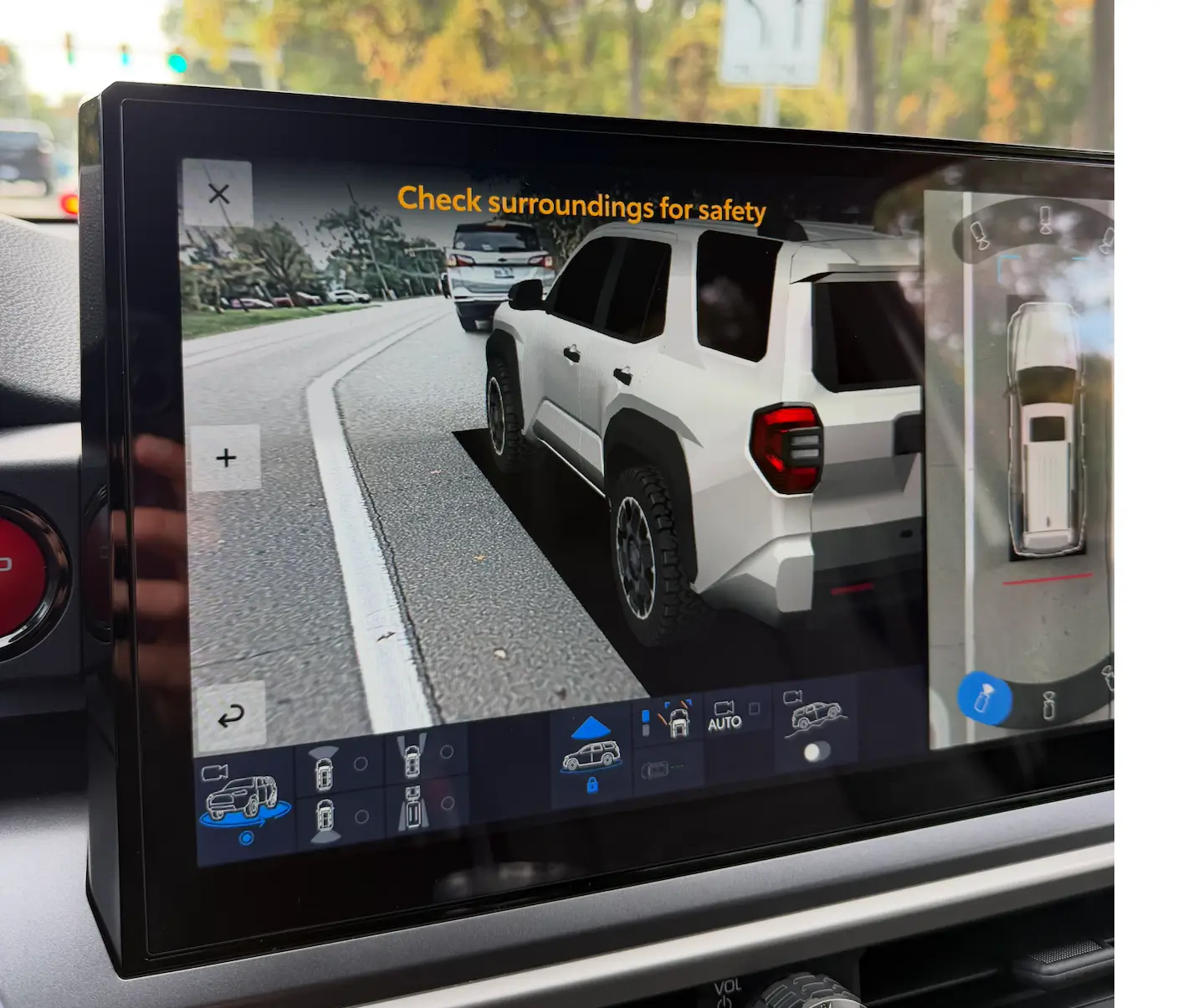

Is there also a procedure to adjust/calibrate the 3D picture somehow? Background is I was rear-ended and they had to replace the tailgate and also performed a camera calibration. The top view looks perfect but this 'funky' 3D picture looks a bit off. I assume it's something related to the front camera. I attached a few pictures. Not a big deal but would be nice to be able to change it myself vs. going back to the shop.
2025 2026 4runner 6th gen 360 Camera calibration / recalibration how-to instructions DIY Screenshot 2026-10-14 at 6.02.21 PM
2025 2026 4runner 6th gen 360 Camera calibration / recalibration how-to instructions DIY Screenshot 2026-10-14 at 6.02.17 PM
