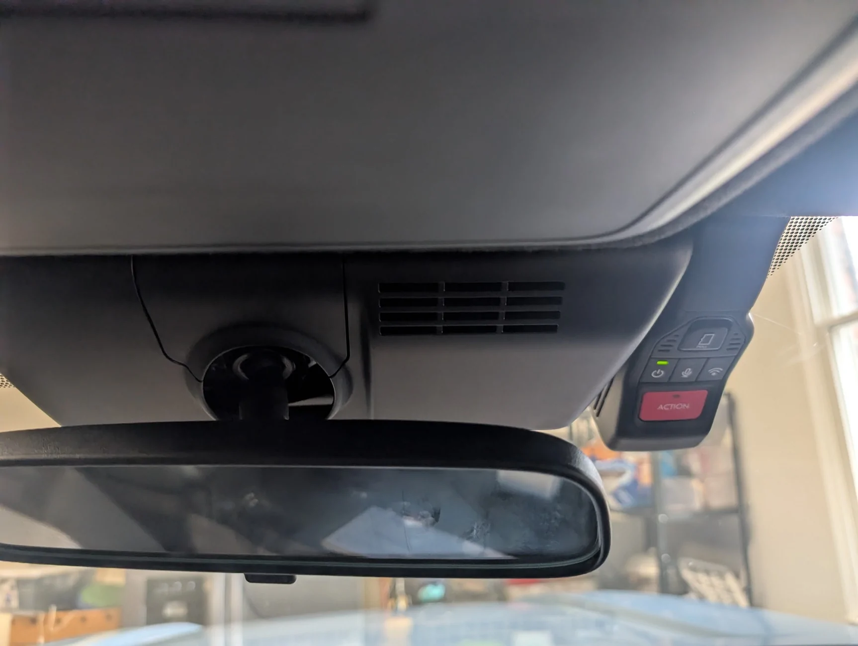

I got an OEM dash cam (PT949-34222) new no box from eBay for $215 and just finished installing it. A few notes from my experience:
Camera length adjustment: You can actually shorten the camera a bit by opening the cover and setting the height to the lowest position. I think Toyota designed it this way so the same unit can fit different SUV models.
Mounting position: I installed mine on the passenger side. The cable is long enough to reach, and this placement keeps it out of my line of sight while still allowing me to press the buttons from the driver’s side if needed.
Removing the map light console: This was the toughest part. At first, I was afraid I’d break something and spent a lot of time being too gentle. Later, I found out that besides the bezel, there’s really nothing fragile — the console is held by four solid clips that don’t break easily. Once I knew that, I went back, pushed my fingers all the way in and pulled it down with confidence, and it popped right out in two seconds. Nothing broke!
Thanks for all the help!!

I just installed the Integrated Toyota Dashcam and thought I'd share some info on the install that might be useful to others.

The rest of the physical installation was pretty straightforward from the instructions. Here's what it looks like installed:
If you watch it long enough from the front of the vehicle, you'll see it's little red LED security light flash occasionally. But this can be disabled in the app.
