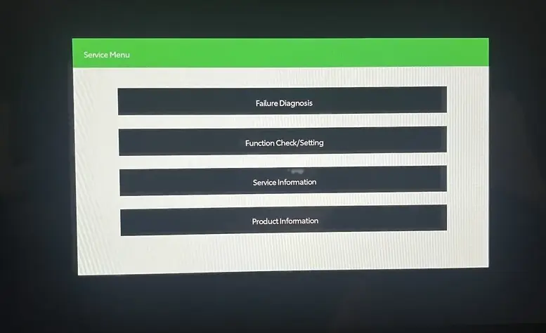

I was able to access the service menu on my TRD ORP Hybrid using the following method:
1.) Turn ignition to "on" (but engine is off)
2.) Set Power/Volume control to "off"
3.) Go to Settings -> Display and turn the Display "off"
4.) On the now blank screen "Swipe Left to Right" 5 times, then "Swipe Right to Left" 5 times.
Not as cool as "Engineering Mode" on my Kia Seltos, but may be somewhat useful. Share what you discover! :)
2025 2026 4runner 6th gen Service Menu Access Unlock Procedure (How-to Instructions) 23010-4a0fd55ce776f5ba0902463e898e88e6

I wonder if you can put the parking brake into service mode from that screen? It would be helpful when it comes time to do rear brakes. Otherwise you'll need an OBDII scanner to retract the parking brake motors

Looks like you can turn off camera recording there?
