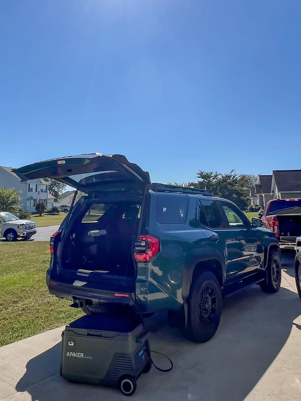

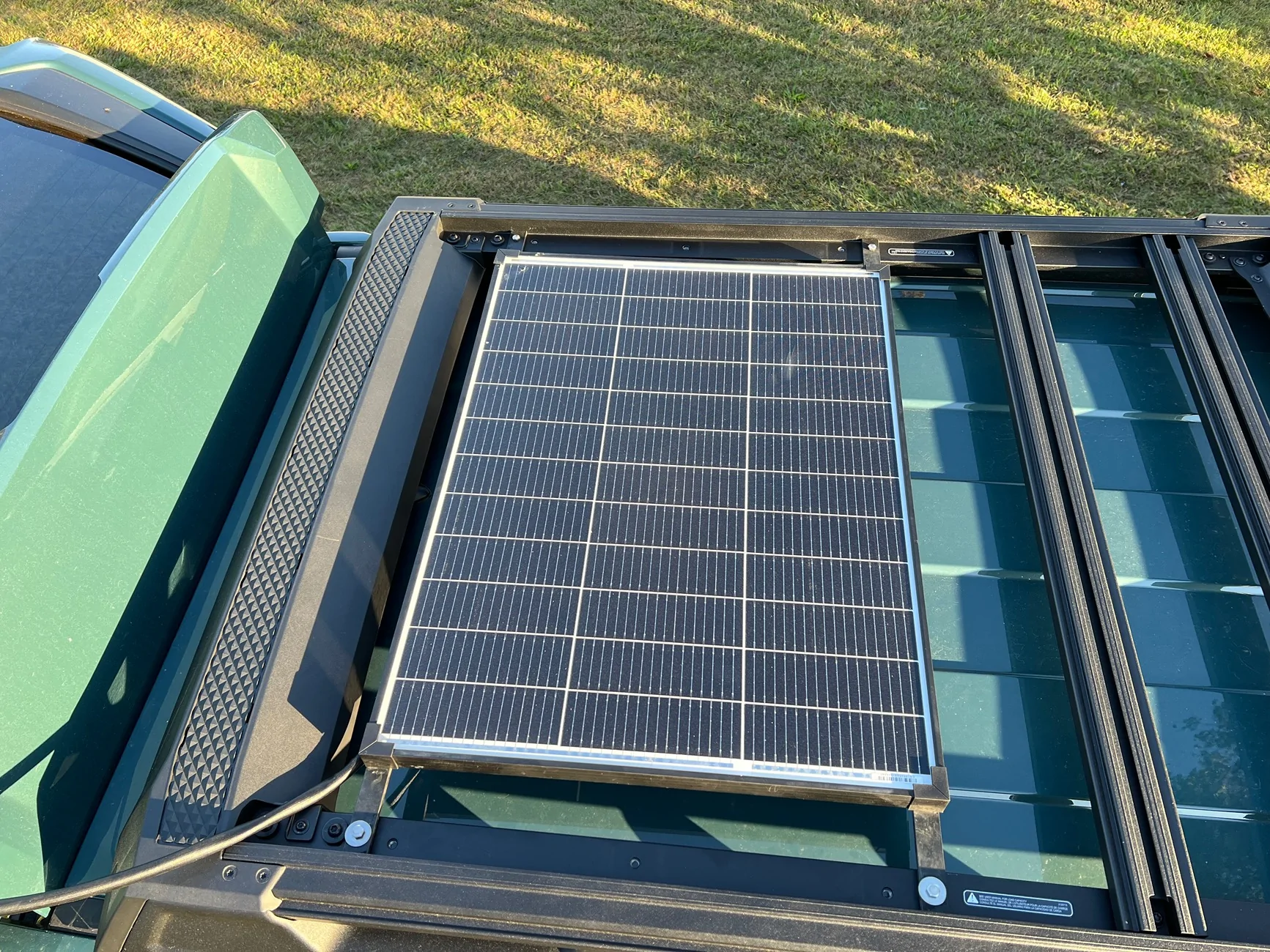

I put a solar panel on the roof rack. It'll power my cooler on long weekends.

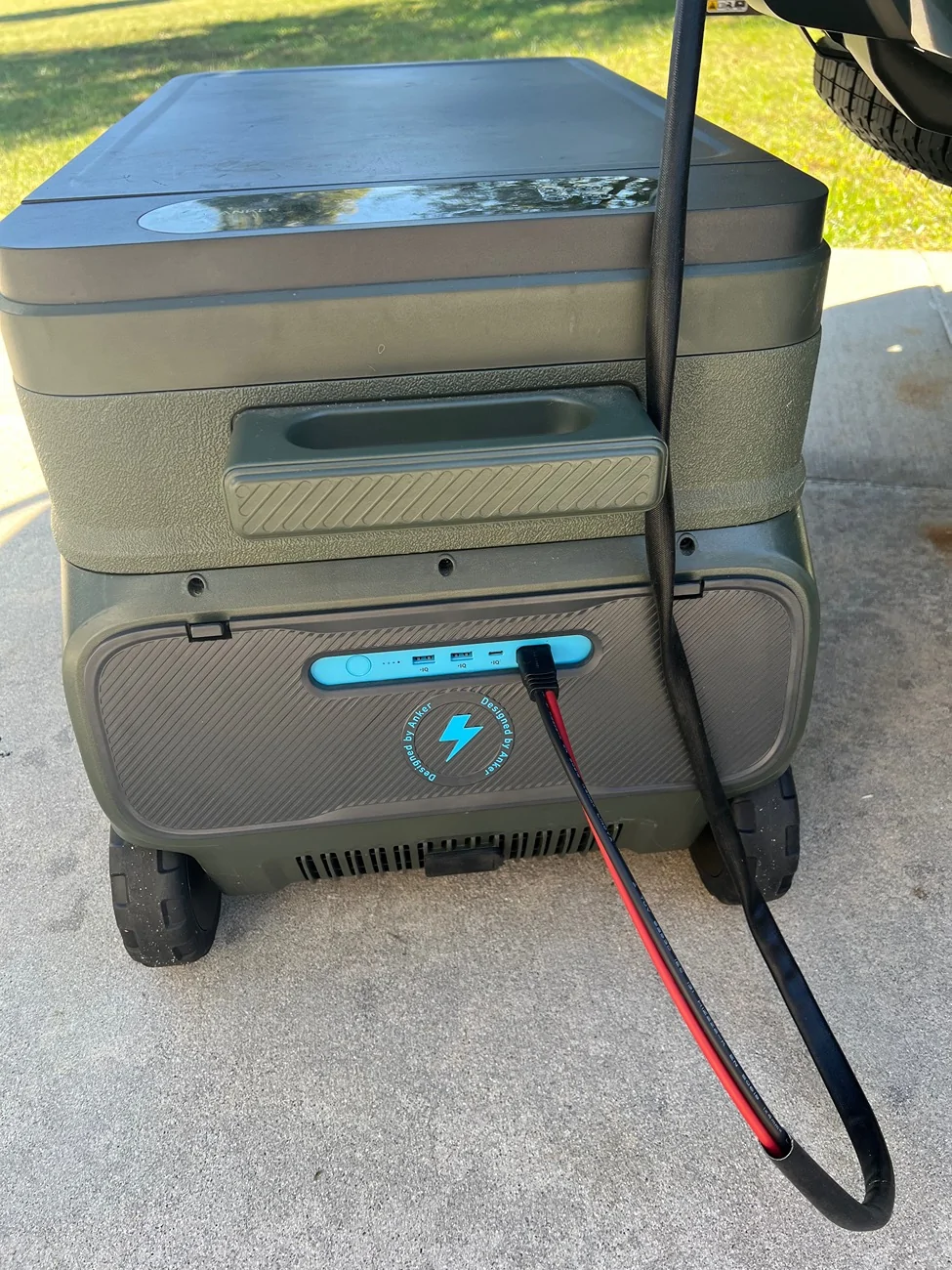

It's only a 100w panel, but has 16 bus bars to hopefully overcome some slight shading from time to time. I used 12"x1"x1/4" aluminum bars for supports - each bar has two stainless bolts w/lock nuts holding it to the panel and then another similar hardware mount where it ties to the roof rack. I have 1" diameter rubber bushings between the aluminum bars and the panel as well as the aluminum bars and the roof rack. I know it should be grounded, but I opted for this right not to make sure there aren't any vibration issues. The panel has a 10' pigtail that has solar connectors on the top end and an XT60 plug at the bottom end. My Anker 40L v1 cooler has an XT60 input on the battery designed specifically for solar charging and I wanted to take advantage of that. I do have a 2048wh Anker solar generator that also could be charged by the panel, but this setup will be used 99/100 times for the cooler on beach weekends or trips to the cabin. I had to pull two of the roof rack cross bars for the panel to fit but honestly we don't expect to store items up there.
I used Alumablack to tint the aluminum bars black, but this morning they had lightened considerably. Not sure if that is due to the dew on them this morning or if they require a second treatment...but I was a little bummed.

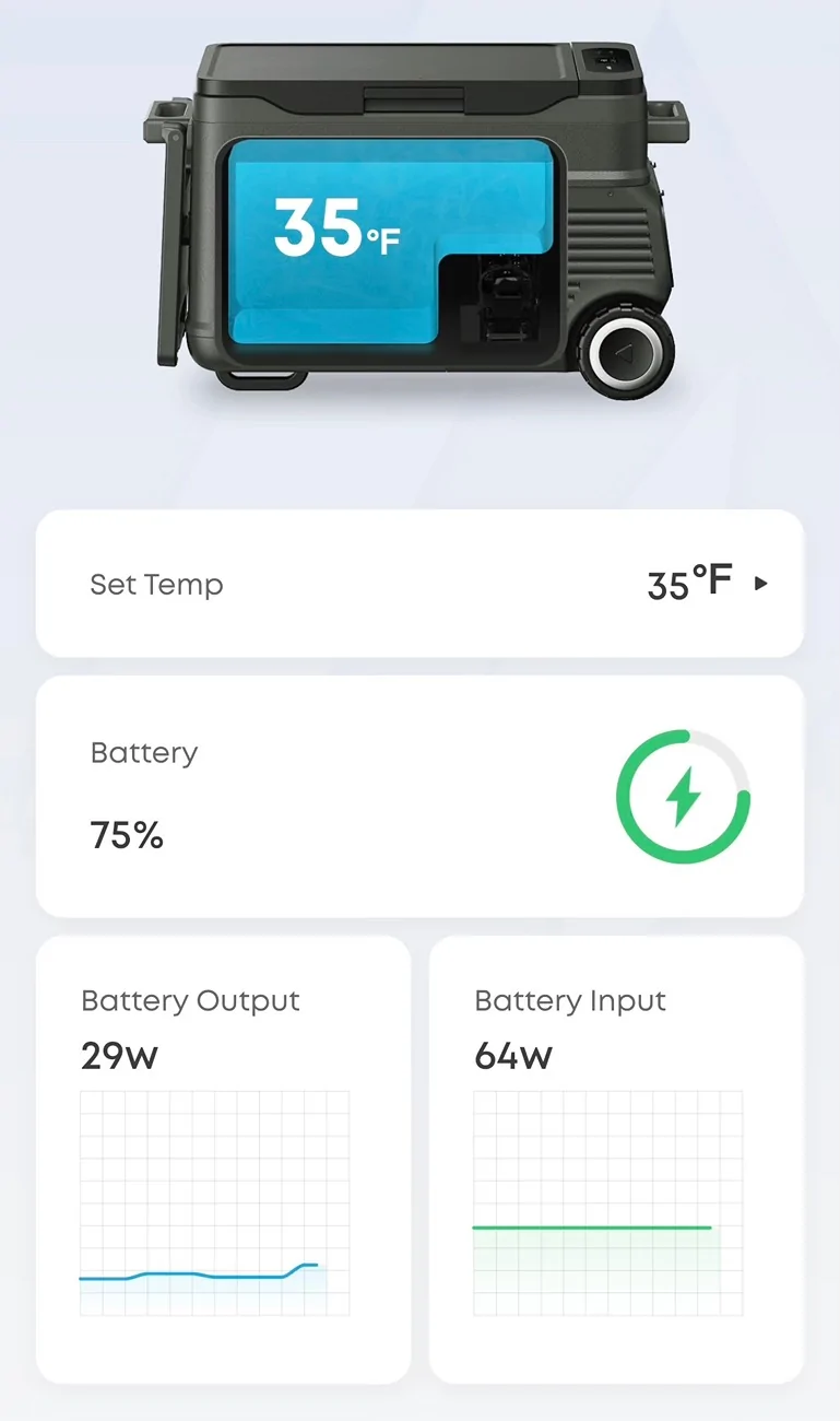

Tested it out by tossing a room-temperature 30 of Miller Lite in the cooler and set the temp 35 degrees. I figure that'll put a strong demand on the battery. Parked the 4Runner in the sun and plugged the pigtail in - success! The panel is inputting more than double of the draw on the battery from the cooler. I call that a win. Should make it easier on the cooler to live in the back of the 4Runner on long weekends and when on road trips.

We tend to spend many of our summer weekends out on the beach surf fishing. This means the 4Runner will be parked from shortly after sunrise to just after sunset without being started or running at all. This often will happen for two days in a row and occasionally we camp at the park and then in those instances we will be on the beach many days in a row. When these instances happen, I want a solution that can keep the cooler fully charge while having minimal impact on the vehicle. I don't want to start the vehicle, I don't want to trickle off the hybrid battery, and I don't want to have to keep recharging the cooler each night. The cooler's built in battery can easily handle 24 hours of cooling, but when we are in/out of the cooler all day on a hot beach that 24 hour length of battery life gets impacted. Having a solar panel that inputs more than double of what cooler draws is hugely beneficial...and I literally no longer have to even think about it. Toss the cooler in the back, plug it in, and I'm set until we are back home.

Update: We put the cooler in the back and plugged it into the solar panel about a 3 weeks ago. Kept it in there through a weekend of camping where it got lots of open/close for drinks and two weeks of my wife on jury duty and she kept her lunch and cold water in there too. Finally pulled it out yesterday after we visited the beach the day before and it was still sitting at 100%, so seems like the panel is sized right for the cooler. I'm calling it a win.

How did you run the wire into the vehicle? or do you just use a window
quadna71
quadna71
Sep 11, 2025
164
143
Delaware
2025 4runner
Wrapped it in a UV sleeve and just slipped it between the hatch and roof seal. Crushes down nicely and haven’t had a leak yet.
I didn’t want to over complicate things by drilling holes.
