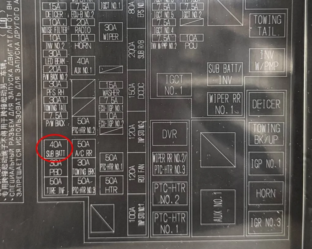

What I was saying is that the reading of how much current the Victron is allowing to be pulled by the battery it is charging is unrelated to how much current the Victron is drawing from the 4Runner's internal inverter which is expected to supply 4400 watts (20 amps at 12 volts). I am not sure if Victron or other devices can scale back on current pull, which is why there are always fuses that will just end the pull instead of scaling them back. My REDARC limits the device by voltage, and if the voltage of its source drops below a certain amount (12.7 v) it stops drawing anything, and it does balance the pulled power at both ends, and its maximum is 375 watts (pulled and delivered).
I too am still in search of the draw current limit on that DC-DC converter. Google keeps bringing me to this thread.
Generally, chargers are designed for 10 to 20% of the Ah of the battery they are charging. So, for the 70 Ah, a suitable charger should provide between 7 to 14 amps. That is not to say that Japan would design a circuit with that kind of logic.
You may have seen this thread already. There is a 40-amp fuse by the name of SUP BATT. I think this is the circuit that charges the rear battery. It is easy to check if this fuse is in line between the DC-DC converter and the startup battery.
I have an experiment in mind that entails checking if the SUP BATT fuse belongs to that line. And then I intend to check current drawn in Accessory mode and then in Ready mode.
2025 4runner 6th gen Things to know on the hybrid 2400w power output and dc to dc system Fuse Box Cover SUB BATT
the victron dc to dc will scale back also if that's what you are asking. also there is a 200amp sub r/b fuse also in the middle of the diagram.
